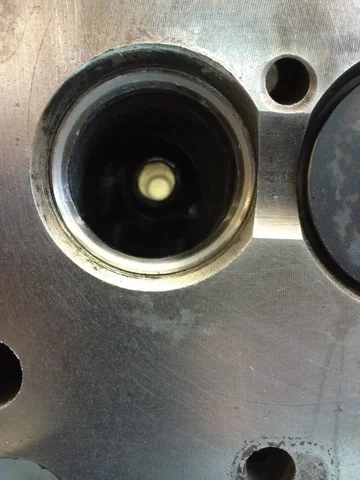

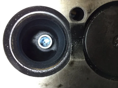

There may be a lot to be gained from cleaning up the shrouding under the valves. There is a lot of material to be removed there.
IMG_5253.webp cleaned up (lots of material removed from the port and under the valve.
IMG_5188.webp original casting before clean up
