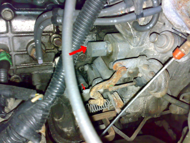

When you look at the pump where the throttle cable goes to the pulley you can see a 10mm nut with a screw type shaft that's to adjust the high speed idle for air con, cold starts etc don't touch this screw. On the other end of the same bracket on the engine side there is a second screw with another 10mm bolt it's the one for the idle. After my rebuild the idle jumped from 650 to 1000 rpm so I backed this screw anti clock wise bringing the idle down to 700 rpm. Like the photo above but in the photo the first screw is very rusty and hard to see.
Not wanting to highjack this thread, but I have a question about the cold-start vacuum switch mounted on the oil-cooler as seen on HoJo61's picture. this is the switch on the left of the top red arrow.
Does anyone know where to source these? I spent quit some time finding it, no luck so far... Mine is broken, and I now switch the idle-up with the pre-start heating relays.
