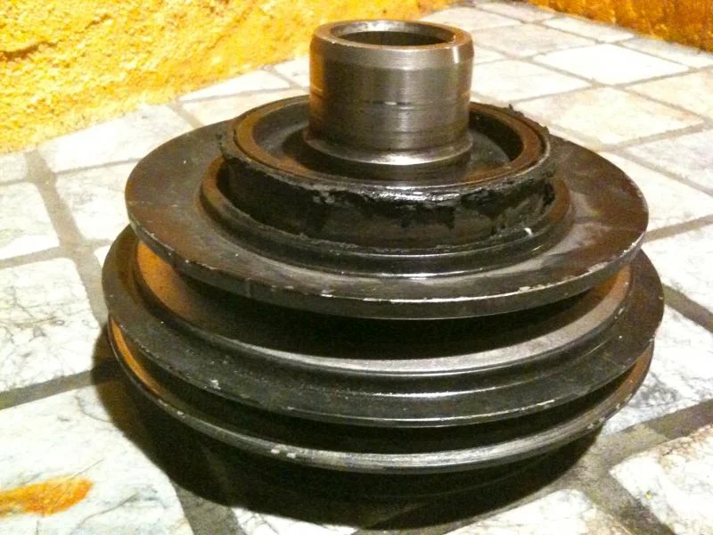

has anybody had an experience with camshaft pulley coming loose? my engine was rebuild 7,000 mile ago it is possible that it was not torque down. but if it was torque down what would cause the nut on the camshaft pulley to come loose.
i am hoping to leave tomm for a trip to Baja California, my plan is to put loc tight on the bolt and tighten it down, since i am going on this long trip i want to make sure it does not come loose again. is there any thing else i should do. i do not have a puller to pull the pulley all the way out to inspect it, but i could maybe locate one if necessary. thank:bang:

thanks everyone, it was the harmonic balancer coming apart on the camshaft pulley. thankfully Spector off road had one so we are on out way to Baja Californian leaving at 5am. Specter say he has not seen one come apart like this. has any one have experience with this. here is a picture of the camshaft pulley. if i am able to post on expedition portal i will post the link here to share with you our trip.:clap:
That rebuilder probably had to use an oxy-torch to loosen the CRANKSHAFT pulley bolt after some dude had previously applied red loctite to its threads (cooking/destroying the rubber in the harmonic balancer in the process).

I had this happen just after rebuilding a 22re. The kit I used had plastic time chain guides, after a few weeks one of the bolts backed and I took the front apart again. That's when I noticed the harmonic balancer. Mine didn't looked that bad but the rubber was separating and my timing marks had rotated.
Had a machinists teacher of mine warn us that it can happen with age and when it happened on my truck I was still a bit surprised.
