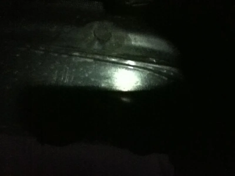

Bad pic taken at night, but you can see the dent/crack/puncture. I smothered some "Wet Weld" on it and after it set, covered that with regular JB Weld. We'll see how it holds up.
