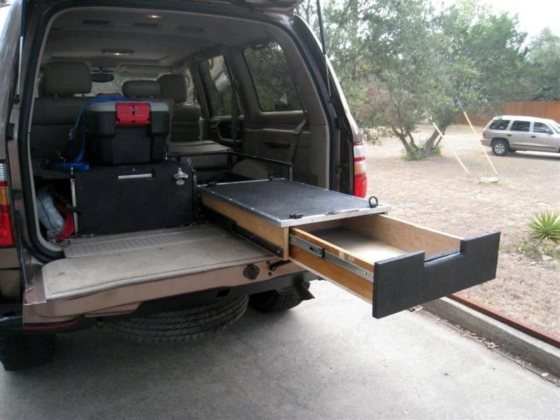

I thought I'd start a build thread on my storage system. One half will be a permanently mounted fridge/cargo slide with 500# slides and the other sections will be modular bolt on areas. Everything is mounted to a light tube subframe.

Thanks guys. I'm redoing the fridge slide to be more modular and to also give me a flat deck, per Yooper's suggestion. I have the box welded up and now have to mount the slides.

Here is how the storage system looks so far. I added the capability of putting a flat deck on the fridge slide side and also mounted a drawer under the fridge slide. I still need to figure out what latches to use.
It seems like thats what everyone with AO drawers desires, so I say try and make it happen. If you do it mounted to the fridge slide system, when you slide the fridge out to get something you wont have to clear the table off, it will just come out also. Just a thought.
