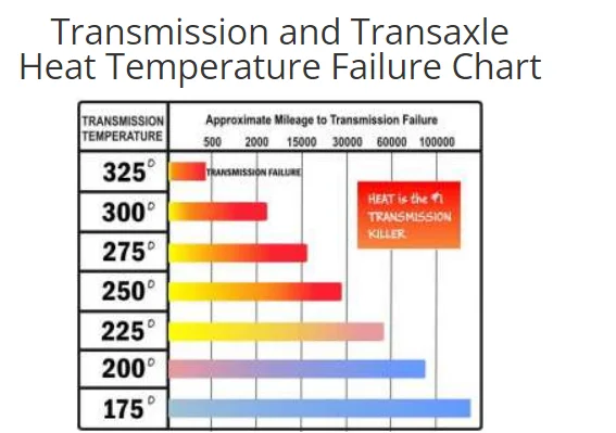

I had an ongoing problem with failing pumps and fluid becoming dark. A new OEM pump would last approximately 6 months before developing a whine. It turned out that lack of circulation was causing the pump to heat up and burn fluid. The pump would become so hot that it caused a 2nd degree burn when I touched it. Finally, the hot fluid melted the plastic reservoir. Something was going wrong in the rack that was obstructing fluid circulation. It took replacing the rack, reservoir, and pump to resolve the problem. I bought an infrared thermometer to pump temperatures when I go off-road. Soi far, fluid temps have not exceeded ~172 degrees Fahrenheit.
I wish I had bought an IR thermometer and monitored temps 18 months before replacing 3 pumps along the way. Here's the thermometer that I bought to keep an eye on the fluid temps. This is a transmission fluid temp chart. for reference.
