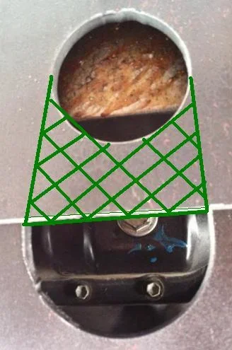

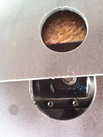

Well, I'd like to thank Mike for the group buy, a great deal on his skids.
Picked mine up, primed and rattle canned them and finally installed then this morning. Easy as pie.
No problems with the MT sliders
However, I found a small chink in the armor, no pun intended:grinpimp:
The oil drain does not match up with the hole on the front skid. I have maybe a 1/4" more that I could slide the front plate back, but it won't be enough to line up the hole with the oil drain.
Easy fix, I'll probably just cut the front skid like the center pan with a "u" shaped notch in the end:meh:
That may be something BIOR may want to incorporate in their design.

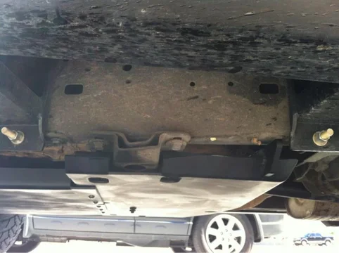

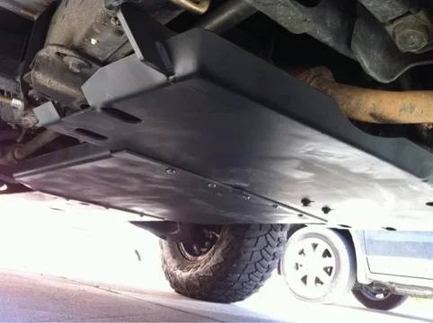

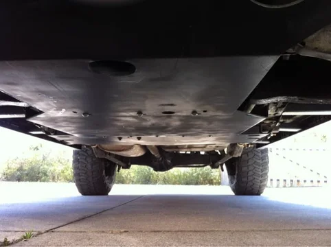

Can someone post a picture of the whole system from underneath (maybe while on a lift). I'd like to see it's coverage and design as compared to Slee's system pictured clearly on their website.
Slee - Skidplates
I think I like the BIOR better so far (definitely the price), but would like to see it better. Since I'm in CO, I guess I could always drive to his shop.
Thanks.
Coverage is very similar, the BIOR flare out a little more on the center plate behind the torsion bar mounts, I think Slee covers a few more inches further back on the cross member pan. Big difference is you keep your existing crossmember with the BIOR, Slee you replace it with their plate.
Best I can do with no lift and crappy cel phone camera:)
Sent from my iPhone using IH8MUD
Thanks, phrogg4evr (sheesh, that's a mouthful!)
Those pictures really help. I understand the drainage, access and weight benefits of the holes in the Slee plates, but something about that flat smooth steel, I like.
It does look like it hangs low with the cross member in place, but Slee's is also built down at the belly plate. I wonder what the difference between the two is.
NOTE: if there is another page for "chat" about the BIOR bumper, please direct me and I won't clog the group buy post-party install photos. Thanks.
It's hard to tell by the pics but I can't tell how the BIOR skid connects to the LC at various spots. I know Slee has 3 or 4 bolts on each side of the belly plate.
5C,
It is only a hair lower than the factory cross member sticks down in the middle, it sits almost flush to the cross member. In fact you use the 3 bolts for the worthless little factory T-case skid to bolt the rear skid to the cross member.
JB,
The BIOR rear/cross member plate uses the two inner bolts on each side from the factory cross member. So, you have four bolts holding it on which are down inside the skid plate, so they won't get dinged up if you drag across a rock.
The front uses 5-7 bolts, depending on if, and which diff drop you have. The 5 bolts in the front are the same as the factory splash guard. The two in the rear will tie into the BIOR diff drop. or possibly the two rear splash guard holes bolt if you don't have a diff drop. Have to ask Mike in that one. I have the Slee diff drop, so no holes unless I drill and tap my own, which I'm considering:hhmm:
The center plate ties into the front and rear plates, and the overlap is set up so if you are sliding forward, none of the plates catch.
Good design, great price and works with the Metal Tech sliders I have without modification:meh:
Really surprised by that. Are you sure it isn't an install issue? I done have that with my BOIR skids.
