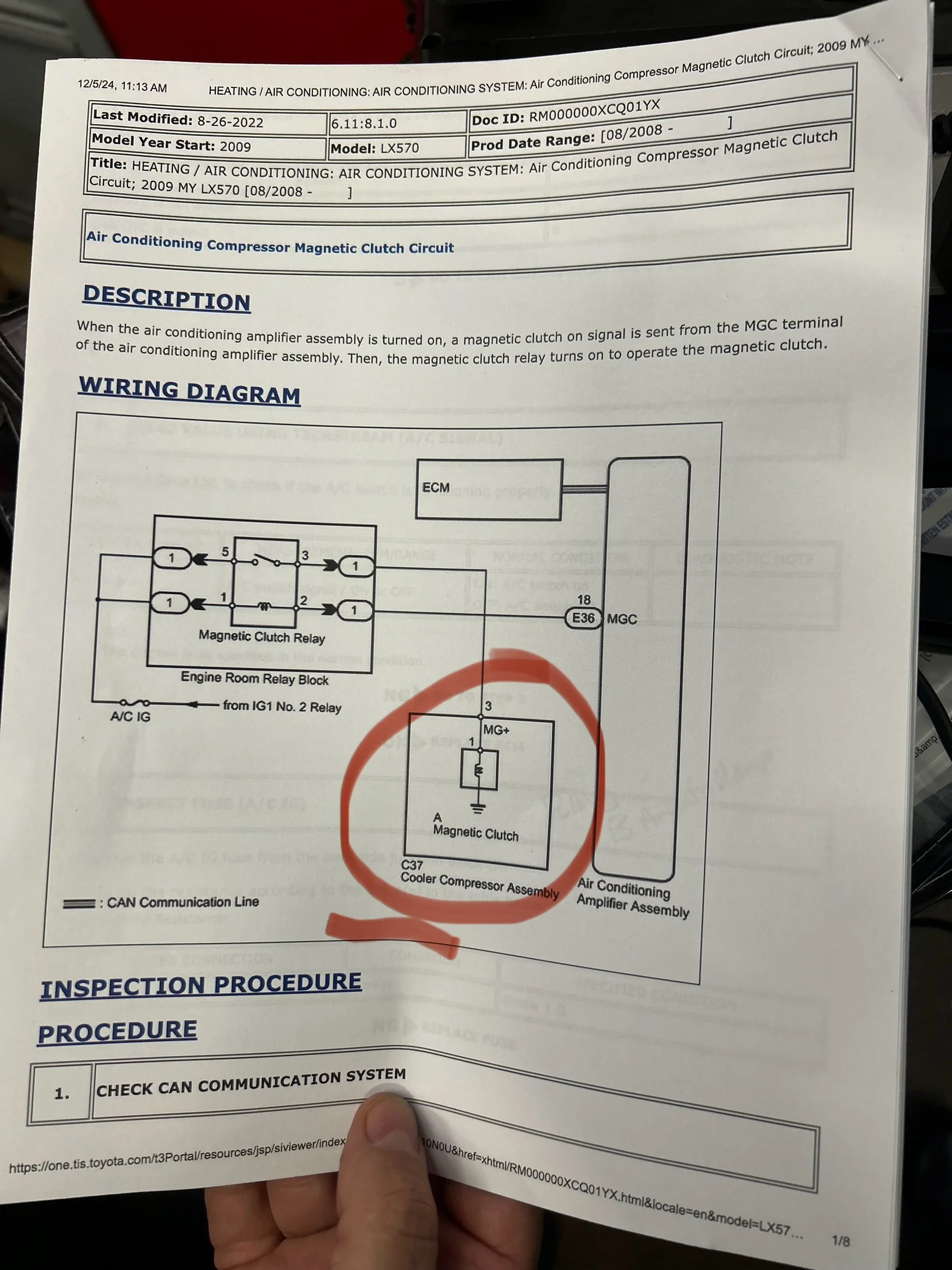

Update…apparently the mechanic installed the magnetic clutch backwards.
Everything is under warranty and dealer is covering costs and being up front on the diagnostics. I am curious if there are potential issues up/down stream with this snafu.
I asked for the electrical schematics so I could see other wiring interfaces.
Thoughts?
