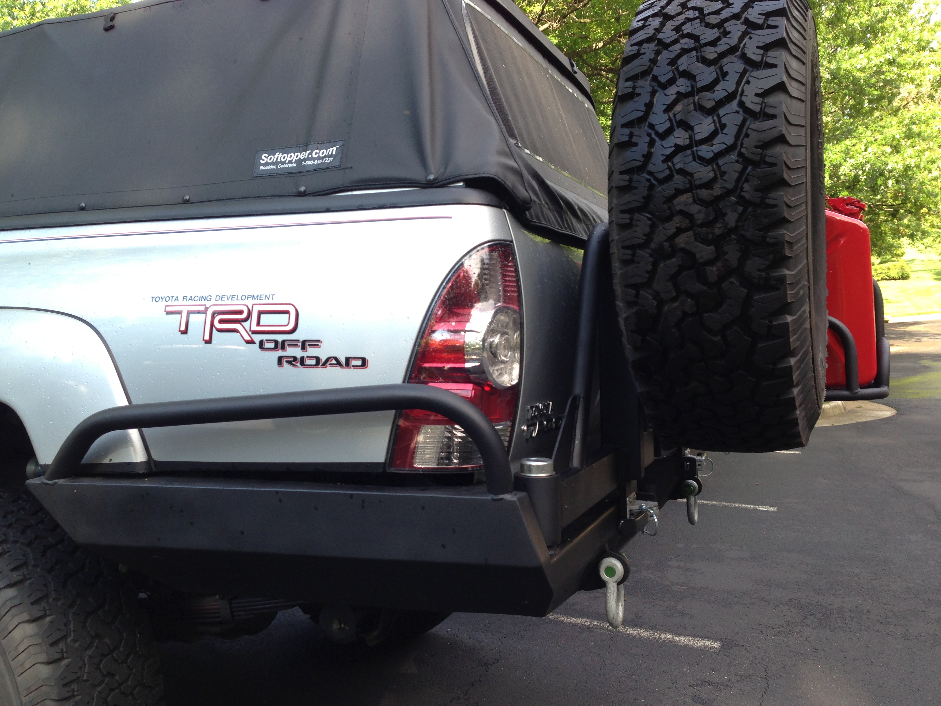

They are expensive. I had the heavy suspension (2886 Front Coils and Sport front struts) setup on the Tacoma and quite frankly despite the fact that I had more than adequate weight the ride was anything but good. Having come from a very heavy 80 series...I expected more from the OME suspension but, it just wasn't there. There rear Dakar leaf springs are great (I'm running a rear bumper with dual swing-outs) and kept them when I went with King. I decided on King after looking extensively at the Icon solutions and others. I went with Kings because they are highly reliable and you can purchase various "weight" springs. I originally went with their 600lb springs but, upgraded shortly thereafter to their 700lb springs. The ride is fantastic and in my opinion is better than a comparable Icon. I feel there is less body roll and the rebound is super. I like to minimize body roll when offroad - so, to me the Kings were the winner. They aren't cheap but, I go for the "buy once - cry once" routine. I have about 15k miles on my Kings and they are holding up great...no issues thus far. A mix of highway, city, and offroad.
- Mark
FN FJ -
- Mark
So you would recommend a 700# spring with the weight of the bumper and winch? Which is in my future, one piece at a time. Kevin
I'd recommend a 600lb spring if you're going to run a bumper and winch. I'd go 700lb if you're going to run dual batteries, winch, bumper, skids, sliders, etc. I never judge the weight solely on what's hanging off the front of the vehicle - I look at the overall weight and plan accordingly. All that weight in the middle (sliders, skids, etc.) is distributed to the rear and front and I basically account for what type of spring to run based on the overall weight. I usually build heavier "overland" style vehicles with all the goodies - so, they end up being heavy. I'll see what my truck weighs - maybe get it on a scale this weekend and report back.
I can tell you my Land Cruiser was 6,700lbs. But, it was probably one of the heaviest builds out there - African Outback drawers (fully loaded), Milford Half Barrier, Power Tank, ARB Fridge, Dual Swing-out Rear Bumper, Rear Ladder, 35's, INTI Roof Rack, Aux Fuel Tank, Sliders, IPOR Skids, Warn M12000, ARB Bumper, Snorkel, Super Charger, Dual Batteries, Water Tank, etc.
My bet would be that my Tacoma is pushing 5,000lbs. But, it may be a little lighter than that.

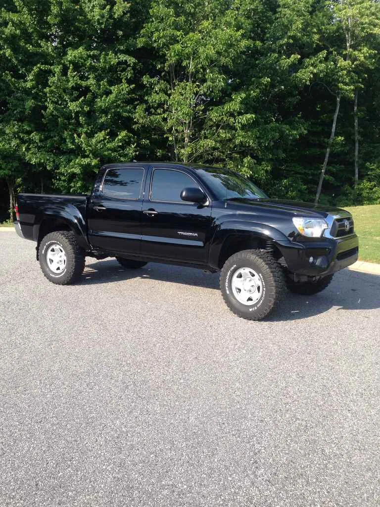

I decided to go with bilstein 5100's and eibach coils in the front and add a leaf in the rear. I'm very pleased so far.
