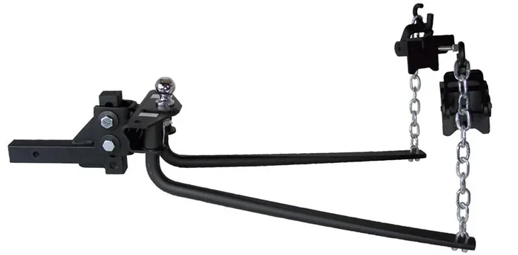

Wow! is that how those trailers are made or is that frame stretched for that deck? That trailer looks like it is designed with way too much tongue weight especially if you put some toys on that deck. I would look into some kind of load leveler hitch for that trailer no matter what you tow it with.

is that the only vehicle you are ever going to tow it with? a weight distribution hitch could be used on any vehicle you or anyone else tows that trailer with. air bags do nothing to reduce the tongue weight which appears to me to be too high for proper balance. if the tongue weight turns out to be around 10% of the total weight of the trailer then air bags would work fine.

No need to upgrade the springs on a vehicle that will not be carrying lots of weight at the time like a built "expo" vehicle would. Also, you don't particularly need high clearance as that trailer is clearly not meant for too much off-road travel. Just pickup a weight distribution hitch and be happy you did.
