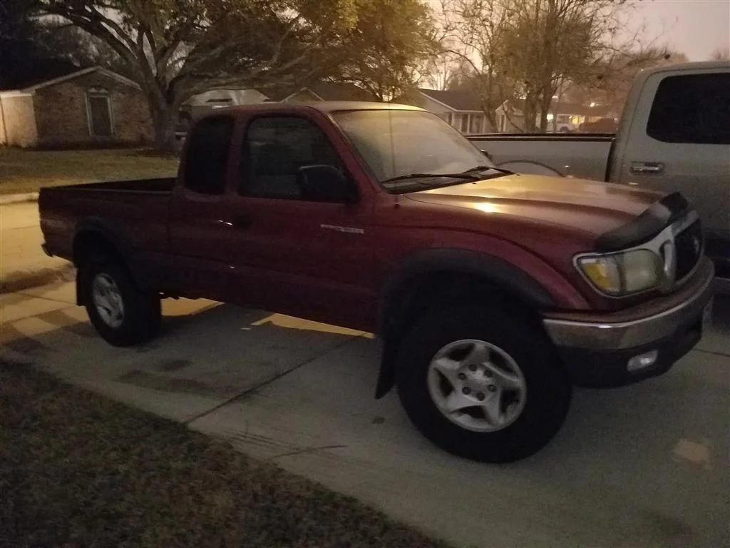

Hi all -
My 04 Tacoma w/TRD package is just turning over 195k. I bought it at 118k just over 6 years ago. Far as I can tell from the service records I can find (basically mine plus Carfax plus Toyota Owners site) the shocks, leaf springs, coils have never been replaced (currently has Bilsteins which I believe were part of the TRD pkg - or stock in any case). To me, it looks like the leaf springs are done - but I've seen plenty on the various forums that would indicate "flat" is their normal state. I've inspected and do not see any cracks or excessive rust.

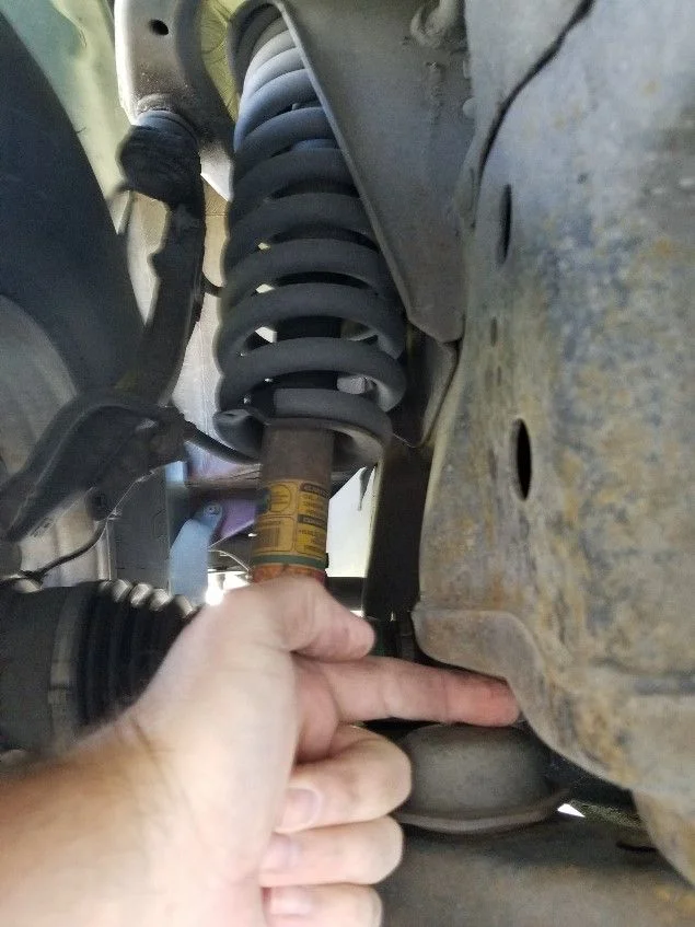

On the front end there's just about 1/2" - 3/4" space at the bump stop (same on both sides) which I would imagine there should surely be more space than that. Just can't seem to find anywhere that states what it is supposed to be. Assuming there is supposed to be more I believe that would indicate new coilovers are needed.
I'm thinking I need new leaf springs, new rear shocks and new coilovers up front but don't want to replace everything if things look like they are supposed to look. So I'm here asking anyone who might know what its supposed to be to offer their opinion (knowing full well what they say about opinions). Its a daily driver for my son going to school/work which rarely carries any load and even more rarely goes into 4WD (pretty much just to be tested and exercised). Pics are with no load - not even a driver. Appreciate any feedback.

Mine were less than a 1/2" on the front before new springs and shocks. Afterwards about 3/4 of an inch. Granted there was heavier springs, 120lbs bumper, and .5" lift involved.

Those springs are saggy... It's definitely ridding lower than when it was new. The rear looks like they are a bit negative. Ride quality and such would be better with new springs but unless something broke or you are bouncing on the stops, hauling loads or wheelin' it you're probably going to be fine with just new shocks all around.

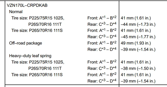

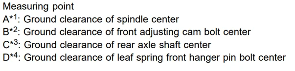

I think it is definitely lower than when it was new. Here's what I found for mine in the FSM. On the front, center of spindle should be 1.93" higher than center of adjusting cam bolt. On the rear, center of the forward leaf spring hanger bolt should be 1.54" higher than the axle shaft center. Finally! A target!
