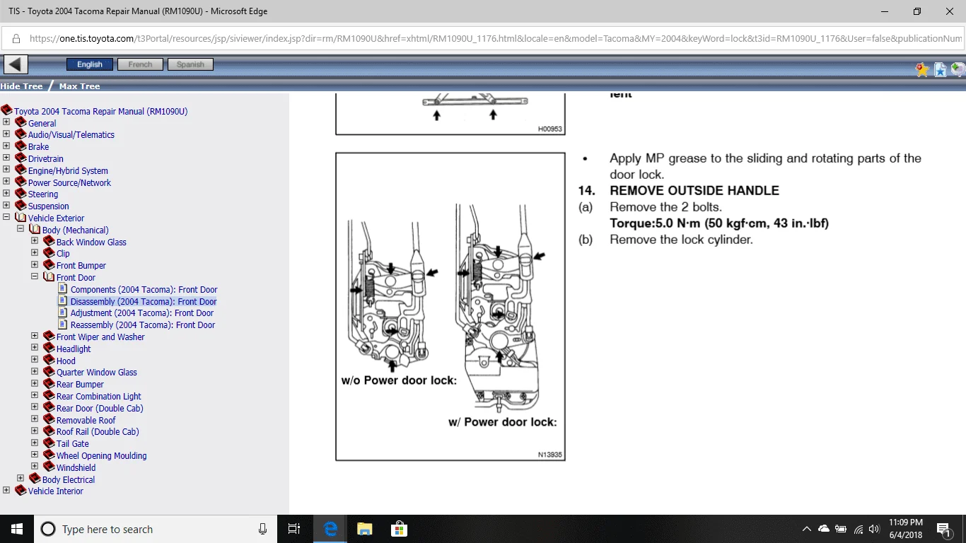

Recently the driver's door on my Tacoma was stuck shut, so after an online search, I determined that a broken spring in the lock mechanism was causing the problem. The good news is that I managed to open the door. The bad news is that I cannot figure out where the replacement spring fits. (The spring is tiny -- it's only 7/8" long.)
If anyone here has a FSM, could you take a picture of the door mechanism and post it? I tried to find a diagram online, but all of the links I clicked on were no longer active.
