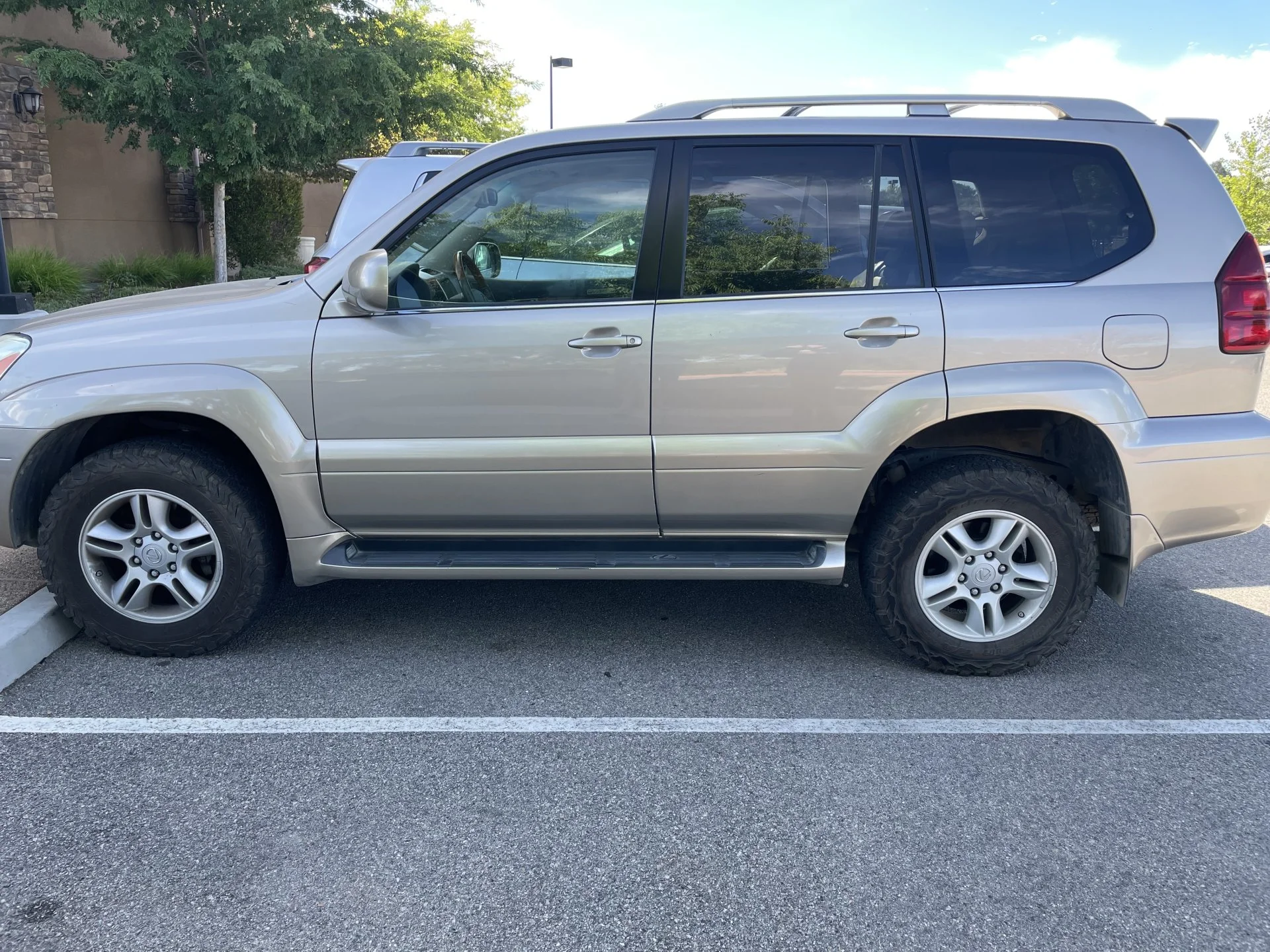

Here’s my ‘04 GX470. Bone stock with 90k orig miles. Just spent a fortune on timing belt, water pump and all the “while you’re in there’s”.
Suddenly, the ride is real harsh. Feeling every bump. Seems to be in the rear. But here’s the catch - the air suspension raises and lowers in the rear just fine. The front, however, does not move. No audible sounds of leaking or any other concerning noises while driving or parked.
Are my rear air bags bad or is it a regulator or something else? Perhaps a dumb question but are there air bags in the front, too?
Here are three parked pictures.
First pic - fully raised
Second pic - normal height
Third pic - fully lowered.
