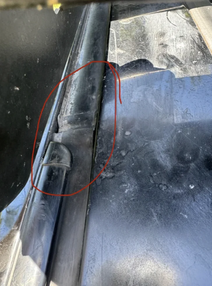

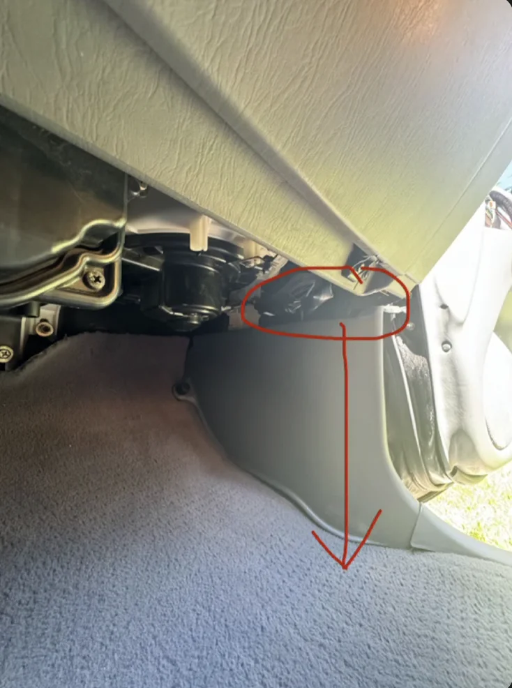

Recently made the jump into the LC community and subsequently this incredibly community. Ive read every thread I can find on the common leaks so if I need to post this elsewhere, just let me know. I have a dripping leak pictures below (interior pic) when water is applied at the rain gutter joint (also pictured below.) I have no leak when water is applied on the sunroof (recently cleaned those gutters thanks to you guys) and cannot see a drip when water is applied on the passenger windshield. I understand the windshield is a common weak spot. Water can easily enter at the circled rain gutter joint below but maybe this is intended? Do I need to silicone this joint or is this just an entrance to drain toward the windshield meaning the windshield is my my likely culprit? Thanks in advance

Have the same issue. Had my windshield replaced and re-sealed. Applied urethane along the side to seal up the rivet holes. Gorilla taped over it and over that whole area you're showing in your picture. Still leaks when it rains.. Good luck and please update thread if you succeed.
Bummer, thanks for the update. We'll get to the bottom of it
Inspect how the windshield trim is installed on each A pillar. Sun roof drains get blamed for these leaks when the majority of cases are incorrect windshield trim installs.
