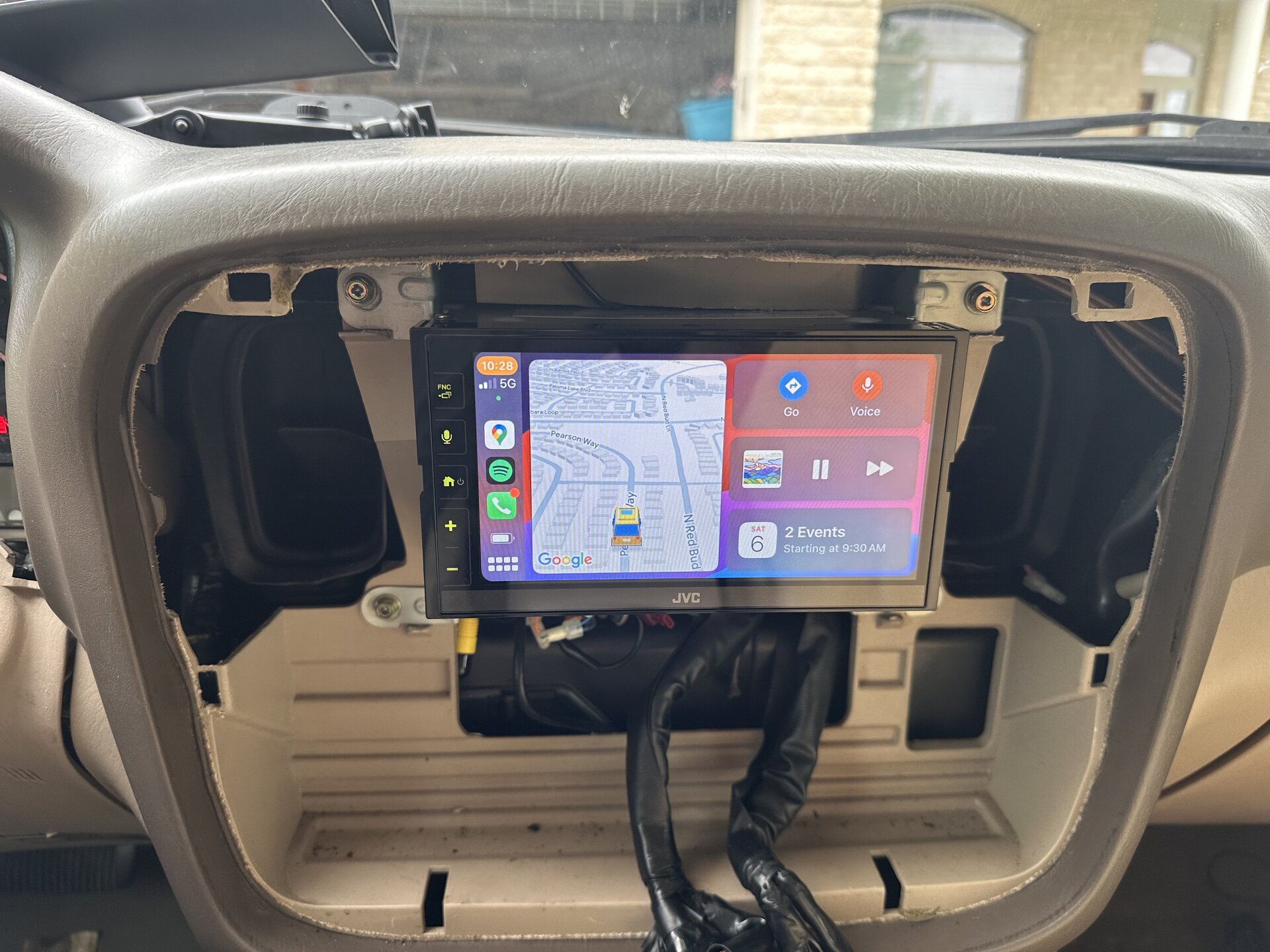

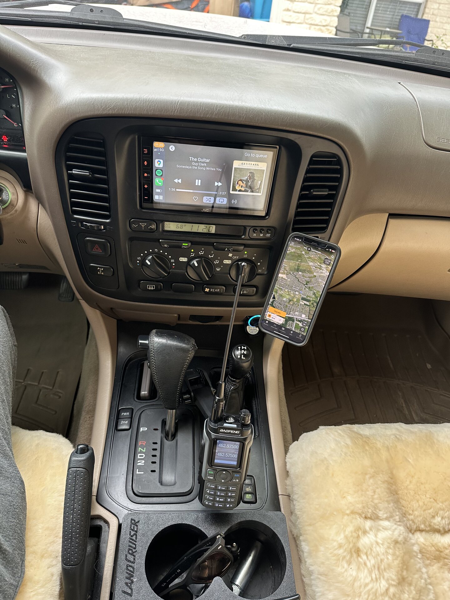

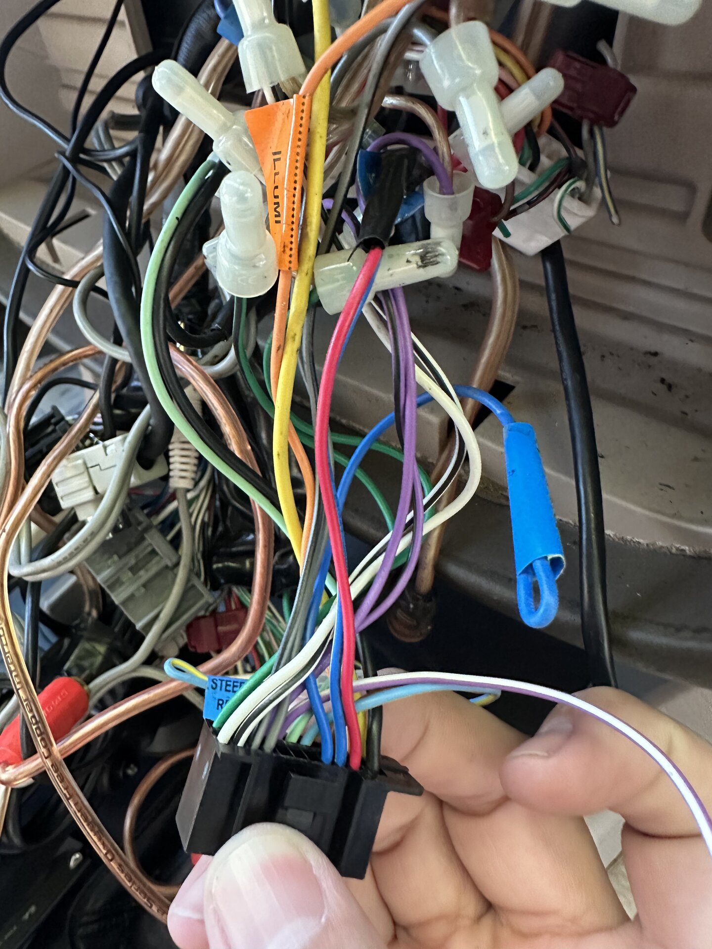

Stereo, quadlock, radio, shift bezel, and fixed the "D"

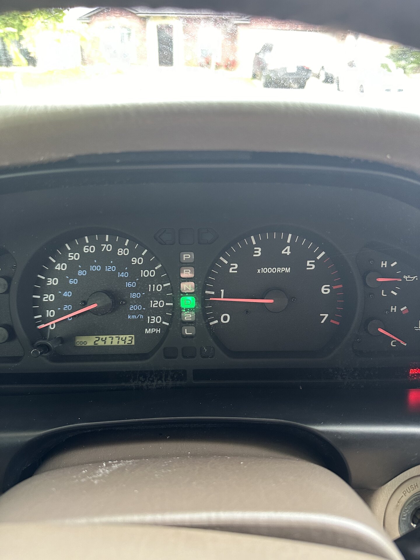

Shop (247843mi):
- Rear passenger axle seal
- Rear brake rotors and pads
- Rear diff fluid
Home (248025mi):
- Front diff fluid
- T case fluid
- Oil change
- Oil filter
- Third brake light replacement
Sending oil to Blackstone for analysis, curious for those results.

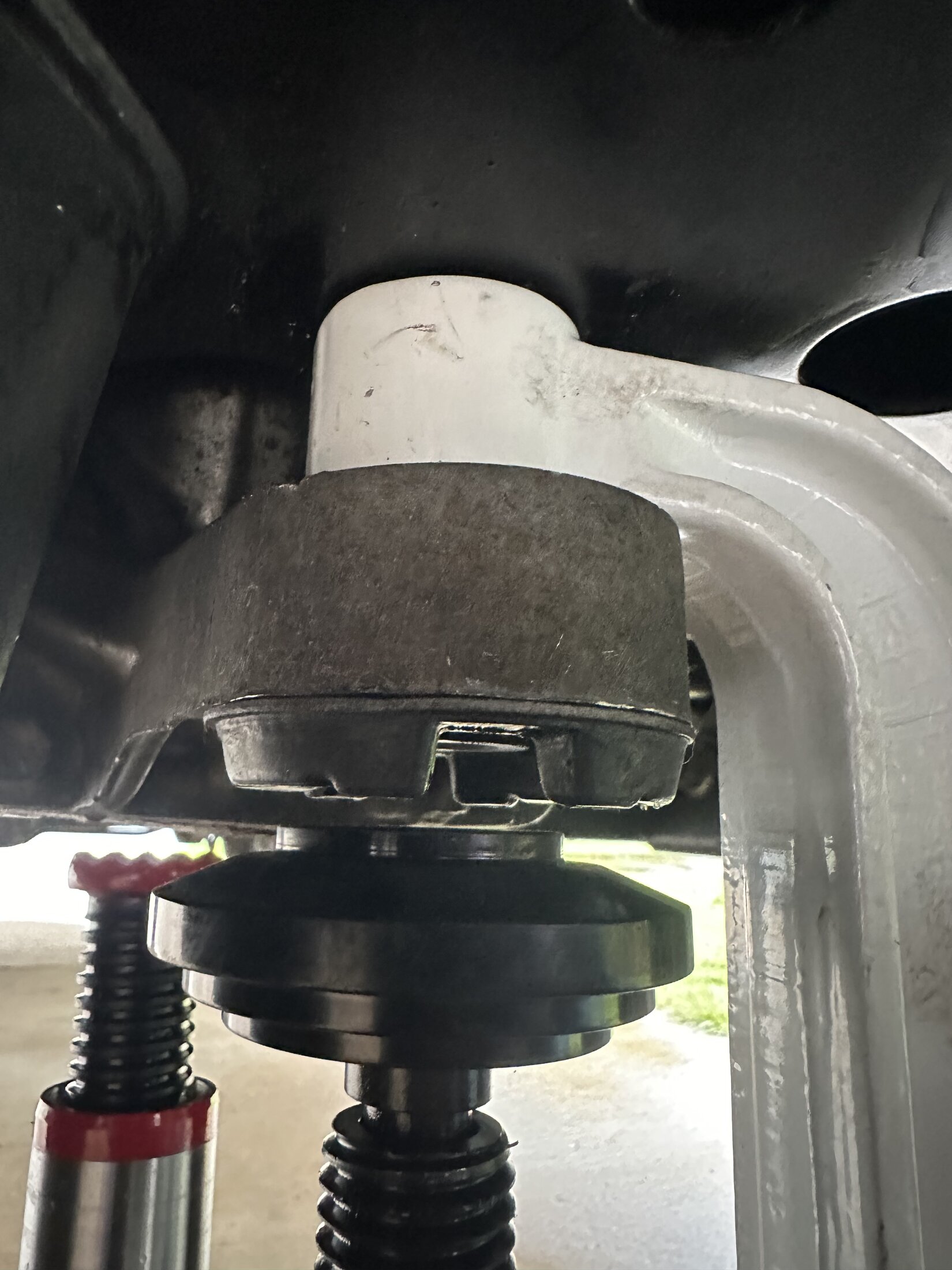

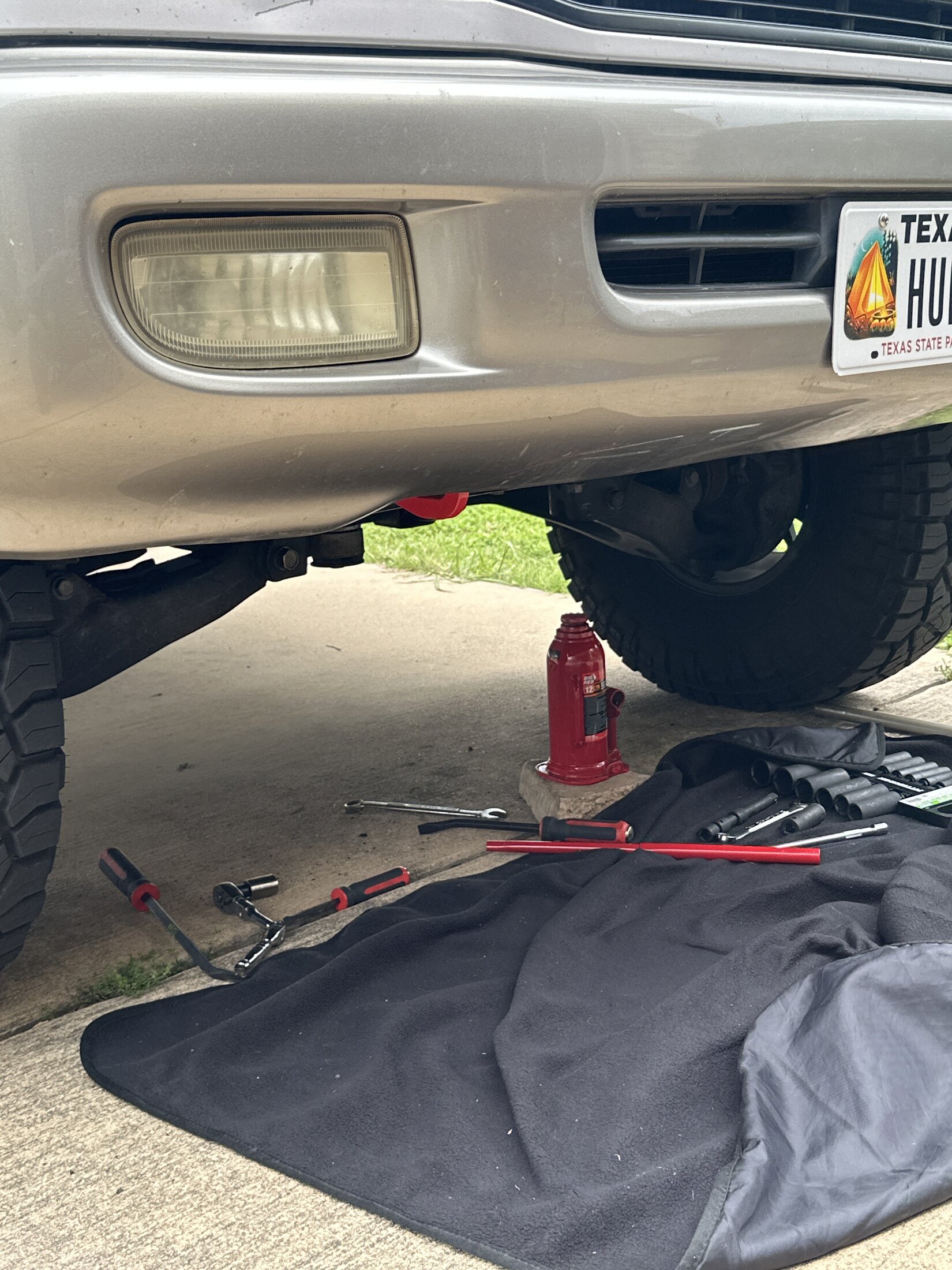

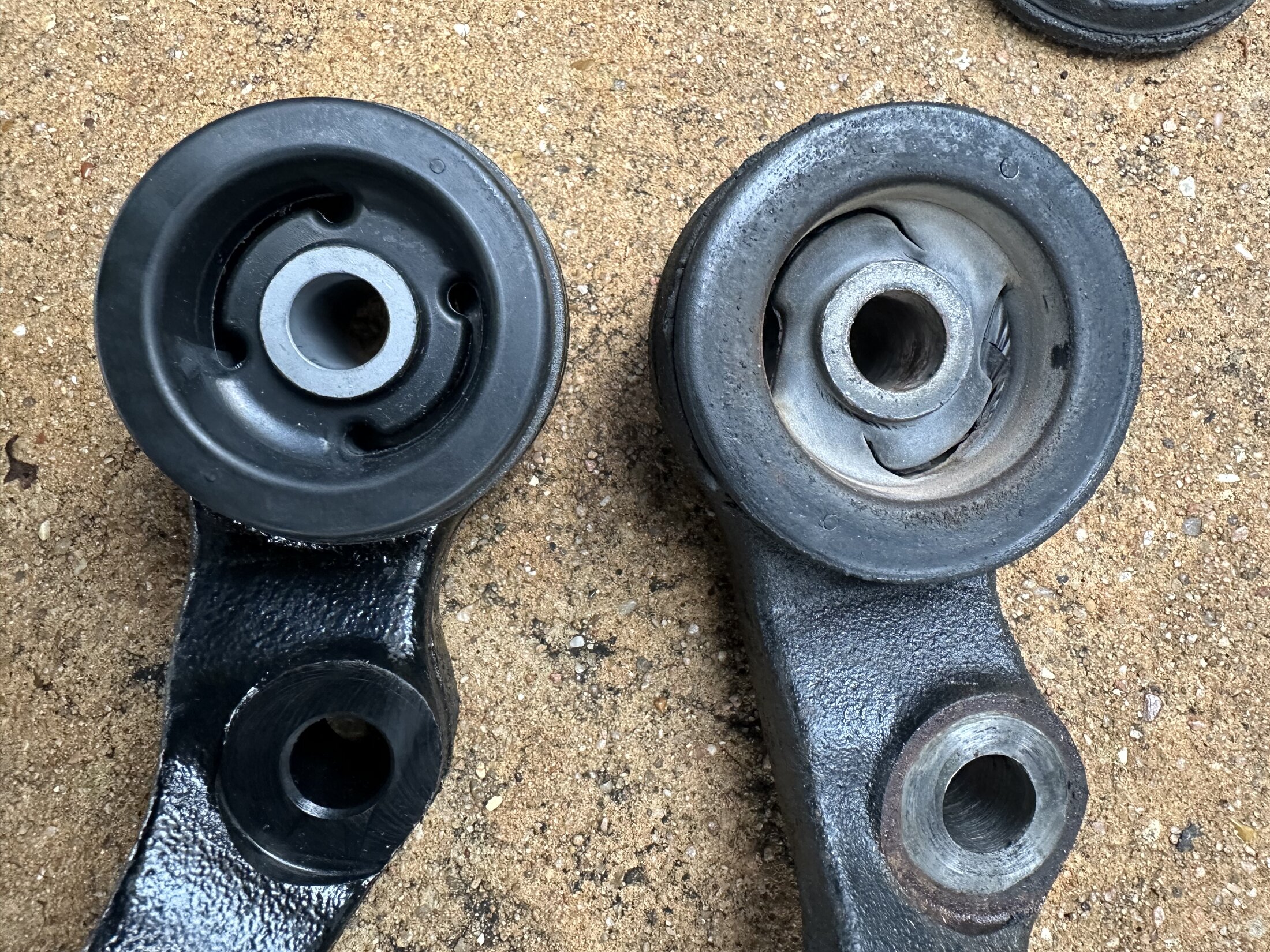

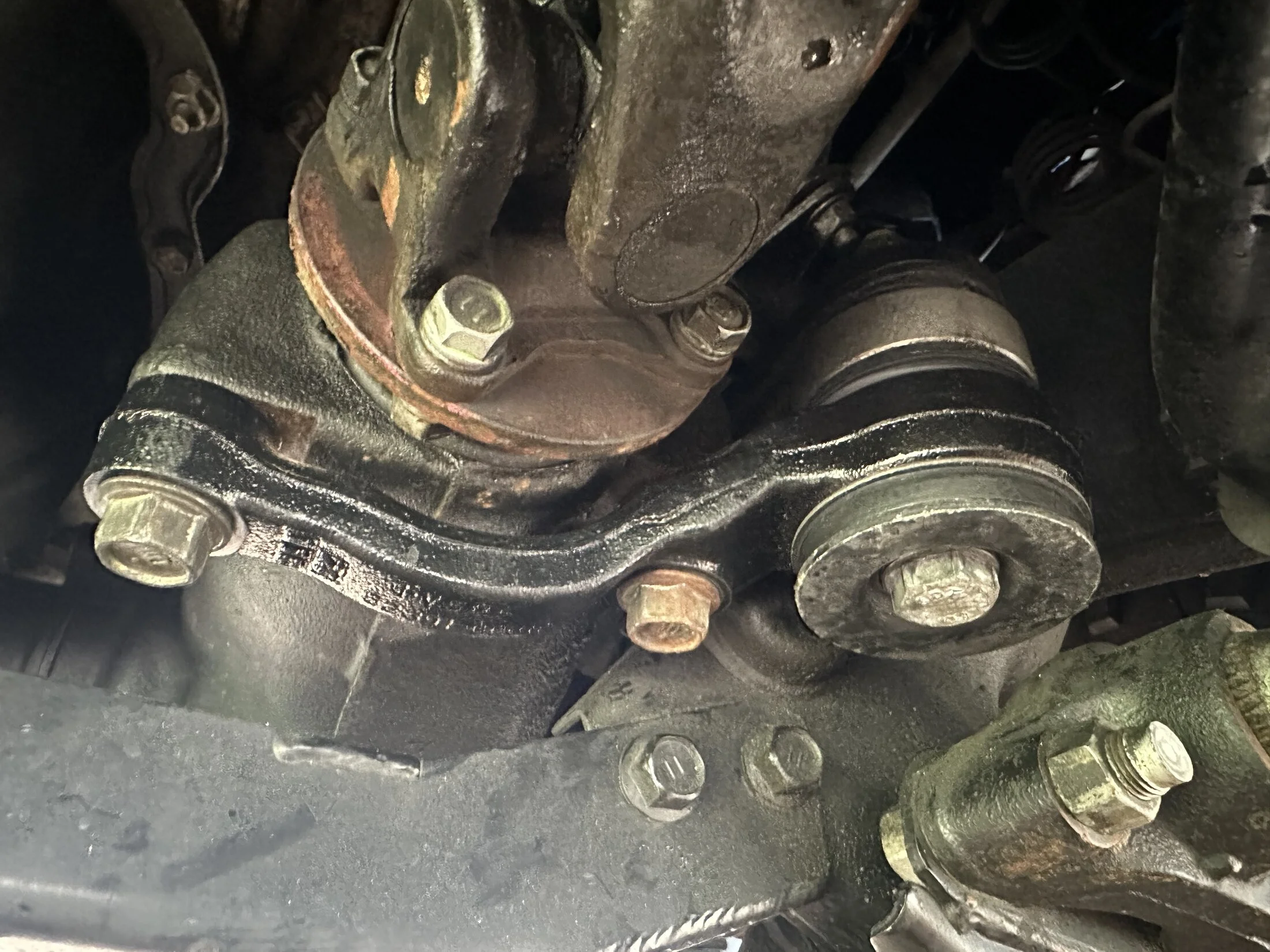

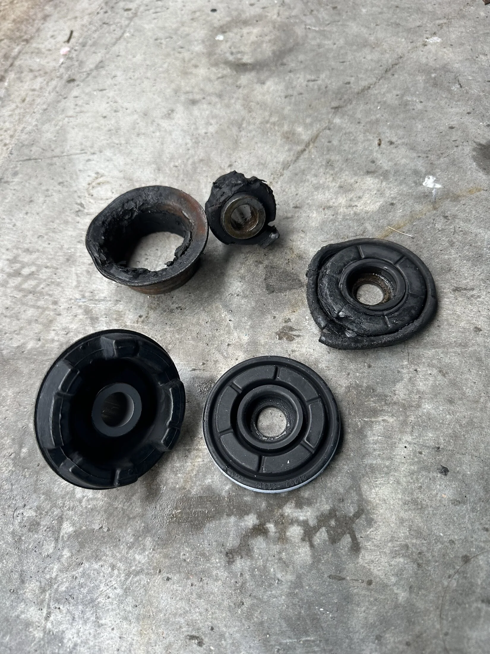

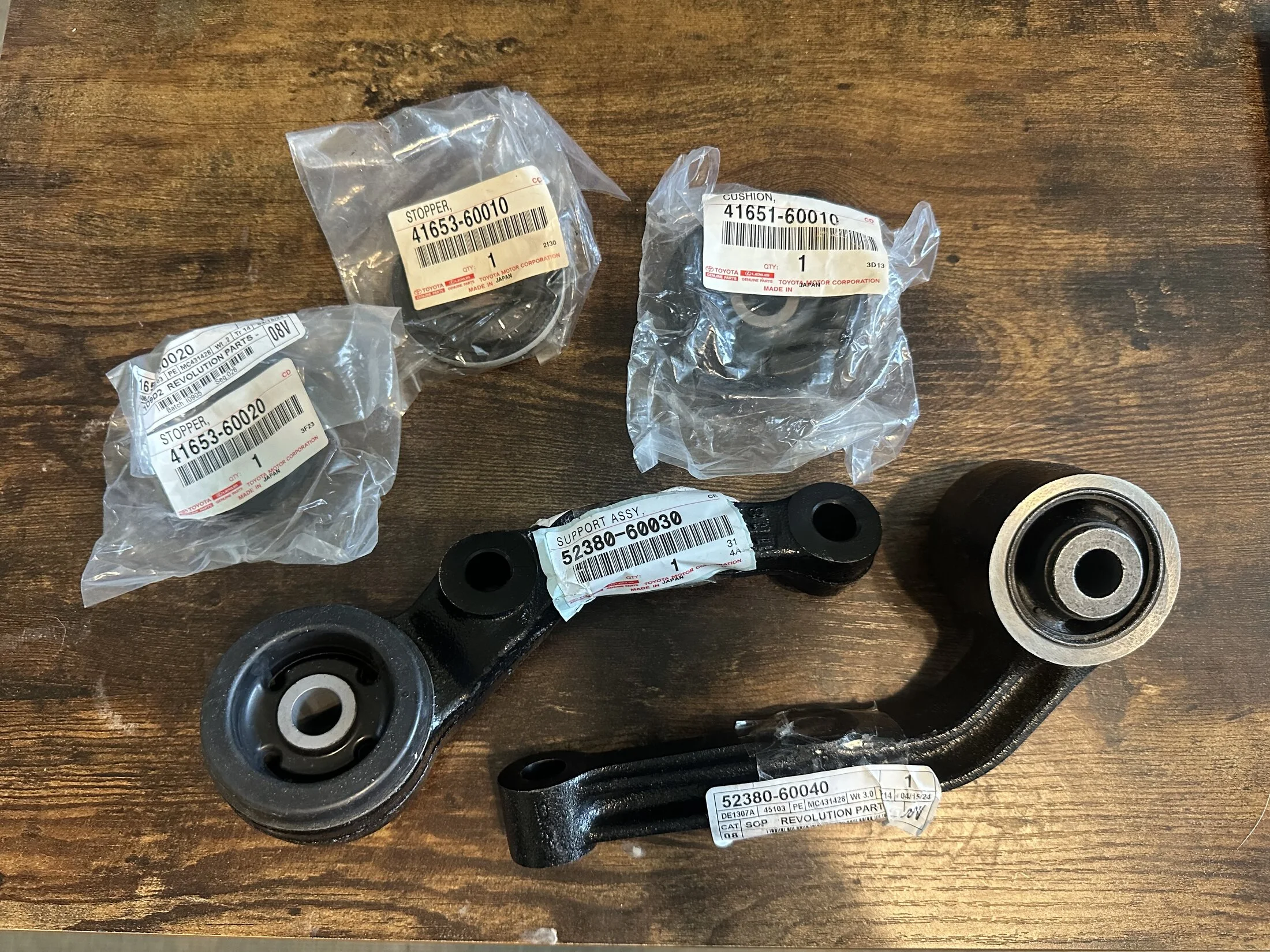

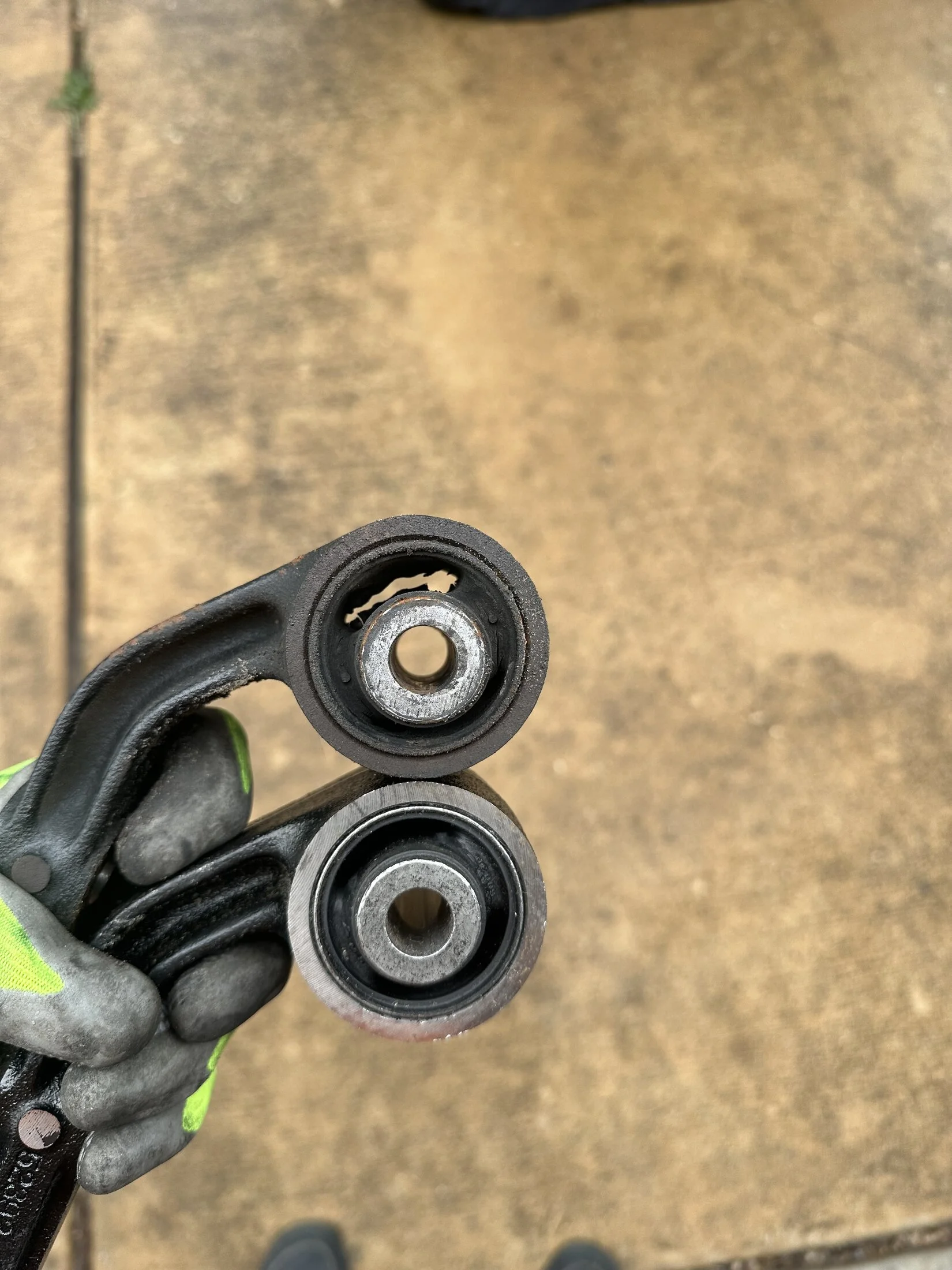

Wasn't supposed to rain and I had big plans for Hundo. Wanted to get through front diff mount, lower support bushings, and upper support bushings. Was able to just get the front diff mount out and the new one in.
The front diff mount was toast! All the rubber was gone... so out with the old...

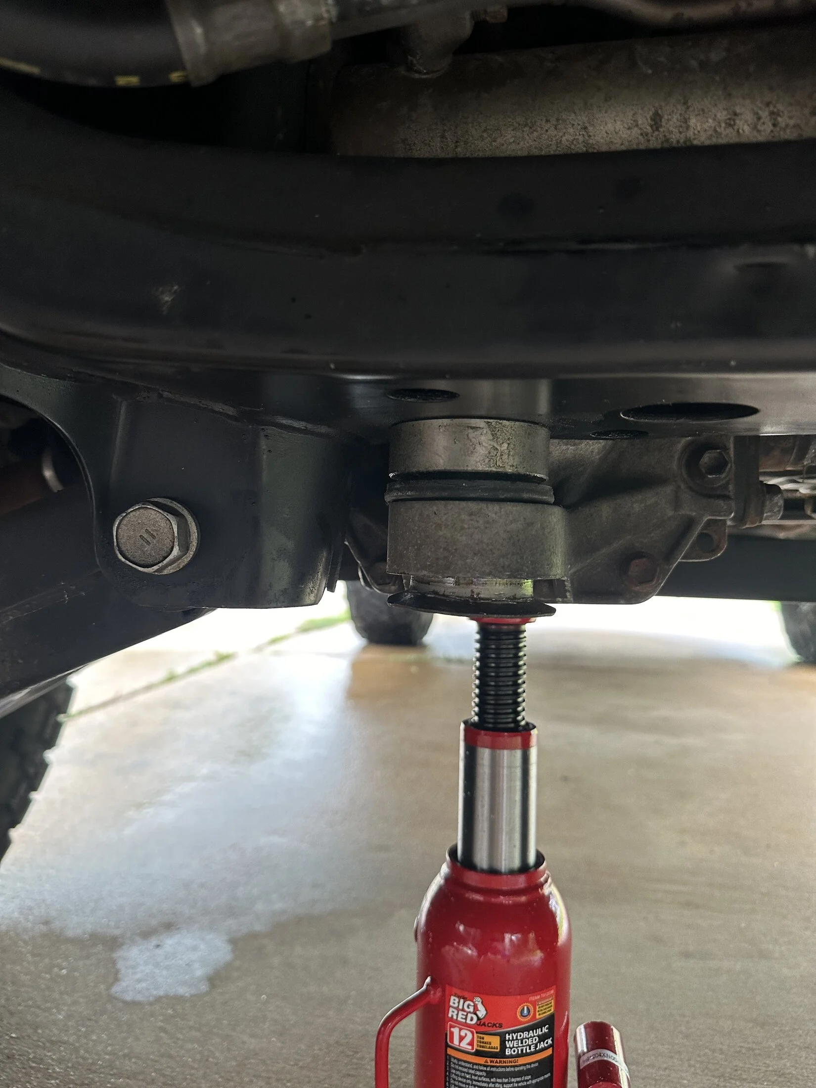

In with the new...
Once the rain stops, may have time to do the rest, but I'll take this as a win today.
Cheers 🍻
Ben
Woohoo! Rain left and I was able to finish!
After getting everything torqued down, went for a drive and happy to report "the clunk" is gone!!!
Cheers 🍻
Ben

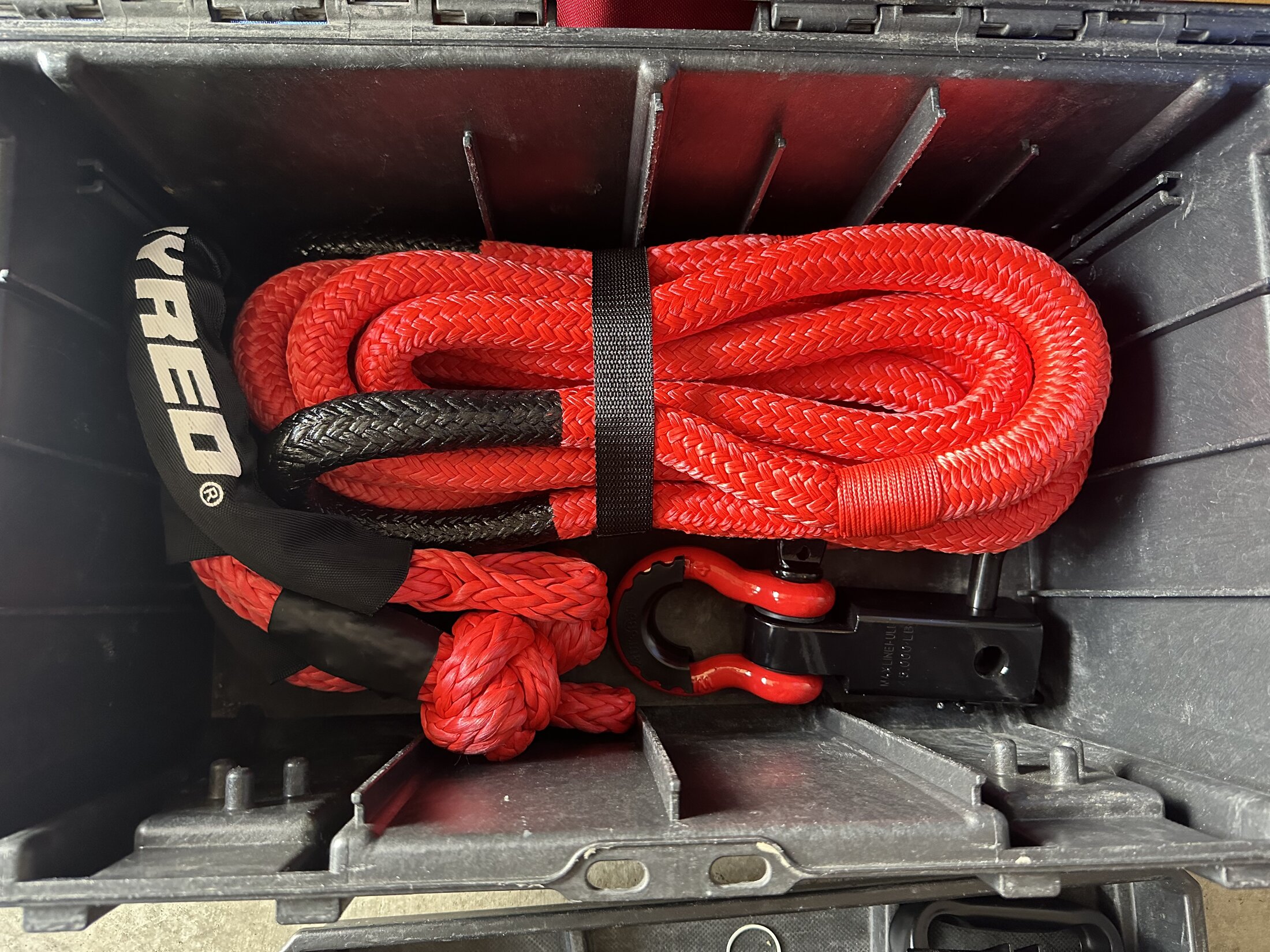

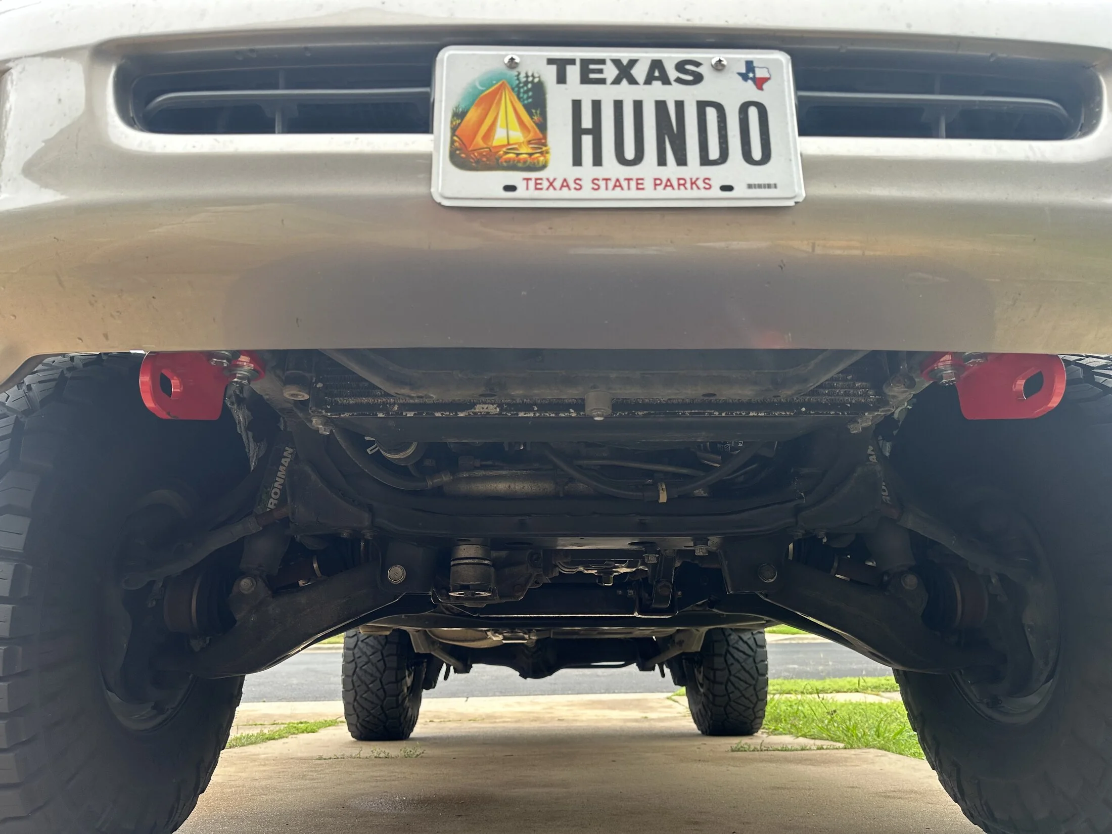

Working on recovery before a shakedown run.
Installed:
- Ironman 4x4 rated recovery points
Recovery gear:
- Fiery Red kinetic rope 1" x 30'
- Fiery Red soft shackles (two)
- Hitch recovery (two)
- Yesper 12v battery jumper
That's the kit for now, just basic recovery. Any additional suggestions welcome!

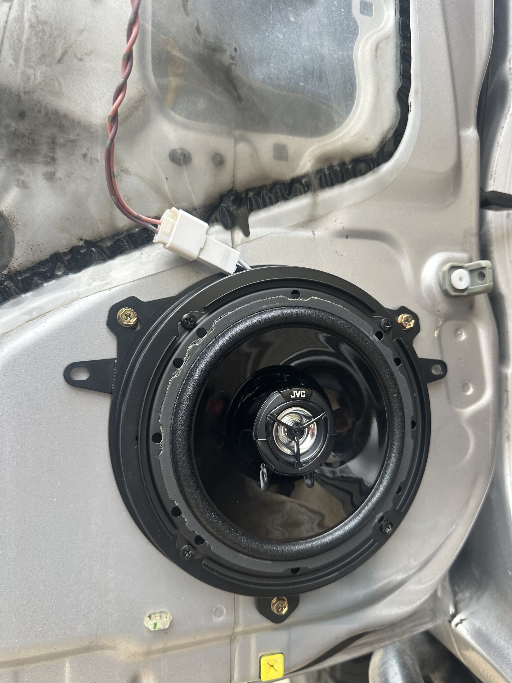

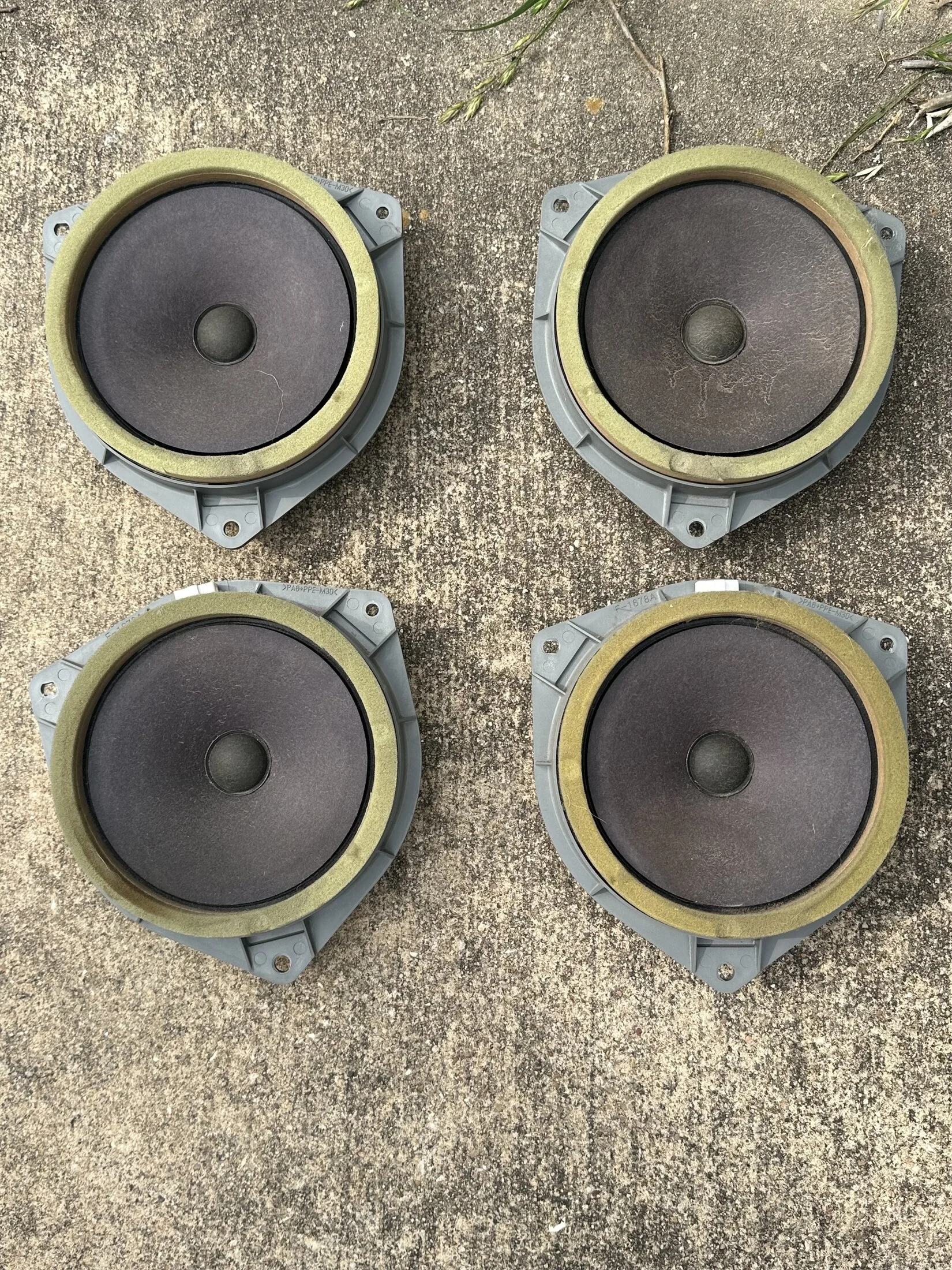

Installed JVC CS-DR621 6 1/2" speakers in the front and rear. The originals weren't terrible and I didn't see any tears, just some dust. I did find a bonus paint brush in one of the door panels 😆

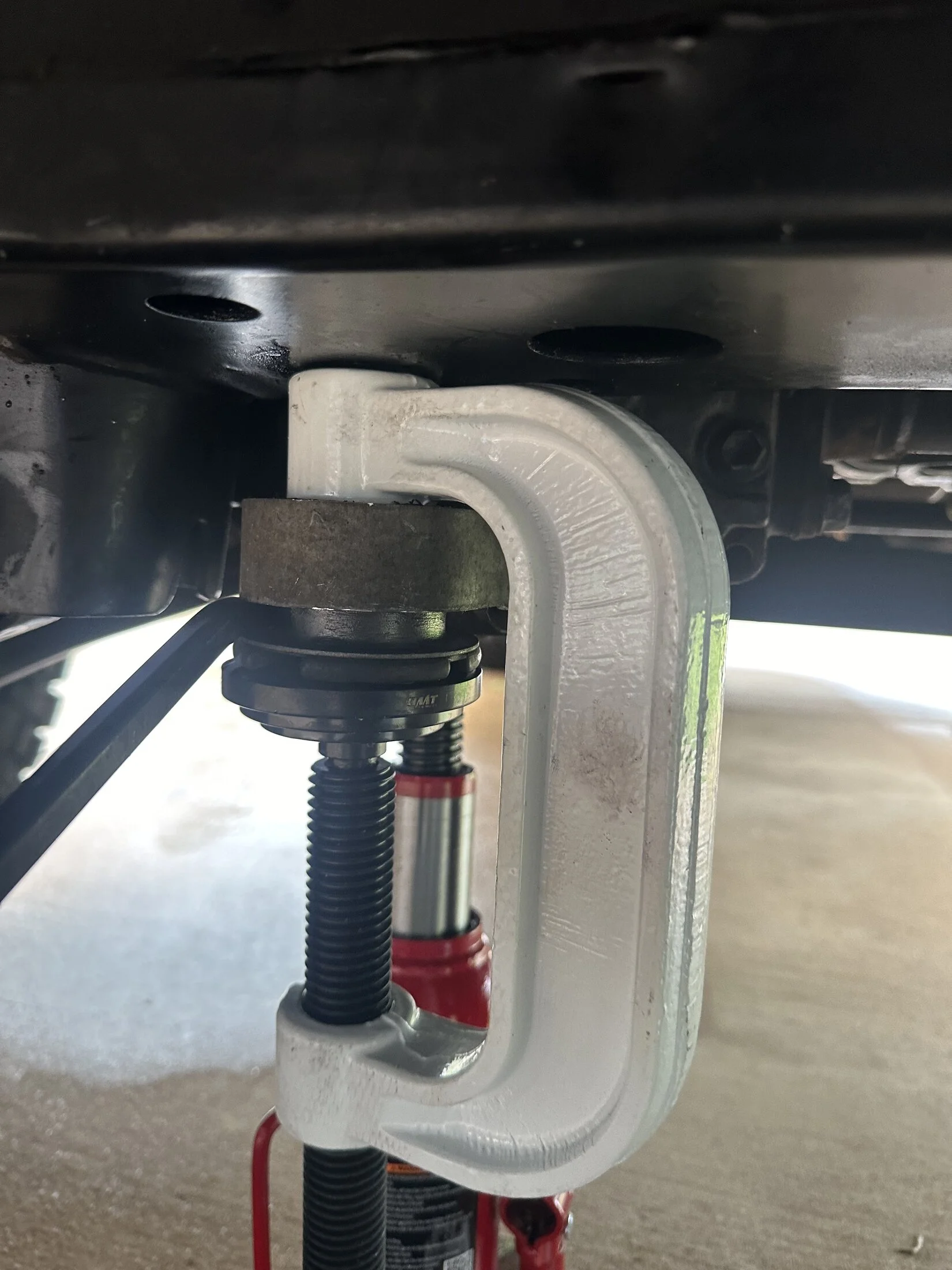

Steering rack bushings... 😖 Managed to get the big bushing done but couldn't press out the other two. Put it back together and will have to figure a different way.
