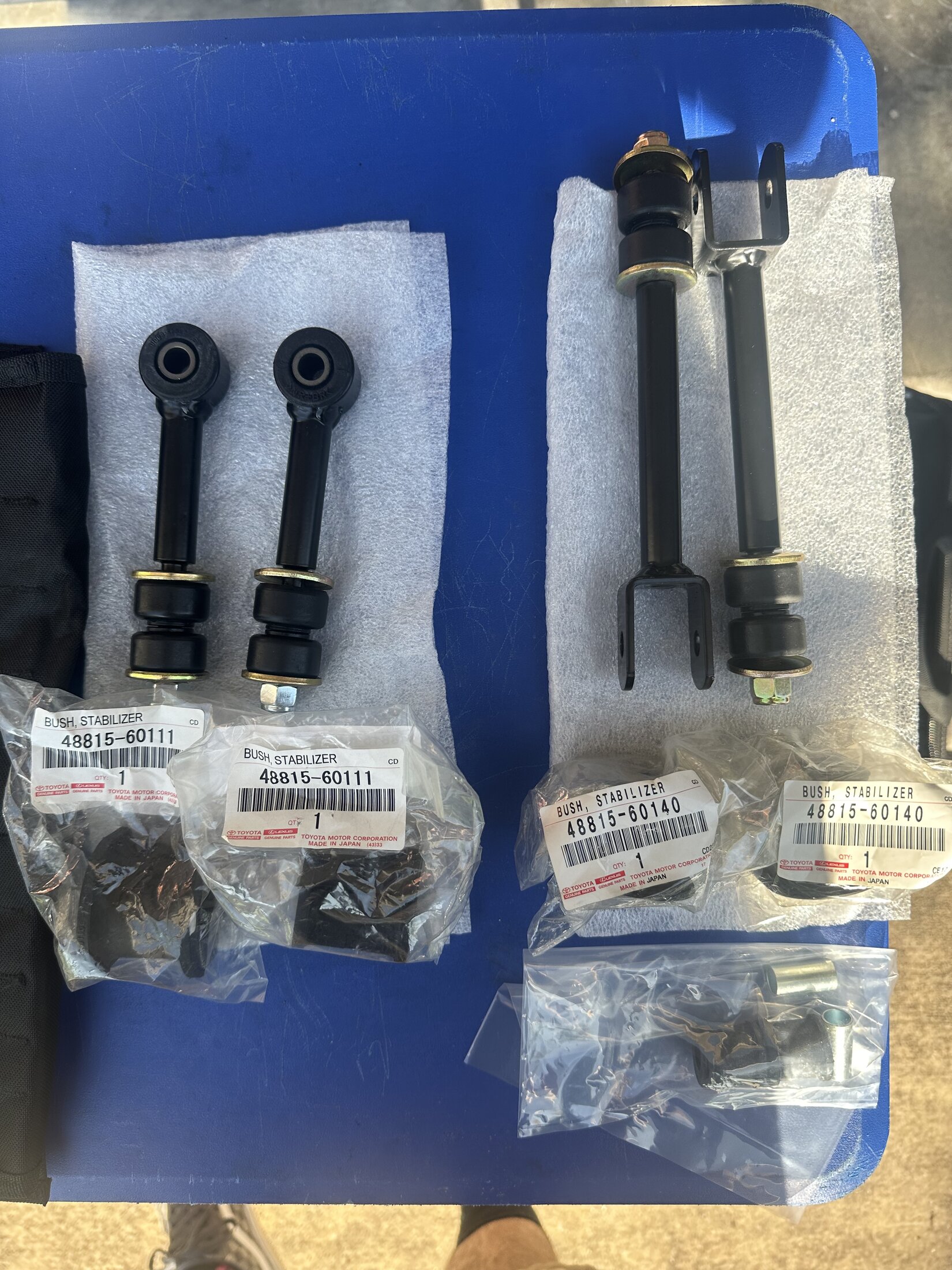

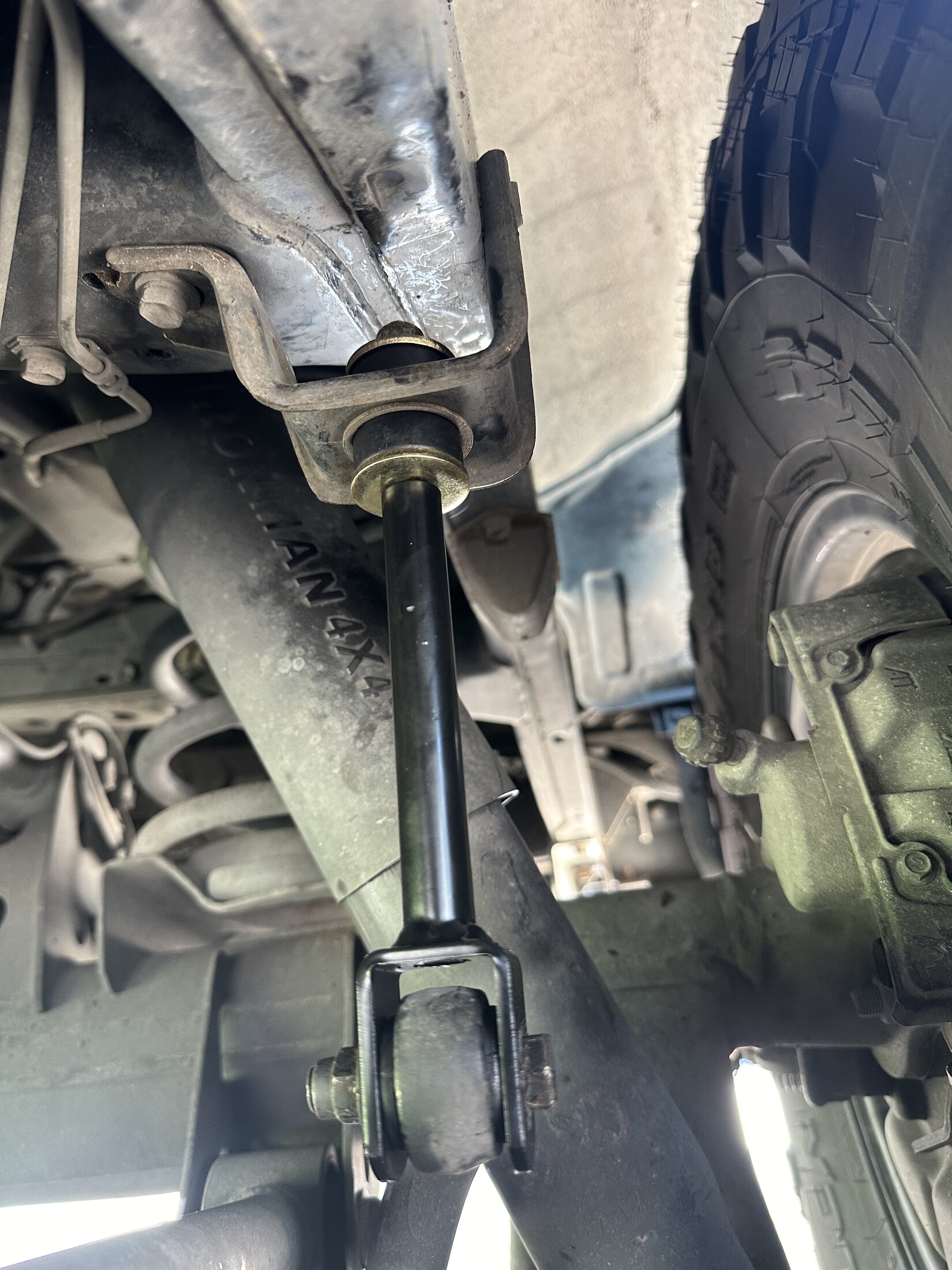

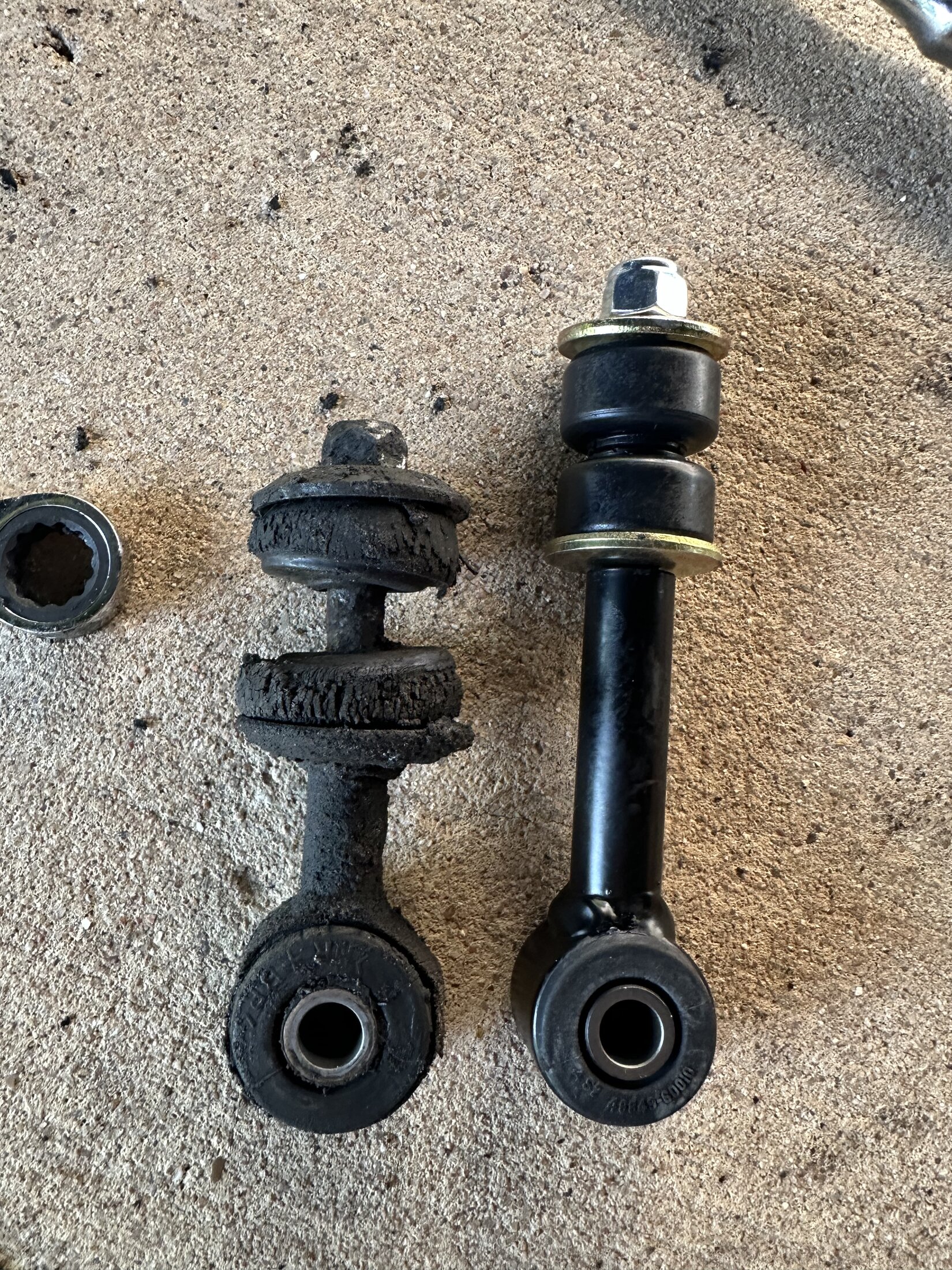

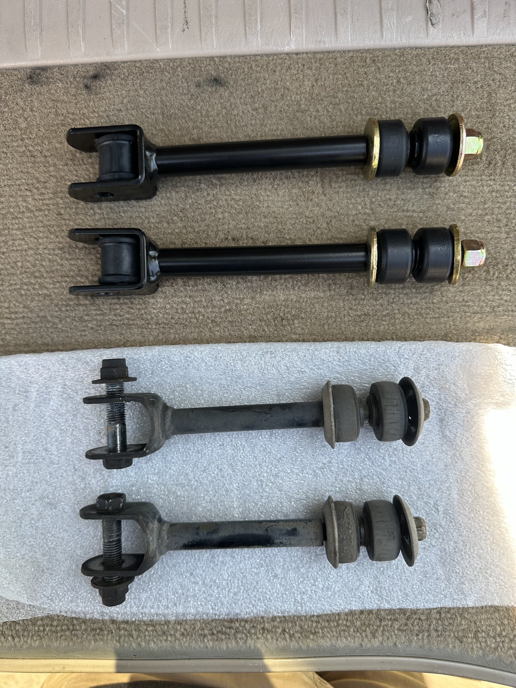

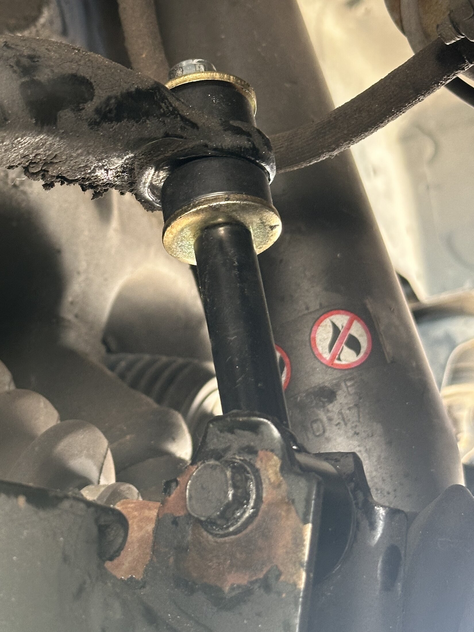

Got the ext sway bar end links installed.
Fronts looked pretty rough.
Rears weren't terrible.
Fronts installed.
Rears installed.

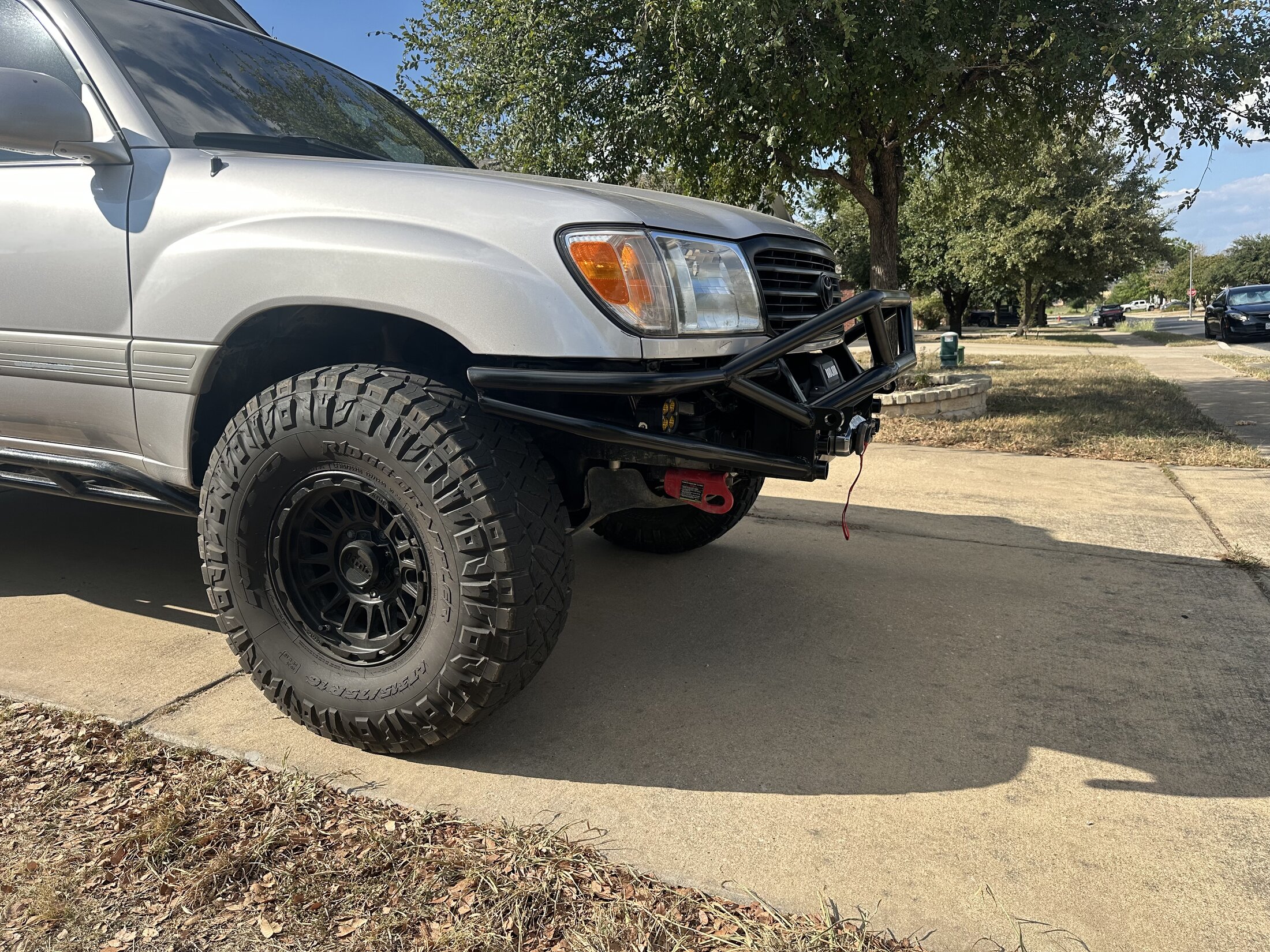

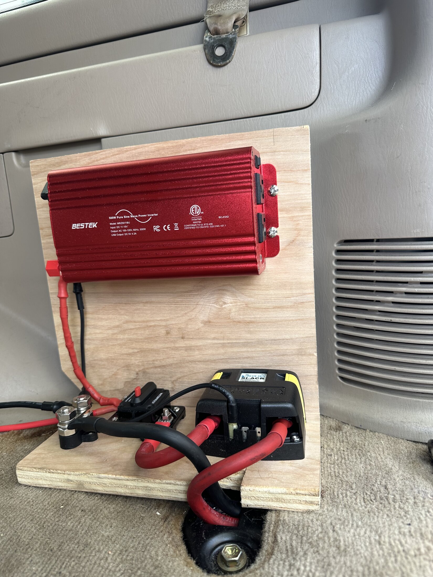

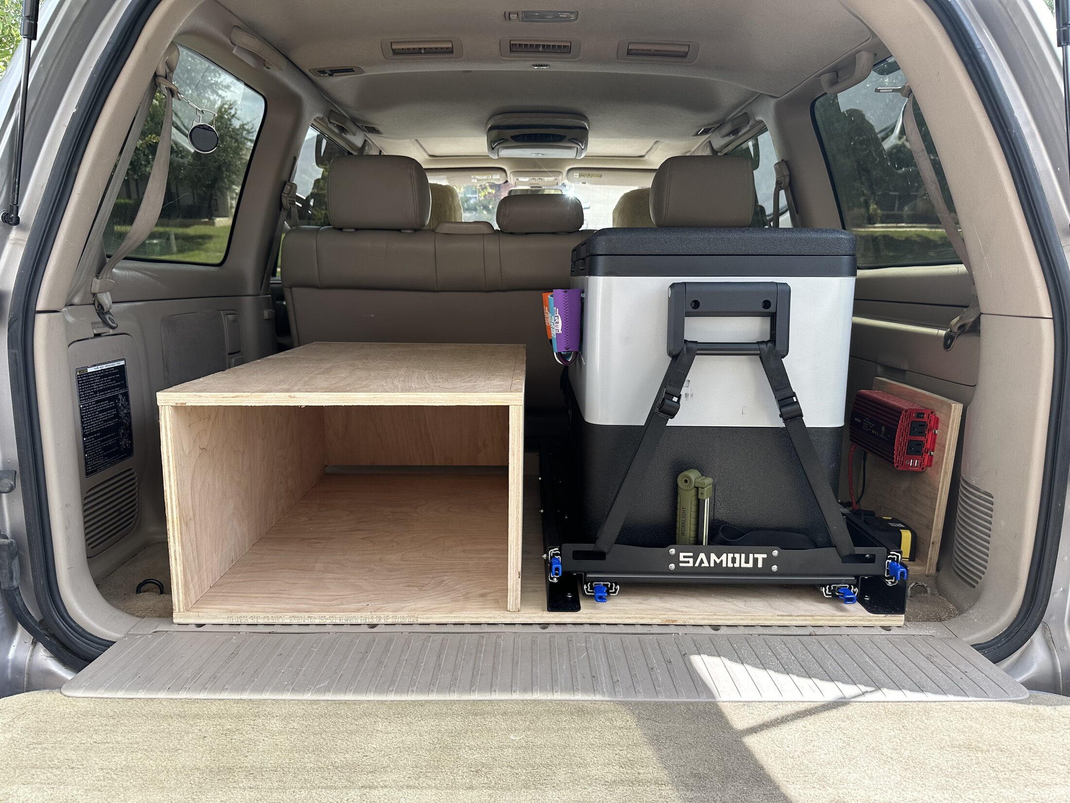

Latest round of updates! Prime Day got me and I just finished the install. Got a front bumper cooking too 😏
- SetPower PT45 fridge/freezer
- 600 watt pure sine inverter
- Blue Sea isolator
- 100 Amp breakers
- 100 Ah AGM
- Battery Box
- Samout fridge slide with cutting board
- 3/4" birch drawer (need to finish the actual drawer 😆)

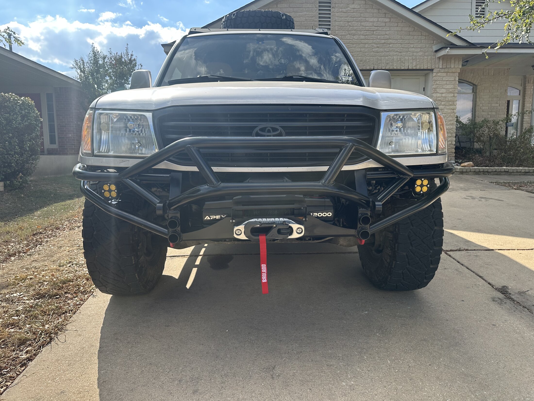

Got my front and rear bumper done at ATX Offroad (@atx_offroad on IG) and couldn't be happier.

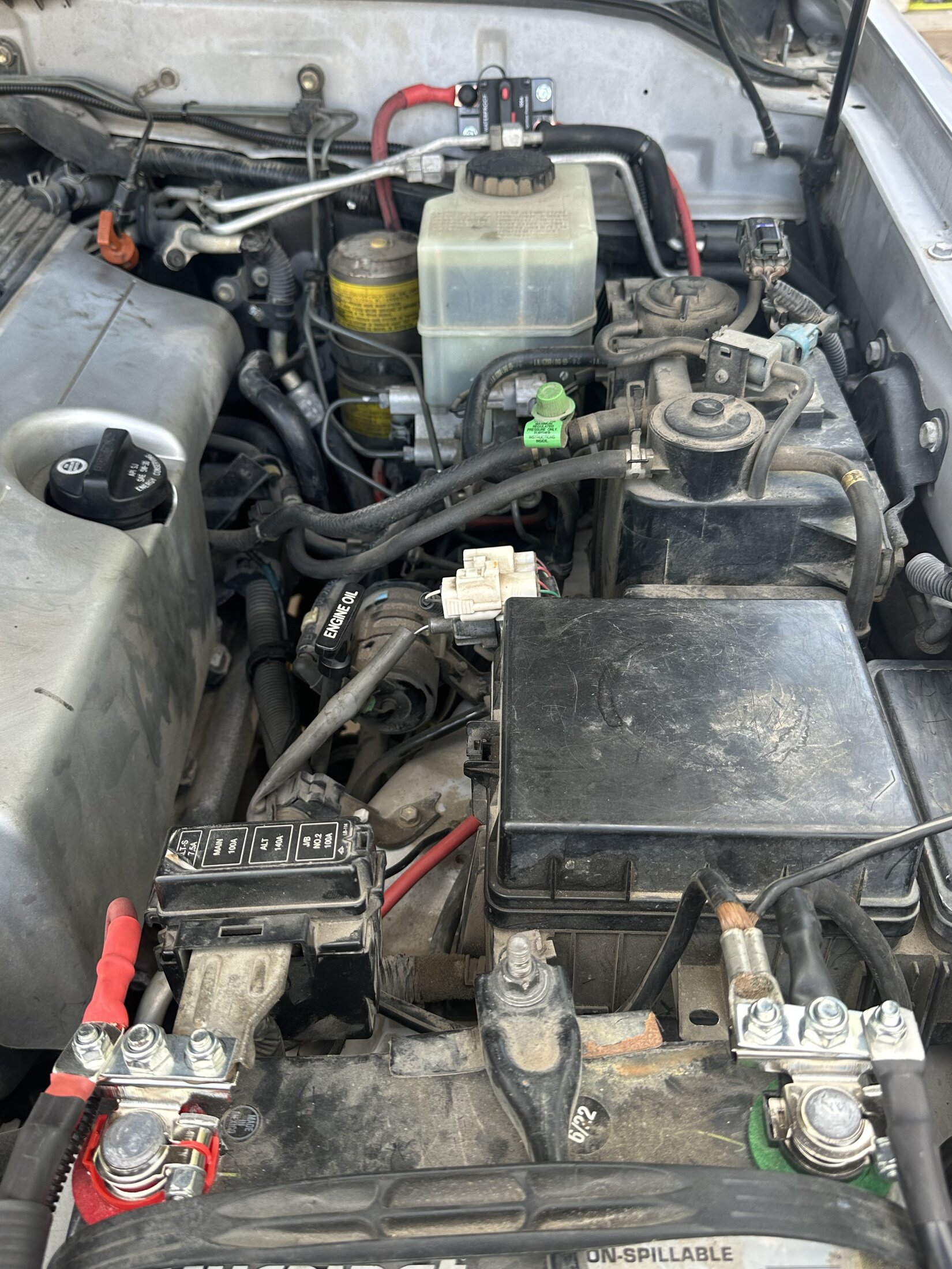

Many thanks to TTTS&M (@AverageTanner) for helping with the winch wiring and wiring cleanup under the hood.

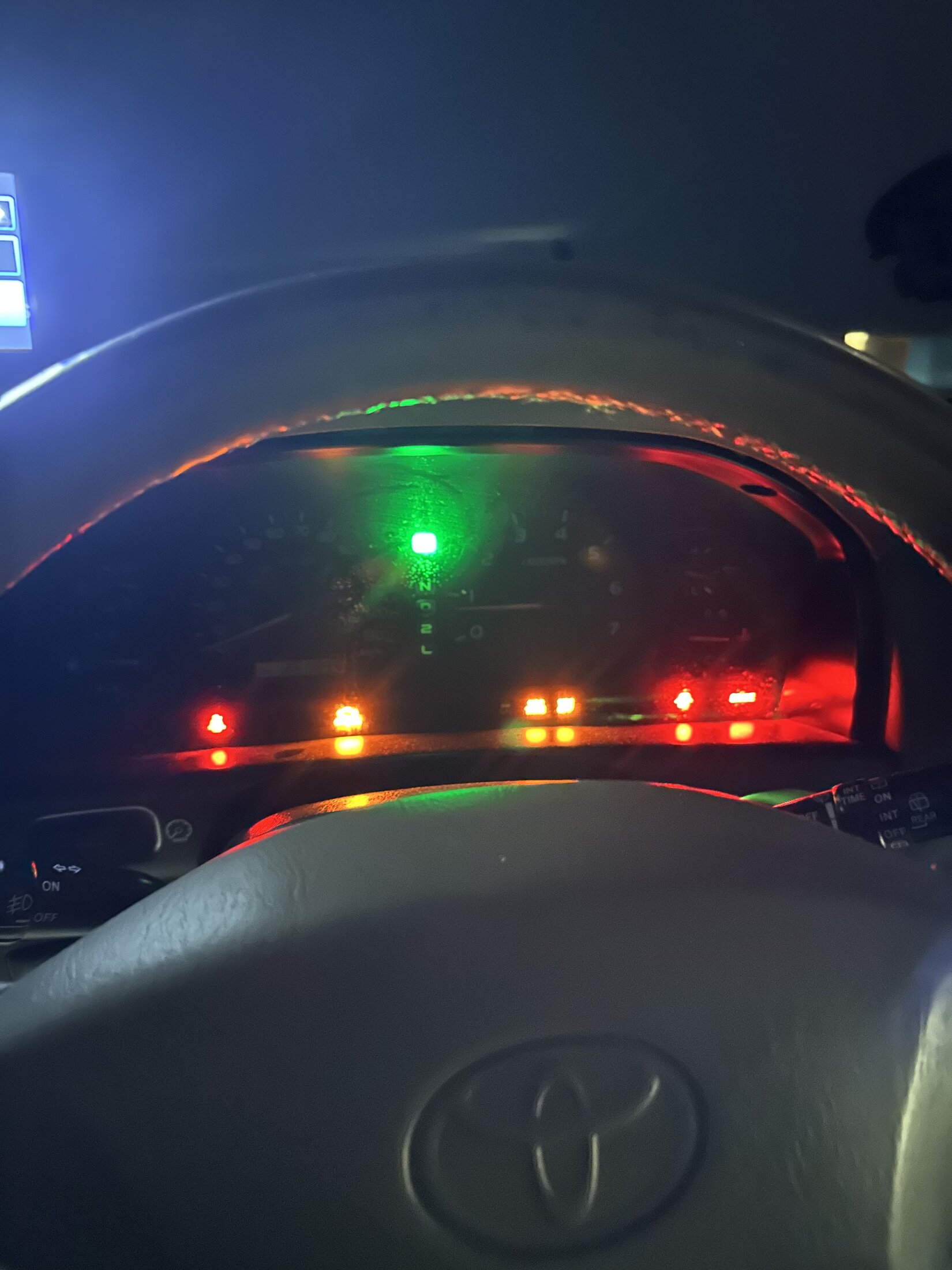

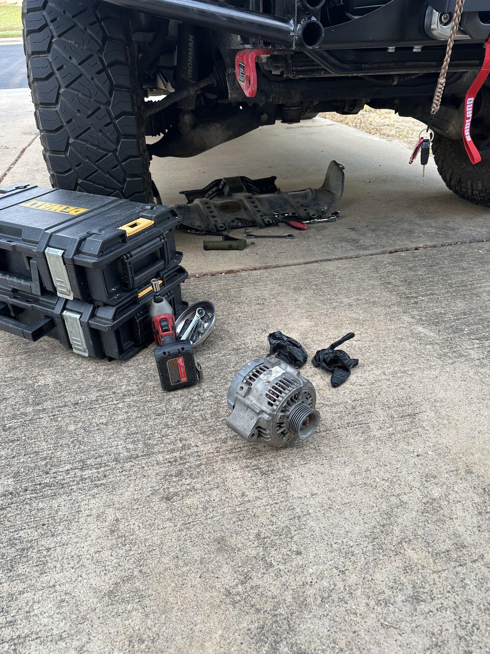

Hundo died a couple miles from the house. Pulled the battery and Autozone tested bad, ok not so bad. Buy replacement and install, yay 12.3 volts. Drove home, volts no bueno. Alternator no bueno 😢
Back to the zone for the alt. Watch YT, try to remove, watch more YT, curse a lot, remove old alt. Yay... now reverse Tetris to get the MFer back in. More cursing. And we're in. Get everything tightened down and back together.
Crank it up and we got 14+ volts baby!!! Let's go... around the block. Felt a lil funny... then I looked down and behold, Xmas lights all over the dash. WTF 🤬

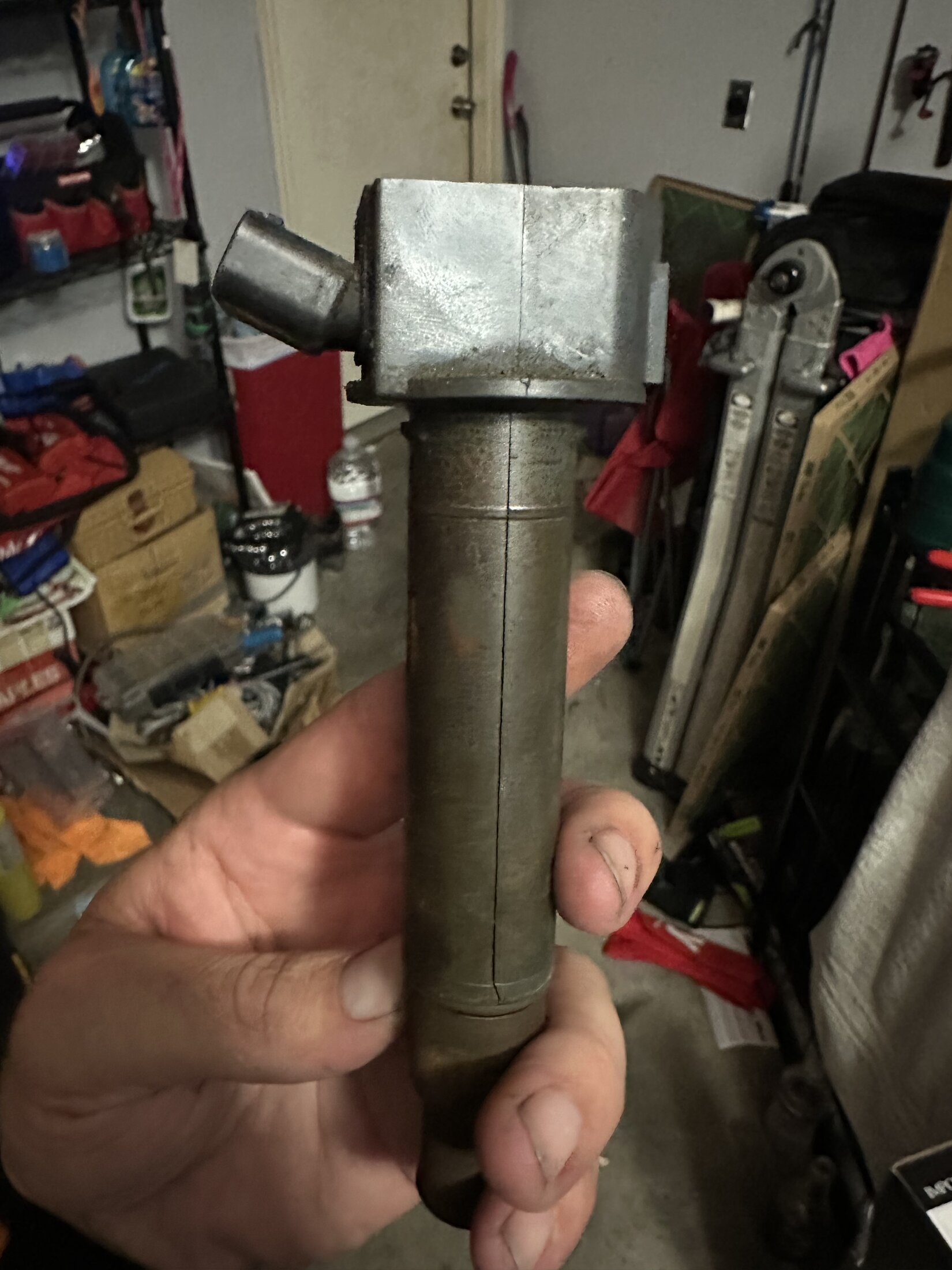

Scanner says cylinder #7 misfire 🙄
Grab my extra and pull the #7 coil and what do my wondering eyes do see, a crack the size of a Xmas tree.
Install new Denso coil, button her up and try again. Clear the codes and away we go. Fired right up, sounded 💯 better, took it around the block and man does it feel great.

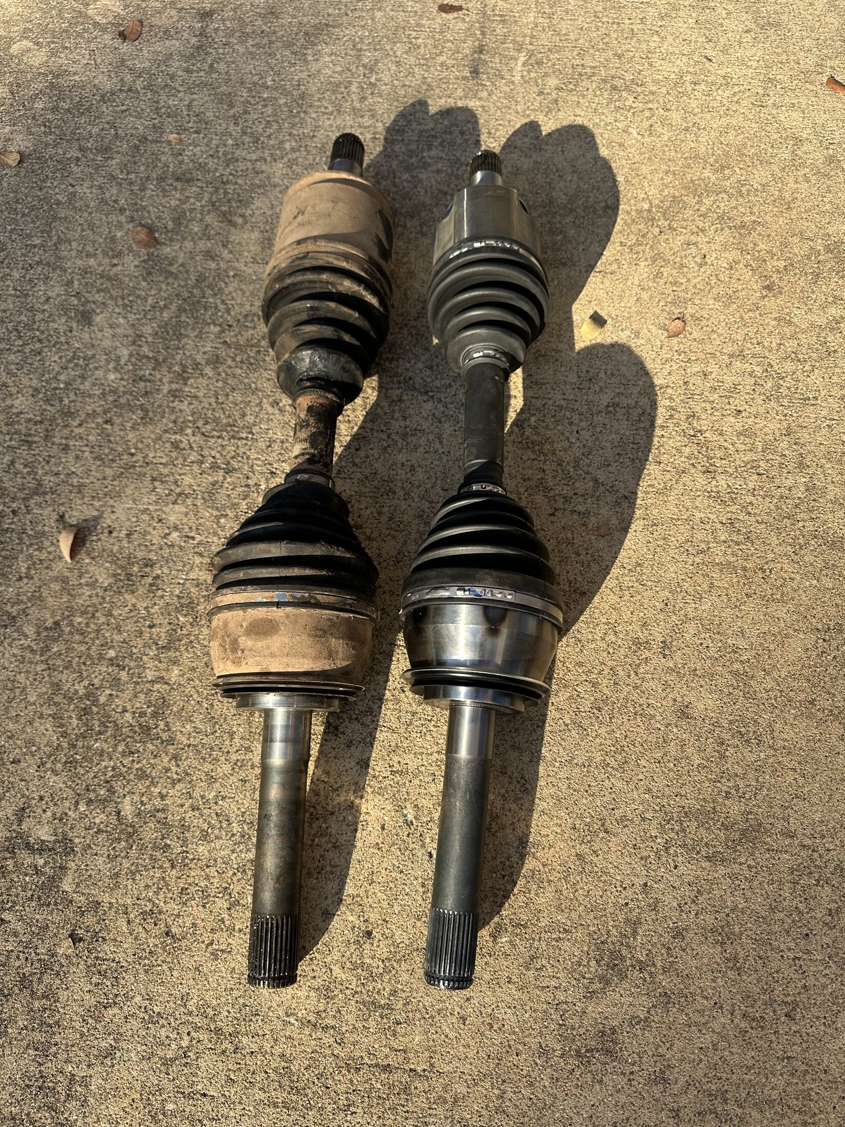

Started hearing some popping and cracking driver front. Figured the cv was starting to go. Got the cv replaced and no more snap, crackle, pop.

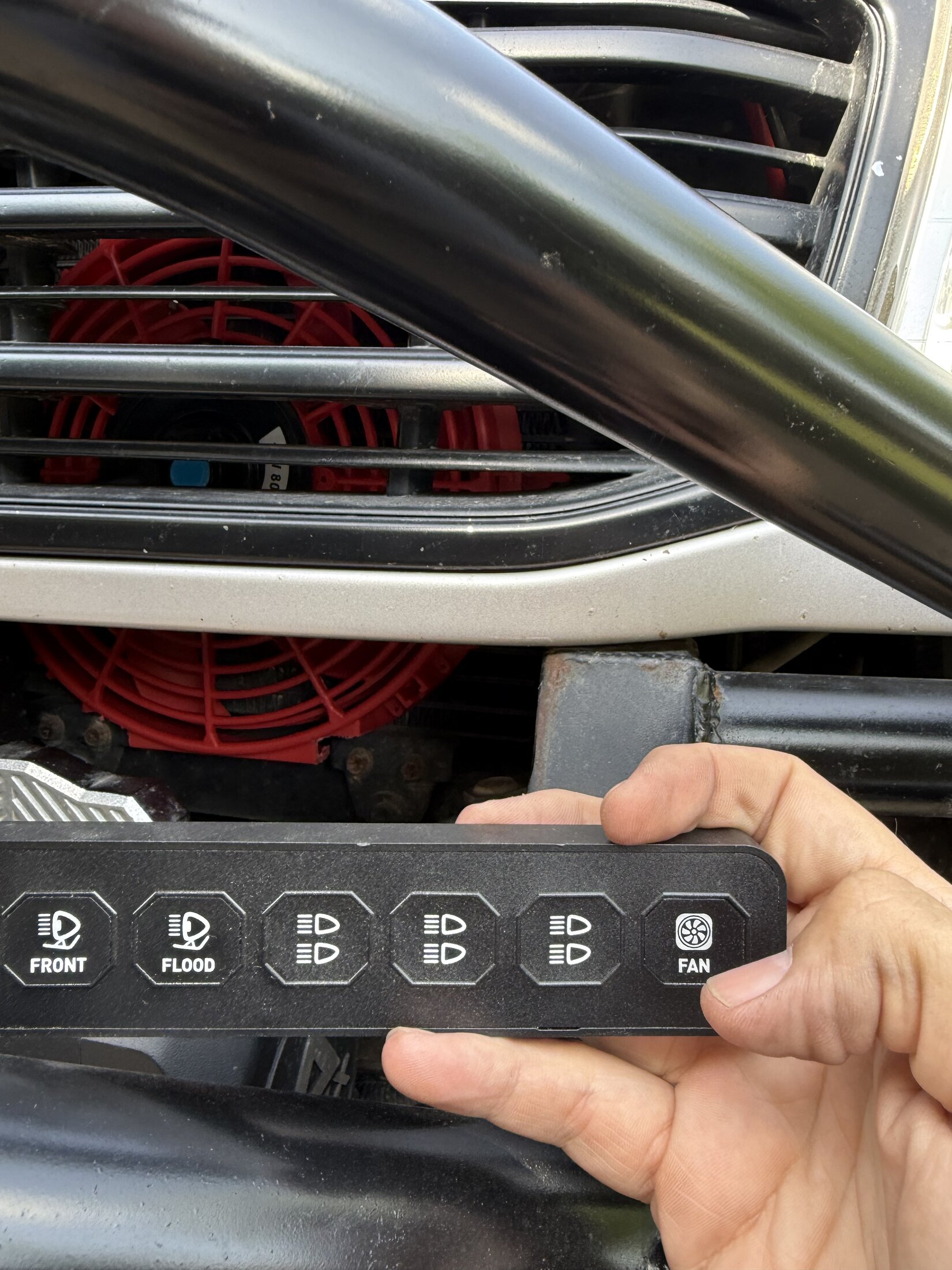

- 4 Auxbeam spots
- Wireless switch panel
- Added fan to transmission cooler
