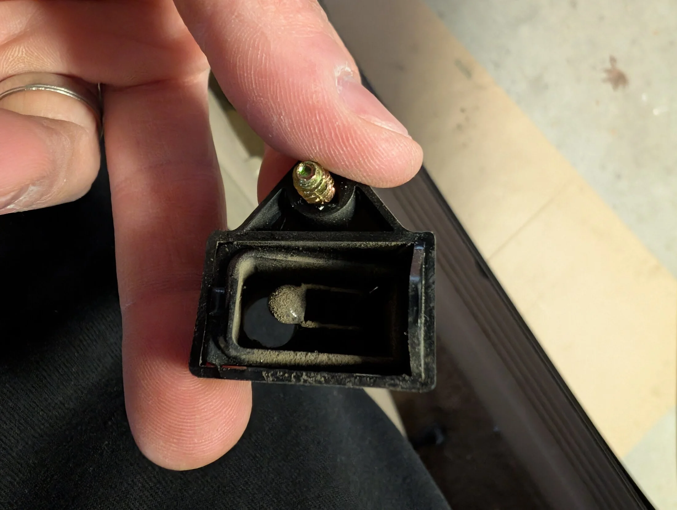

Anyways, easy project for today. For the past few weeks, now that it's actually getting cold out, I've noticed my temperature knob doesn't do what it should. Setting it to 70-72F results in pretty cool air, so I've had to resort to turning it up to max hot and blasting the cabin, then turning the fan off until things cool down. Rinse and repeat.
Seems like a common issue, so I pulled the driver's lower dash cover to inspect the climate control sensor. Like most others have documented, hose leading towards the sensor was disconnected and the sensor probe was pretty filthy.
Reattached, cleaned, and good as new! Now I've got back my temperature ranges.
