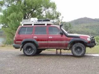

We have made a couple of good roof racks at work. We use aluminium 25x25 box section for the main frame and cross ribs, aluminium secruity mesh for the floor and folded 3mm ally uprights with a 25x6 ally flat bar gutter load disperser running from the front mount to the rear.
Here is a photo of a roof rack of a similar design to ones we build. I don't have any of the ones we build. Ours have 4 uprights instead of three.
