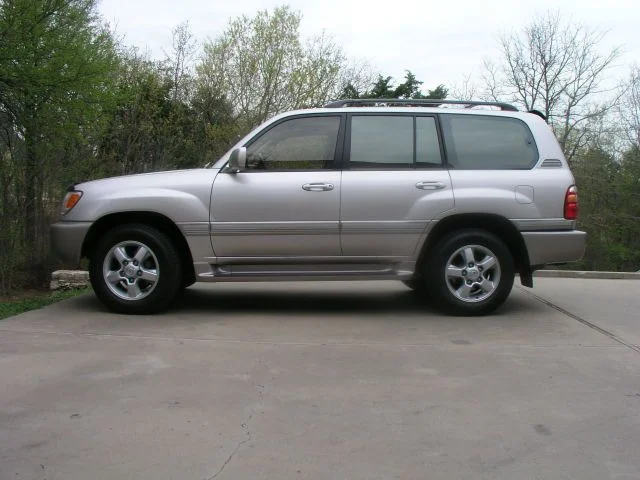

wngrog said:
The marks are off.
Before and after. 1.5" higher in the rear with the 863s
What's up with these pix? You have an 01 right?
Looks really elevated...? :confused:
