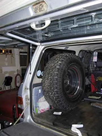

After this happened, the owner of this truck sold his roof rack to me because he felt it made his pig too top heavy. I later sold the roof rack to someone else because I didn't like how heavy it was. Then I bought the truck that's in the picture and it's my current wheeling rig.

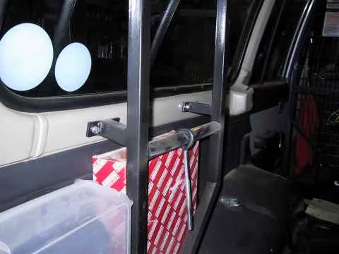

that looks great. any better shots of the floor brackets? do you just have a rubber cap where the tubing meets the windows?
jason
That is nice setup. That tire just looks huge in there. I don't like how it covers the back window but then again on the bumper it would block the back window. The driver side is the way to go in the back.

If you're light, yes. If you're pushing 220 lbs like me, you want it on the passenger side to balance out the weight. That's a mistake I made when we build my custom rear bumper, put it on the driver's side for visibility. Now my Cruiser leans on the driver's side.

Oh yeah. stinky, I forgot about the window rubbing issue. I stuck two lengths of 2x4 wood behind the tire vertically, which moved it out from the side panel a bit and prevented window rubbing. You can't see the wood in there and it worked fine, but it's kinda booty fabbish.

Good idea on the 2x4s, Sean. That should get things off the windows nicely.
