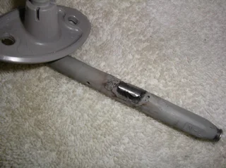

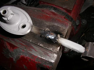

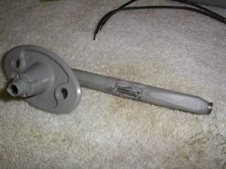

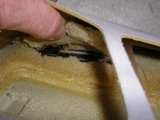

My 93 did this. The visor has a spring steel clip assembly that the visor mount rod slides in to. The visor rod is metal with a plastic covering. The plastic cover has a flat spot in it that the flat on the spring steel rests on to hold the visor up. The problem with mine was the plastic deteriorated and thus would no longer hold in the regular flat spot. I tried to epoxy it and file a flat spot in it but the epoxy eventually broke down. I finally got twisted :mad: and tore it back out cut away the remaining plastic and put a few tac welds on it with the mig and then ground it to the correct shape. So far so good. Let me know if you want pics and I will try to post.

This was a bit of a tweek but I have more time than money right now. It took me about 1/2 hour.
Individual results may vary ;)
P1 trashed plastic on arm
P2 view inside visor under mirror of clip assembly
P3 big hack job in progress
