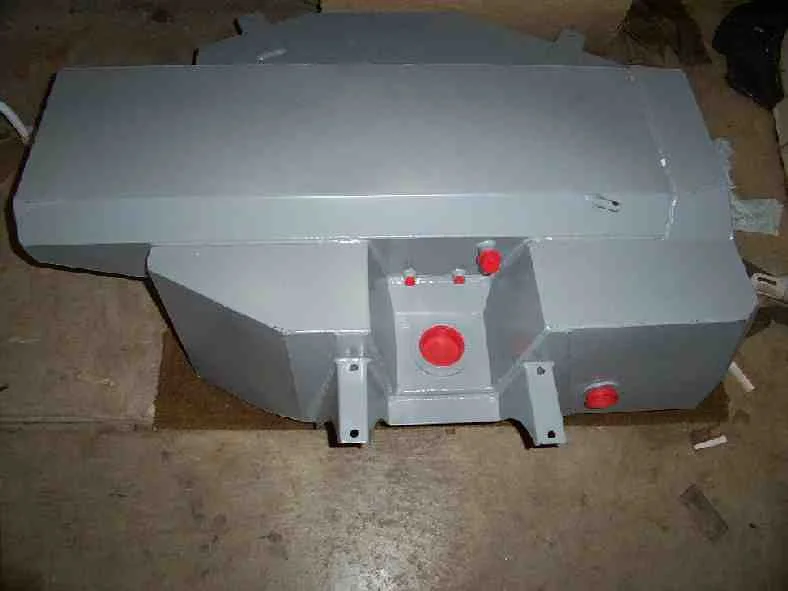

I'm not sure what your original equipment is in US, but in OZ the 2003 V8 5 speed auto 100 series came with a 95 litre (25 US gallon) main tank and a 50 litre (13 US gallon) rear sub tank. ARB distribute "Long Ranger" (different than longrangeautomotive) brand fuel tanks and they make a replacement rear sub tank that holds 182 litres (48 US gallons) if you relocate your spare tyre and remove the old rear tank. They also make a combination fuel/water tank which is 122 litres (32 US gallon) fuel and 55 litre (14.5 US gallon) water tank. The water tank is stainless steel and is fitted on top of the fuel tank. Picture attached is the combo tank, the water tank is on top, slightly left, fitted down into a cavity in the fuel tank. The breather for it does not have a red cap on it, you can just see it towards the right on top. The 182 litre fuel tank is AU$990 and the combo tank is AU$1568 although US pricing may not be a straight conversion due to marketing, sales etc. You also get hoses and fittings, mounts etc. Yes when you relocate the spare, add wheel carrier, cargo draws, barrier, lots of food beer fridge etc, add fuel/water you definitely need upgraded OME springs.
