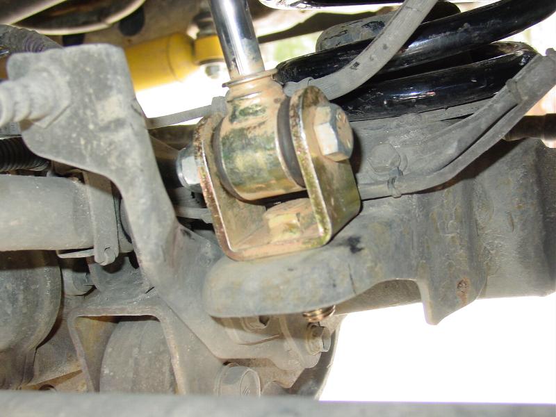

Upper and lower eye adapters for the Bilstein shocks.

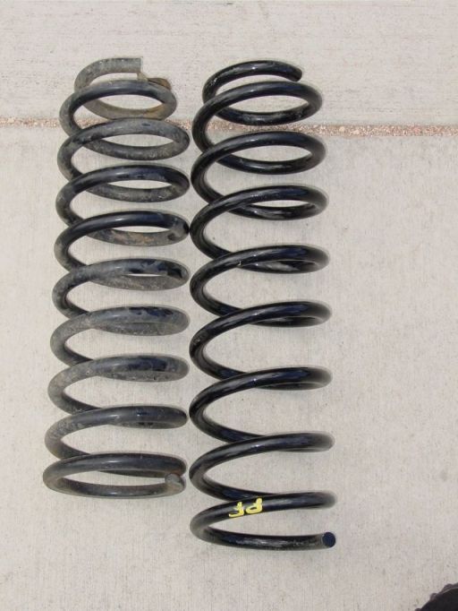

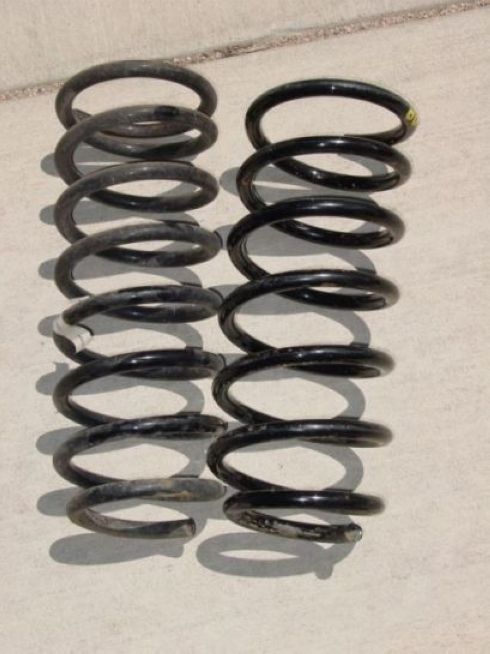

First pic shows the front coil vs. OME medium. The second shows the rear vs. OME medium. The shinier black coils are the custom.
The first was version 2 of the fronts and second pic version 1 of the rears...version 2 of the rears got longer and my rig got taller by a half inch, but no stinkbug.
If you increase length and keep spring rate the same you get a higher effective spring rate, and these coils are designed to just be at full extension when at full droop (with the Bilsteins allowing greater down travel). I could take my OME coils out with one hand with the Bilsteins installed at full droop.

ps- shouldn't the eye ends be perpendicular to the axle? seems like you are binding at the limits w/ them parallel to the axle???

Both of these issues relate so I'll discuss them here (and this could be a good tech thread):
By using eye to eye adapters, you are simply compressing the shocks and changing the ratio of up to down travel. Let's take the example of OME heavy using the regular 10" travel OME shocks, because that is about a 3" lift. You would have about 7" of up travel and 3" down vs. the 6" up and 4" down on OME medium and 5" up and 5" down with eye adapters.
If you take a 10" travel eye to eye shock on this same 3" lift, and compress it 2" with eye adapters, you now have 5" of up travel and 5" down.
The key is that to run 35's you need to lower your bumpstops about 1.5". If you left the 7" of up travel then that shock travel is lost. By spacing down the travel with eye adpaters the bumpstop hits with about 1/2" of travel remaining, which allows for some compression of the bumpstop.
An L shock does something of the same thing within the 3"-4" lift range (it is a longer body shock, which also spaces down the travel), but eye to eye adapters open up the entire world of shock options and you lose the pin mounts, which are not ideal in my experience.
That 2" of extra down travel means that your coil has to extend an extra 2" or it may come off the tower. So you need a longer coil. Part of that comes from lift, but you want a higher spring rate on the taller lift for handing and control and load bearing, and a higher spring rate all things being equal would mean a shorter spring...so you are back to your problem of dropping coils off the tower.
So you determine the needed coil length for lift height and supsension travel and then design back to the effective spring rate.
We could draw all of this in a rectangular box to reflect the front and rear of the suspension as seen from the side. The height of the box is available shock travel. Static shock extension would be a line through the middle, and your coils should be able to handle compression to the top of the box without over-compression wear, and extension to the bottom of the box without falling off the coil tower, while providing necessary handling and load bearing.
Larger tires compress the top of the box down due to body contact. If you don't shift the shock travel down to extend the bottom of the box, then that travel is lost. Rock crawlers typically want a line biased to the top (less up travel to maximize tire size) whereas expedition travelers tend to want a line biased to the bottom (enough compression to handle a heavy and loaded rig at speed in rough terrain).
My setup draws the line through the middle - on an 80 you have to account for vehicle weight, especially with a large family, but I rock crawl and the more up travel you have the more that large body is going to lean down to the rocks and into the trees.
So eye adapters can help you tune your suspension to your needs and then you can choose shocks that optimize your balance and coils that work effectively within the "box" you have outlined for your needs.
Nay

Good call on the eye ends - I fixed them after I first installed but didn't take any new pics. I'm not sold on not having one eye each way, though, as the axle moves fore and aft as well as side to side.
I honestly haven't bothered with front stops because it won't compress anyway with the stock front arms (at least not for crawling). The rear stops are 2", but that is a bit more than is required (7/8" shock travel), depending on your assumptions.
If you assume the bumpstop will compress up to 1/2", then I have about 3/8" of shock travel left after that compression. If I do anything up front I'll probably glue a couple of hockey pucks to the spring pad just to protect it during higher speed running.
I'd probably do a 1 3/4" bumpstop extension to strike the balance for the rear (but remember I don't have flares if you think that matters).
