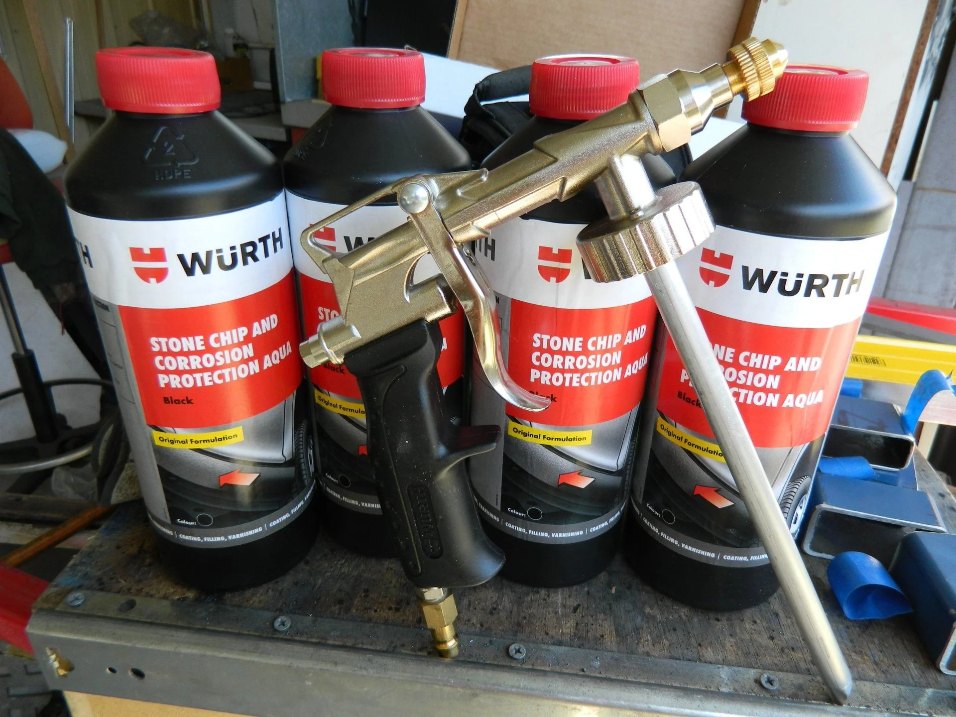

He looked it up and FYI, it is still available but now referred to as "Stone Impact Protection" (part# STNIMPPROT-BLACK-1000ML).
This come in both pressure pack or as I purchased it, in 1 liter bottles, that require a separate Spray Gun (Part# UBSSPRGUN-R1/4IN-BOTTLE-1LTR), for it's application (or you could apply it with a paint brush or small paint roller).

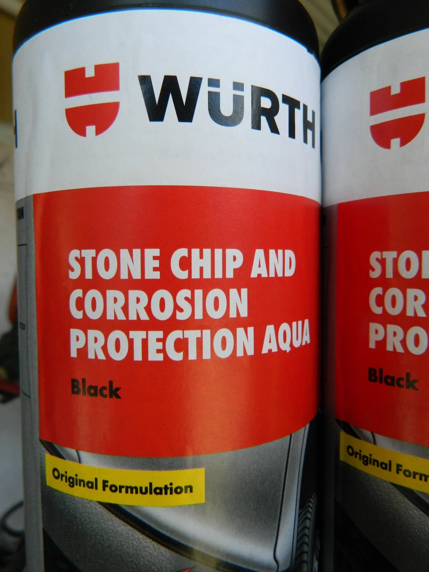

Further to this and FYI (please note the "Original Formulation", which I assume means "SKS"?).

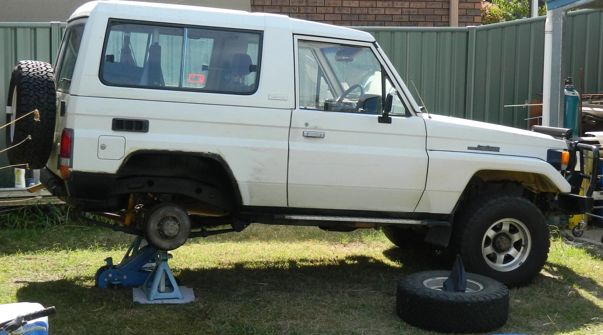

Futher to this, I have now (maybe that should be Finally), applied the Wurth product, to all four wheel wells, of the Battle Cruiser.
After the inside of the wheel well, had been scrubbed (with a scrubbing brush and dish washing detergent) ........... it's Very White in there! First time it's seen the sun, in almost 30 years!
1916665

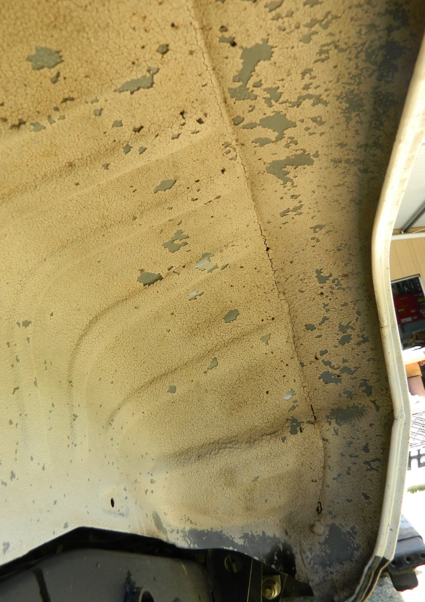

Before, RHS Rear.
1916666

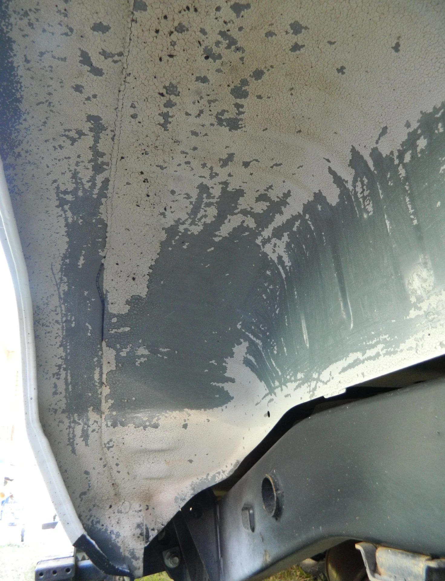

After scrapping off the loose original factor finish, LHS Rear.
1916667

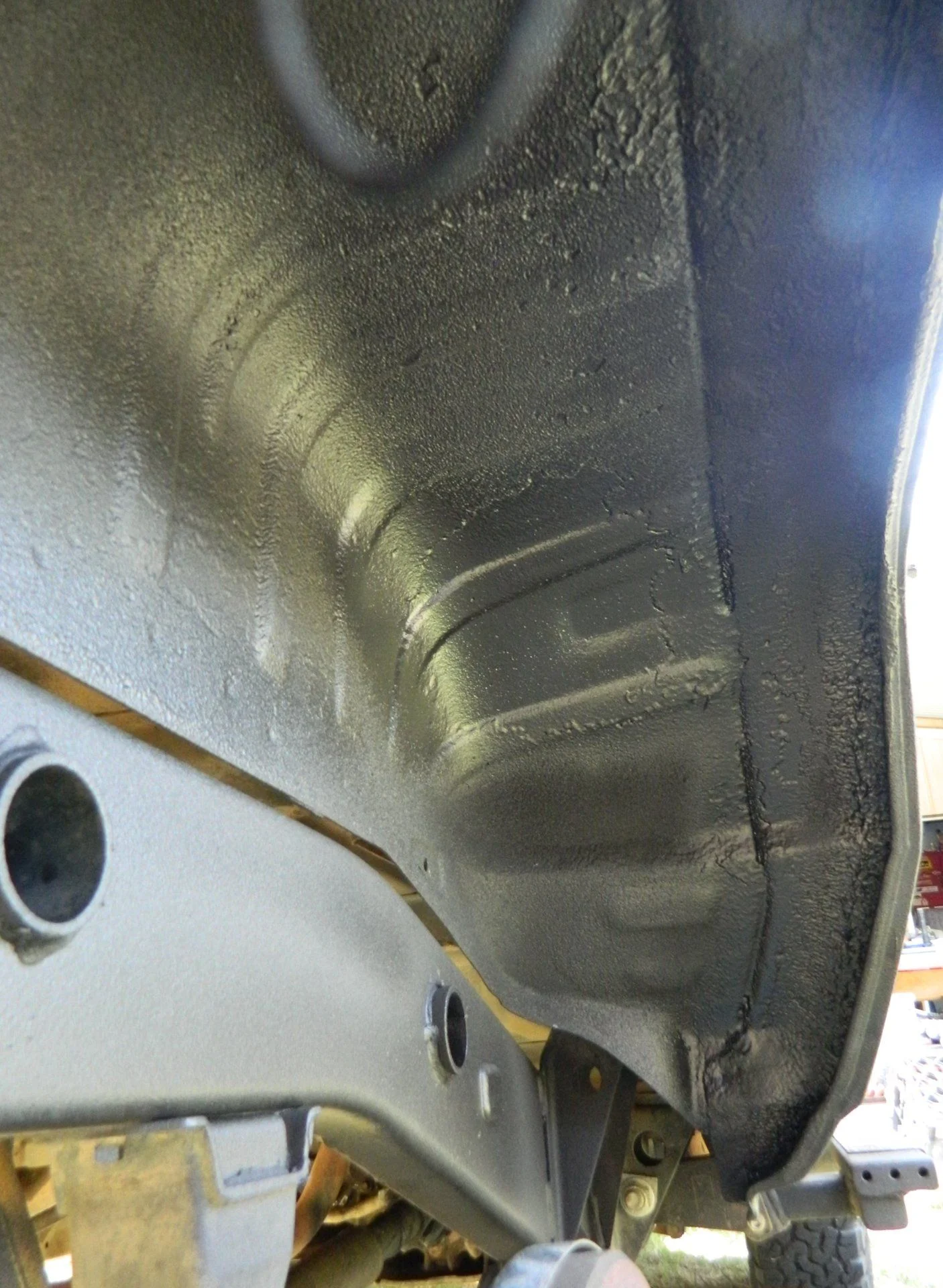

After the Wurth product was applied (Multiple coats), RHS Rear.
1916668

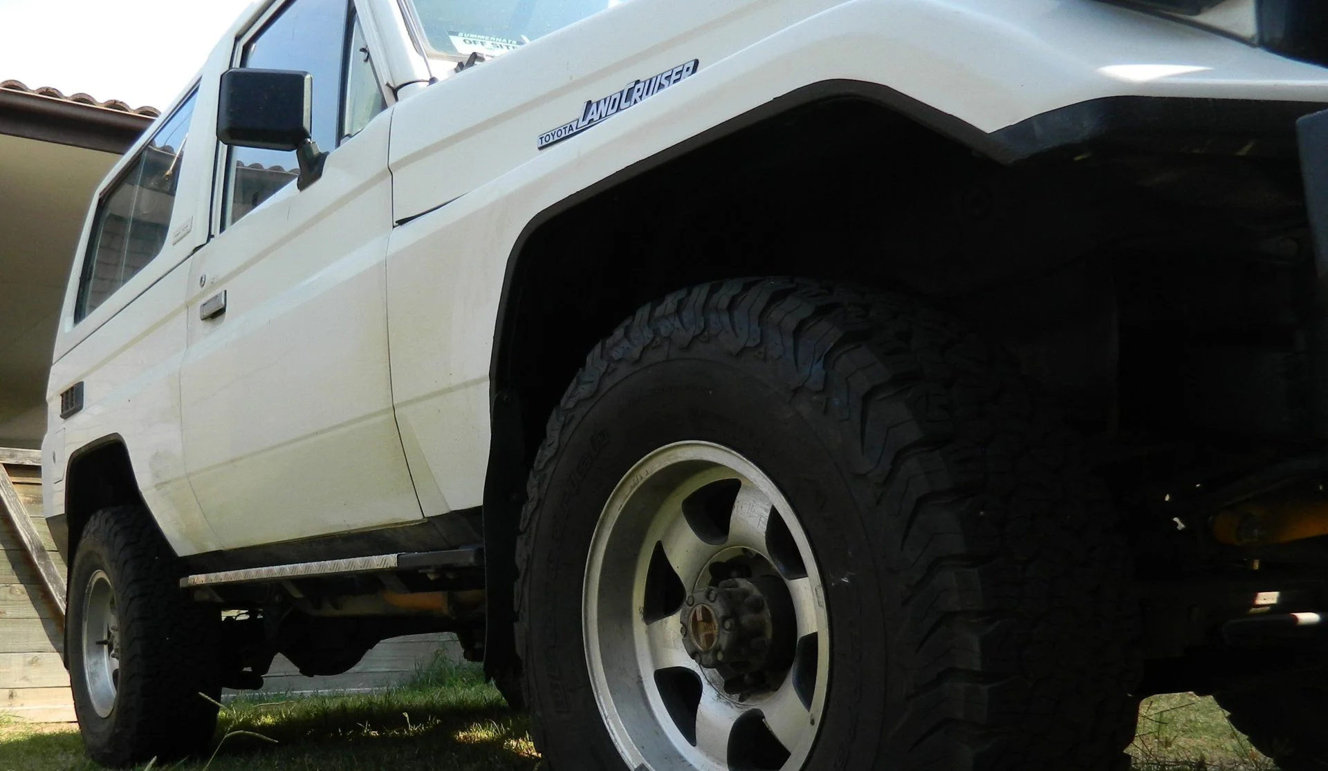

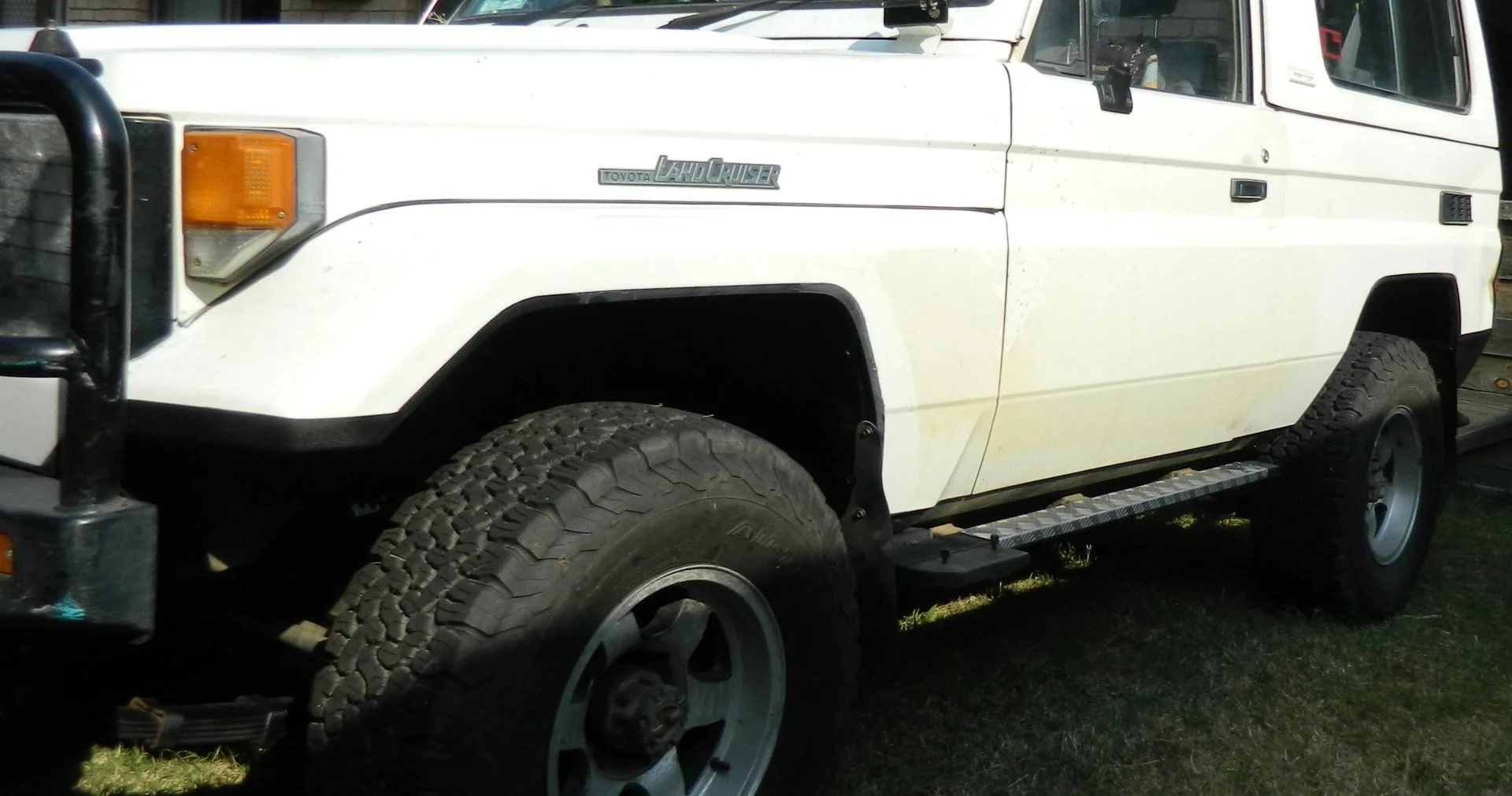

I also masked off and applied the Wurth product, around the exterior, around the wheel arches and rear of guard.
1916669
Avagreatweekendeh!
Homer

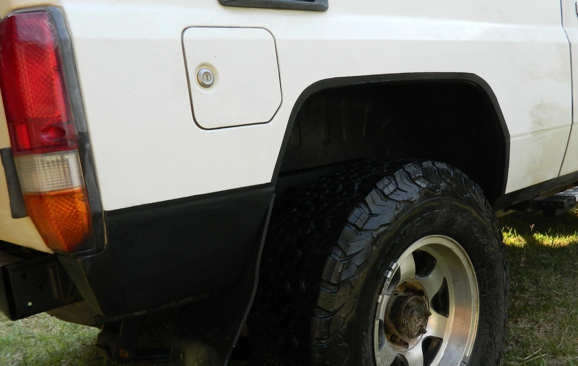

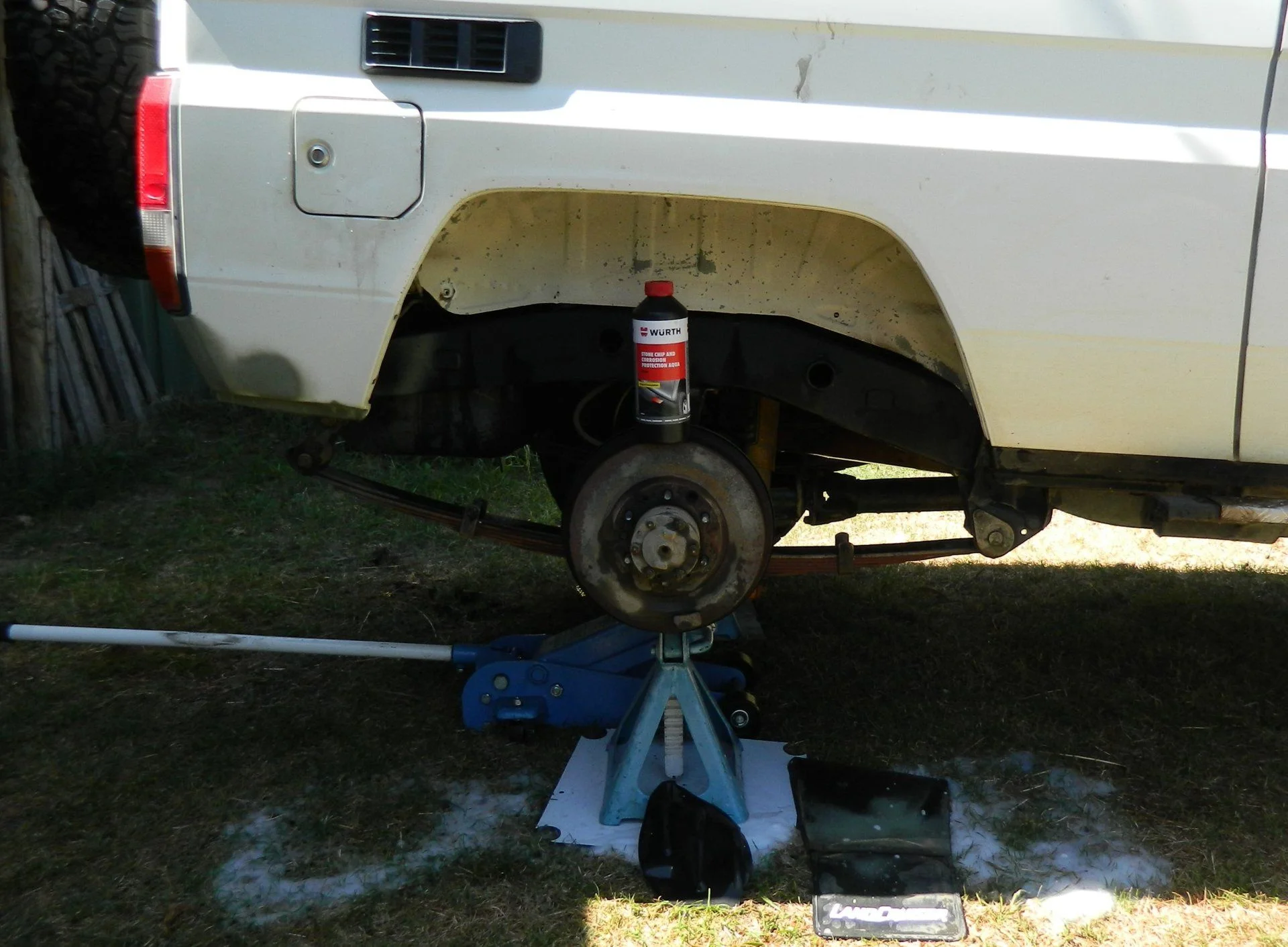

Here's some more images ......
1916671
You can see here, where I have also applied the Wurth product, around the outside of the wheel arch and the forward part of the guard.
1916672
Ditto .........................
1916673
I also applied the Wurth product, to the chassis rails and other chassis/frame brackets, etc, in each wheel well.
FYI. I applied multiple coats (x 3), to each of the four wheel wells, chassis rails, etc.
To give you an idea of how much to order, this used up 3 1/2 bottles of the Wurth product.
Also, and FYI, once this product was completely dry, it actually feels like it's some kind of Plastic.
It's still just a little bit soft and flexible, which I imagine, is a good thing.
Anyway, Homer is a Happy Chappy!
Hope that helps
Avagreatweekendeh!
Homer

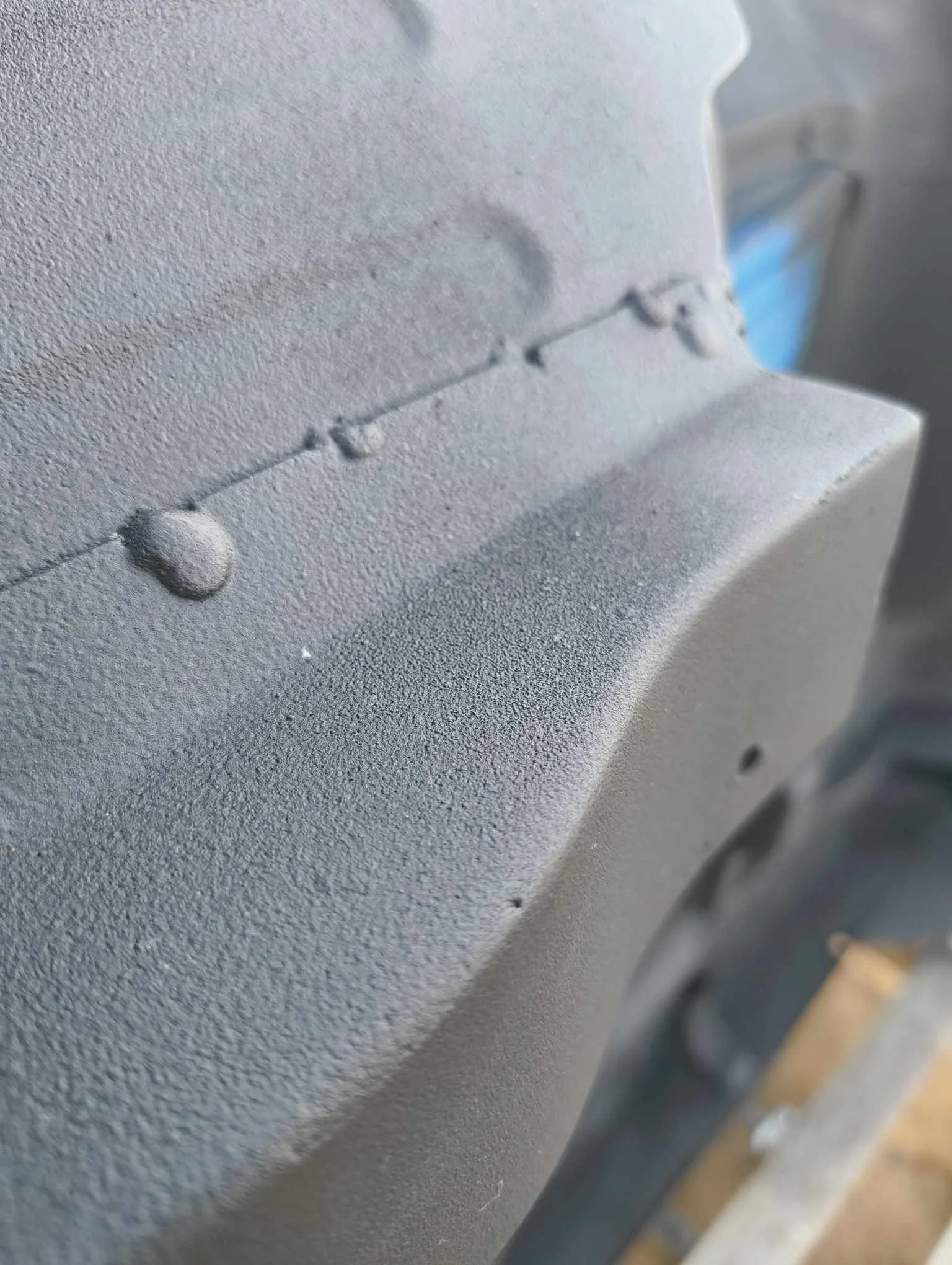

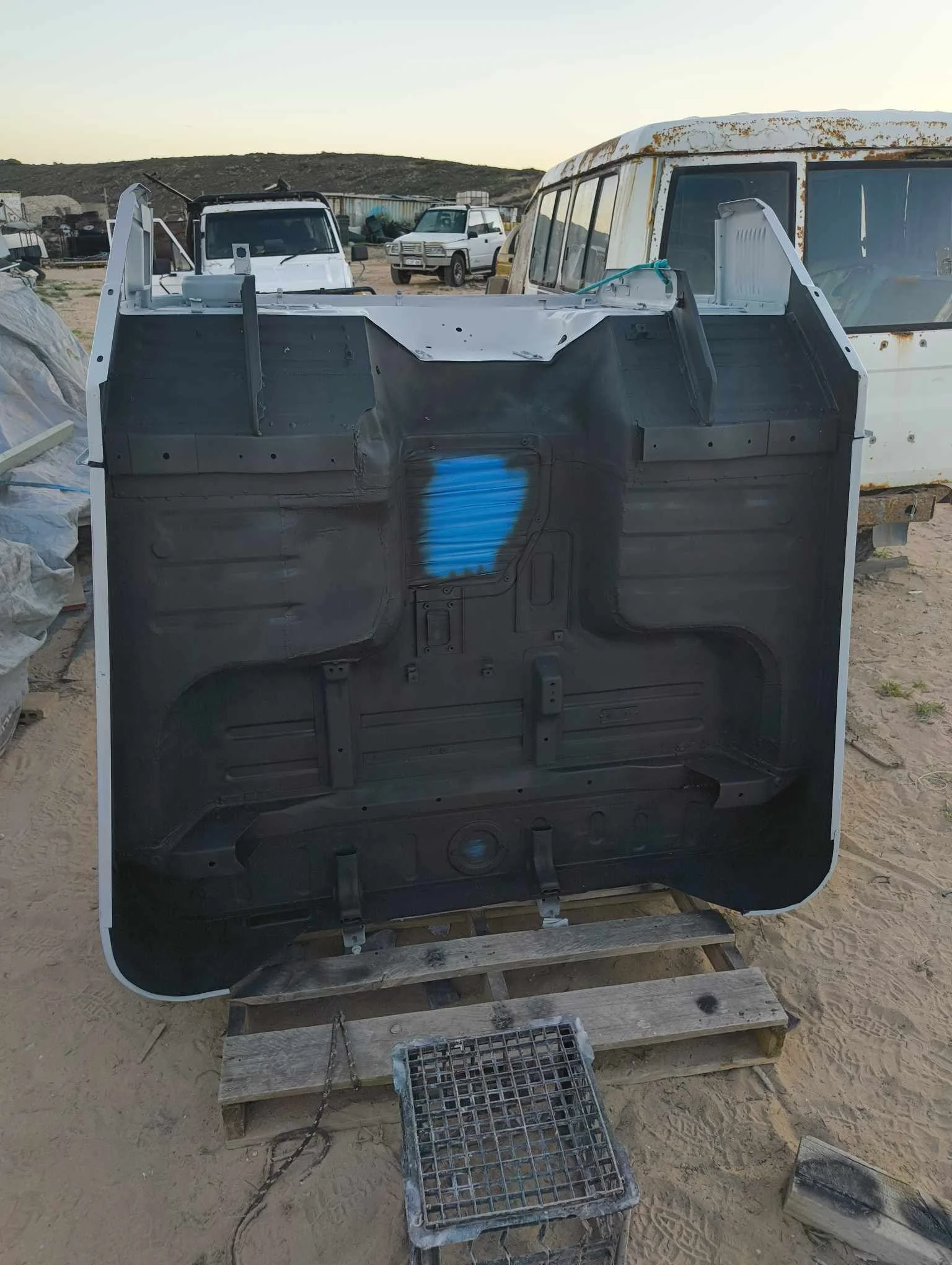

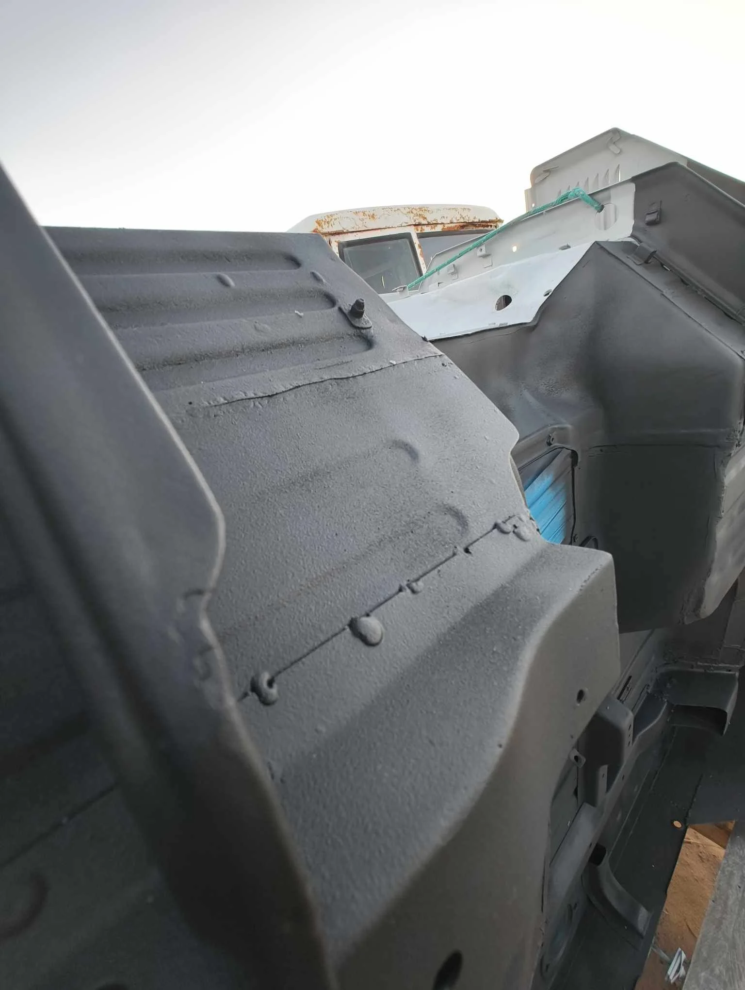

Just thought I'd chime in as I took advice off this post in purchasing the Wurth product for my 40 series underbody... Unfortunately for me I'm really unsure on long term abuse this products going to take and wish I'd gone a 2k bed liner like product and can see my self having issues with it in the future.
I brought it in the ready to go spray can's that say "original formulation" on it at $49.95 AUD a pop got 8 can's of it...
I sprayed it about 12 hrs ago so it should be fully dried...
For me its easily scratched, easily picked off with a nail, I'd hate to bash and sort of tool and scrape it I'm guessing most of the products going to scratch right off...
Mine was applied to a freshly cured epoxy primer that'd been sanded to 400 grit, washed and wax and greased cleaned... Basically couldn't get a better substrate if you tried and still it just doesn't seem up to the task of lasting much longer then a few months not touched.
Attached some photos...
Maybe the version I brought isn't this SKS everyone else uses but for me I'm pretty bummed now my underbody is coated with this stuff that'll come off at some stage, cant easily be removed now to a good base to spray anything over it and although it says it's paintable I question anything sticking to it of loose bits of the rubber and rubbing off from a bit of finger work on it.
I personally would steer clear of it and go with raptor or something if I had the chance to do it again...
