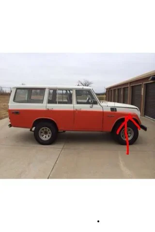

Mine are none existent. And I want to get those flares back. I have heard that the front fender flares are the same as the rear. Maybe look for some front fenders as another approach. Of coarse that is if the 'arches' are the same as what I'm talking about- the flares.

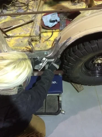

Delancy, did you use the opposite fronts in this photo? I am looking at a similar issue of how to manage the transition from sill to wheel well as the bottom of the wheel well is rusted out.
The "lip" discuses isn't in those photos.
For clarification, the flare or lip in the following is what can be used on the opposing rear side.
The transition in the previous pic is a bear. None of the three I have are solid, so it's being fabbed on the '72, the balance of the surgery consisting of Bob's quarter patches and fender lips from the donor.
