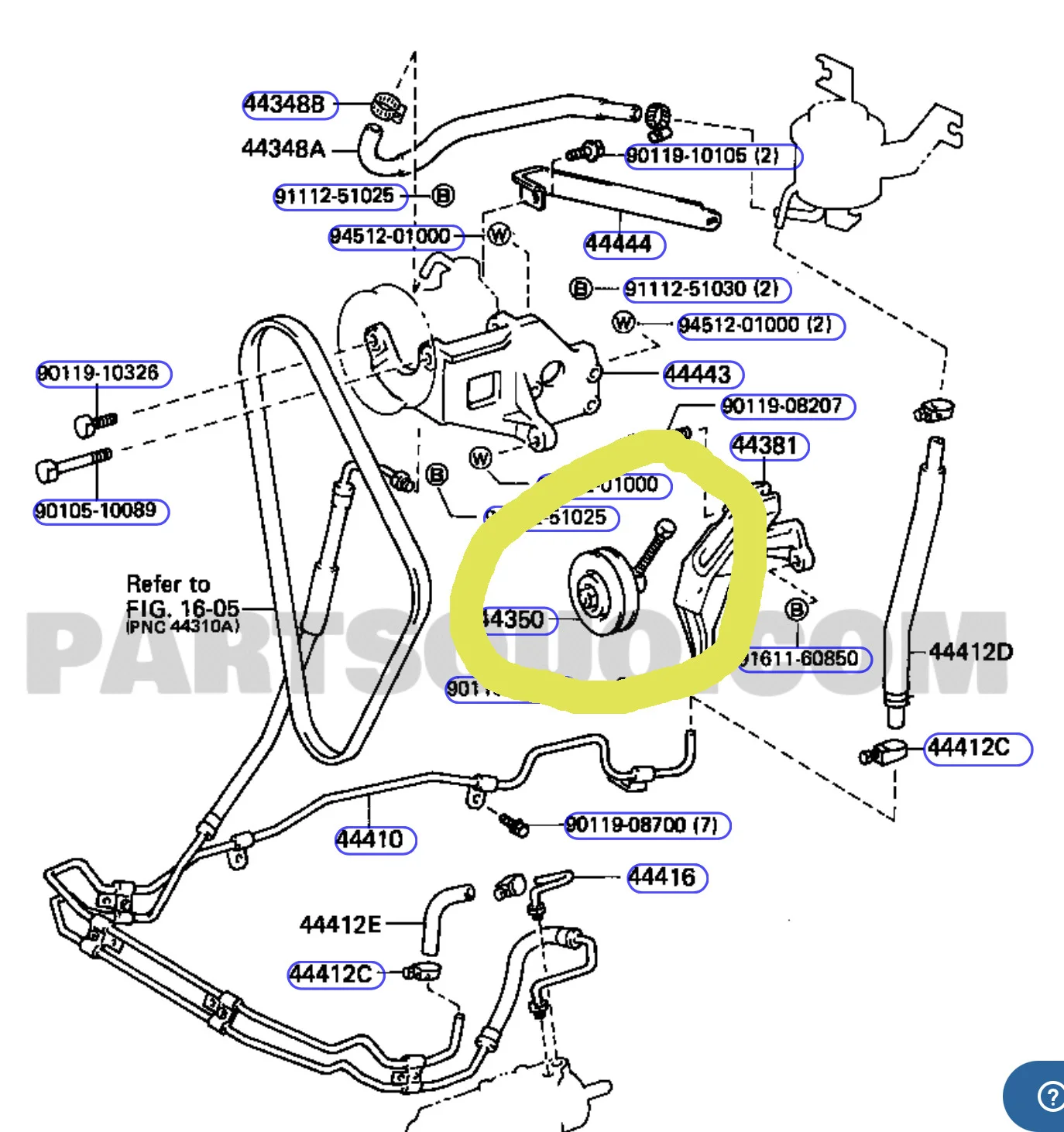

Looking for Toyota p/n 44350-60010, unfortunately it appears they're no longer made. It the power steering idler pulley for the 3B on my 87 BJ73.
One of the high pressure hoses burst while driving, so I took off the power steering belt to make it home without spraying fluid everywhere. Unfortunately the idler rattled off during the drive because there wasn't tension on it anymore, and I lost it on the road 🤦‍♂️

The KOYO part # 63012RSC3 is the bearing that fits perfectly, they are readily available and around $13 US. Found on Ebay, Made in Japan
