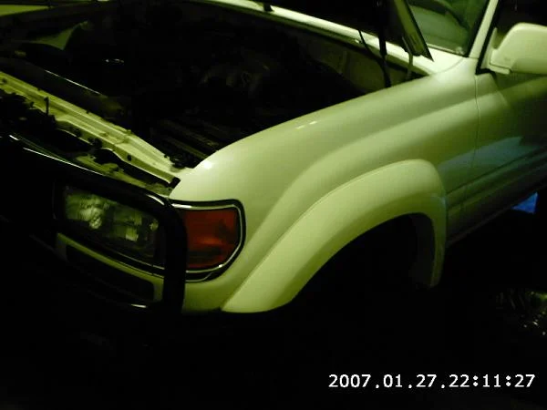

Crappy camera and wrong date.

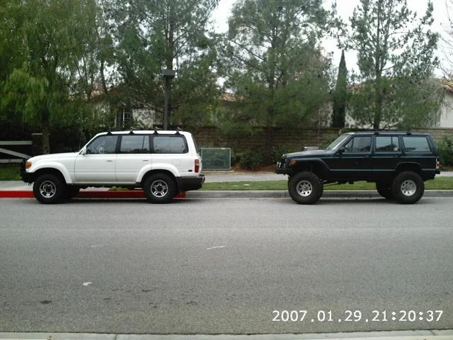

Whats wrong with this picture? No. Not that one. :D
As Paul Harvey would say, "Standby for the rest of the story..."
i think that the white one has 12 dead bodies in the cargo area, the dark one has none. I think you should put 6 in one and the other 6 in the other one to balance them out.
