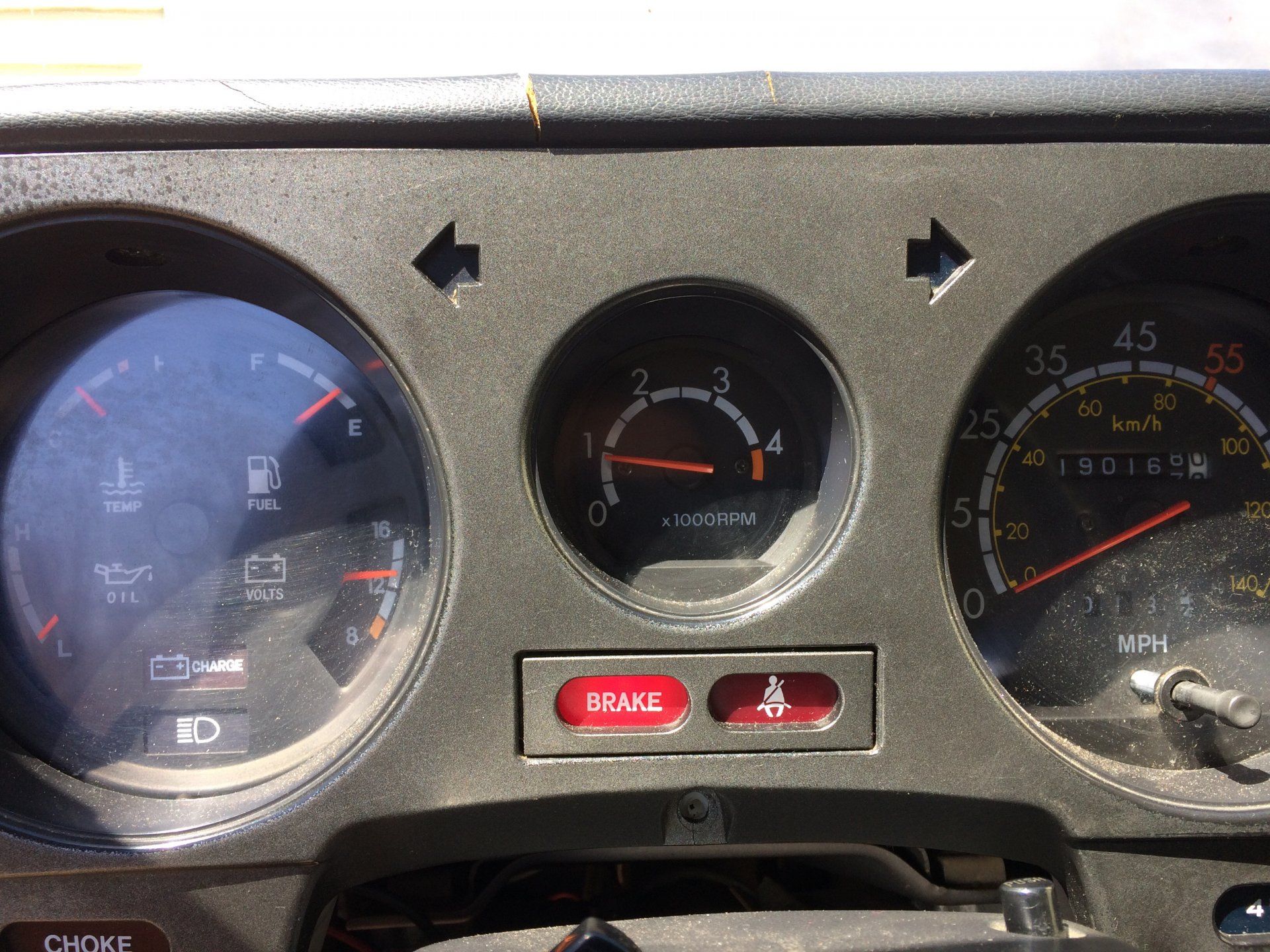

And now while I sit drinking a coffee at a bakery down the street w/ the key in ON so I can listen to the radio I noticed my temp gauge is almost in the red. (And no my carb fan isn't working... seeking one from a guy up north).

Heat soak occurs when engine off, it will get the temp up, but, that is not a good sign. Hmm. You mention the gas was boiling...Can you check temps at front of radiator, top hose, maybe an air bubble in temp. sender at top of the head? InfraRed temp gun can check that.
When you reworked the I/E manifold, did the heat flap get fixed in closed position? (I do not think that is the issue tho).
Before answering the questions above. I looked under the truck just after added that pix. I noted coolant near the left leaf springs and on the frame rail... Followed the path up and could see it came from the overflow on the coolant res. Since then it hasn't done it again but I can check the temp sensor per OS and see how the level is under it. I do not have an infrared heat gun. I recurved my diz myself per Dave (rushing turdle's) directions.
