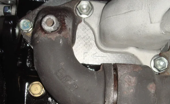

"Since I'm taking my manifold off to check that the 'F' is in the right orientation and retorquing, I thought I'd ask about the new style end bolts on the exh. ears. Spike strip has the same style but don't think yours does. They are black 14 mm hex, and have a raised area next to the washer that digs in as you tighten, the others are 17mm and look normal. The manual calls for 33ft lbs for all, but it would seem like the 14mm should be less"
There is no need to take off the manifold to see the embossed 'F" on the manifold gasket. The "F" on the latest Toyota manifold gasket can clearly be seen when the manifold is installed... I don't know if the old ones had the "F" or not.
The two smaller TOYOTA end bolts on the manifold are hardened bolts designed to take that torque and the heat of the manifold. I wouldn't recommend ever using an aftermarket bolt to replace those... asking for trouble that's for sure.

@Output Shaft thanks for the info. How will I see the embossed F, in Beno's pic it looks like it would be hidden. I haven't looked but will later this afternoon to see if I can see it. Bought everything ummm sometime in the spring or summer...

It was on backwards! seemed symmetric when I looked at it but flipped it and it gave me a chance to put anti-sieze on the bolts and get those end ones torqued properly. Now the F and arrow are visible. Thanks all
