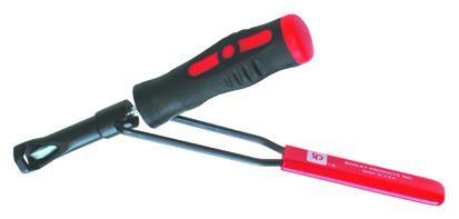

This tool makes it much much easier - you can do it with two hands instead of 2.5 - if you have 12 mm adjustment nuts on the rockers. Earlier 2Fs have 14mm.
I've seen them a Autozone, etc. It's a knock-off of an expensive Snap-On tool.
Amazon.com: Valve Adjustment Tool 12Mm Jam Nut: Automotive
