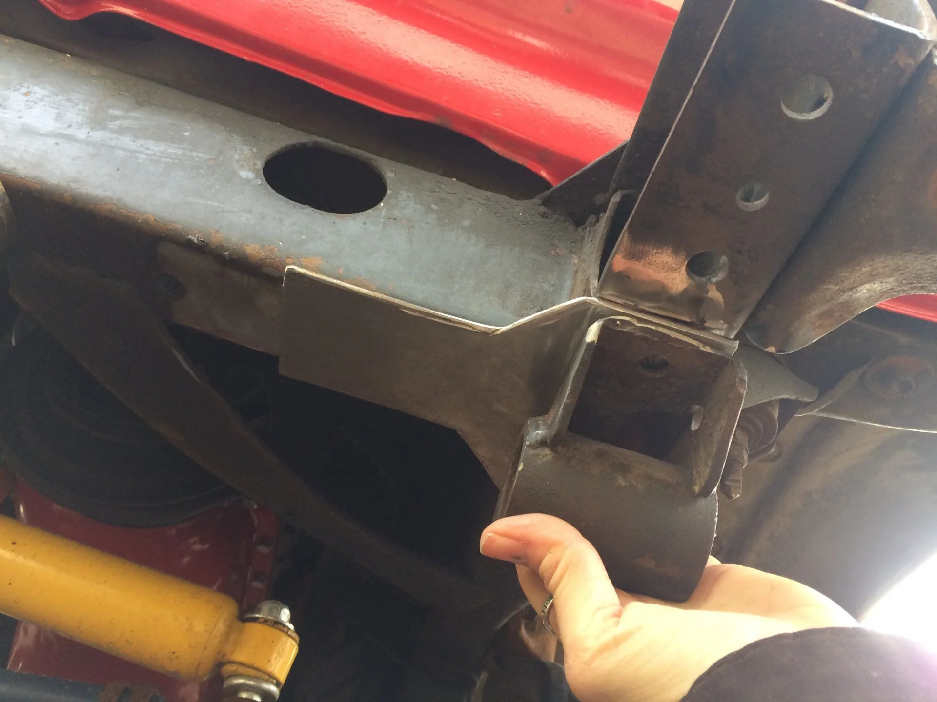

Some of you saw this thread I began recently on my front driver shackle mount which I found to be less than ideal. Here’s the link for how I was assisted in fixing it.
Front Driver Shackle Mount

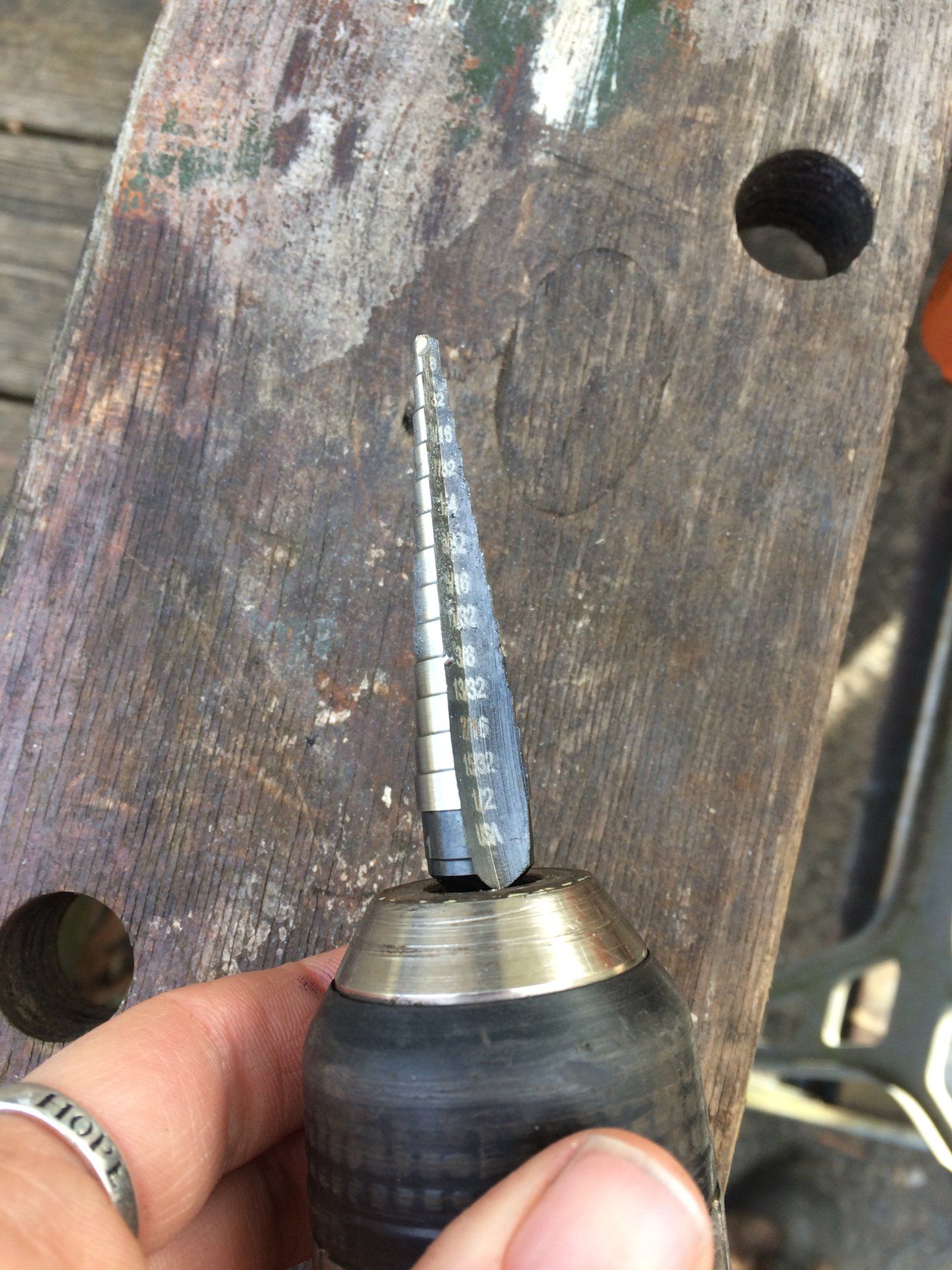

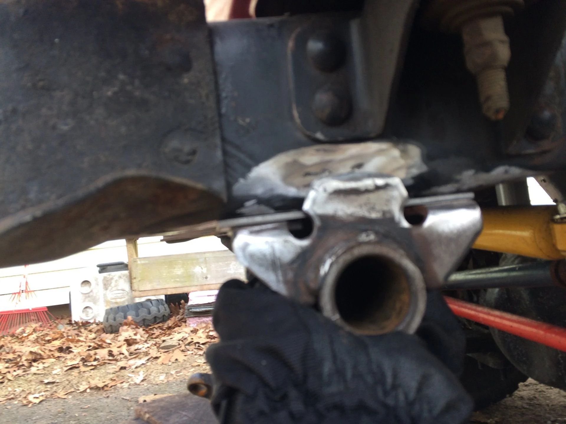

So far this is what I’ve done today on this delightfully cold started out at 9:30am, 16 degree day here in CT. Made a cardboard pattern of the old plate and noted a captured nut (8x1.25) in the crossmember so I kept that in as a potential anchor point. Then I jumped in and started cutting. I cut the metal plate longer and wider to compensate for any screw ups. Thanks to the welder who hooked me up w/ the metal he also told me to buy a Unibit to drill the holes. What an awesome little tool. Well worth the $20+ price!
I’ve yet to drill in the crossmember. I believe it makes sense to drill about where the X is in the pattern. If anyone or @FJACS or @cruisermatt have a better suggestion on strength of those points please tell me what you think?
Unibit from Dewalt.

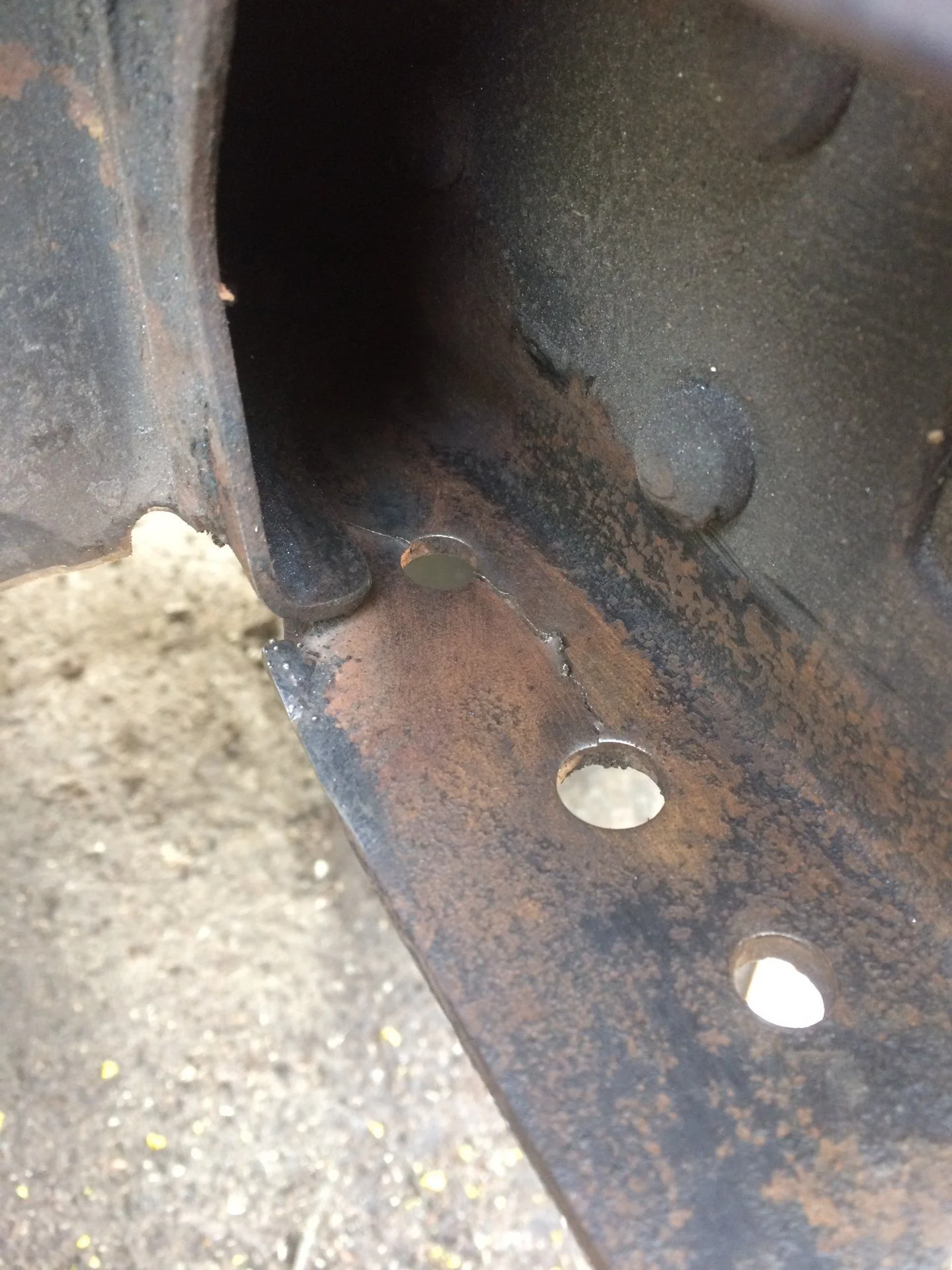

And I’ll be laying a bead of weld along the top of this crack in the frame... Thos too shall pass. :)

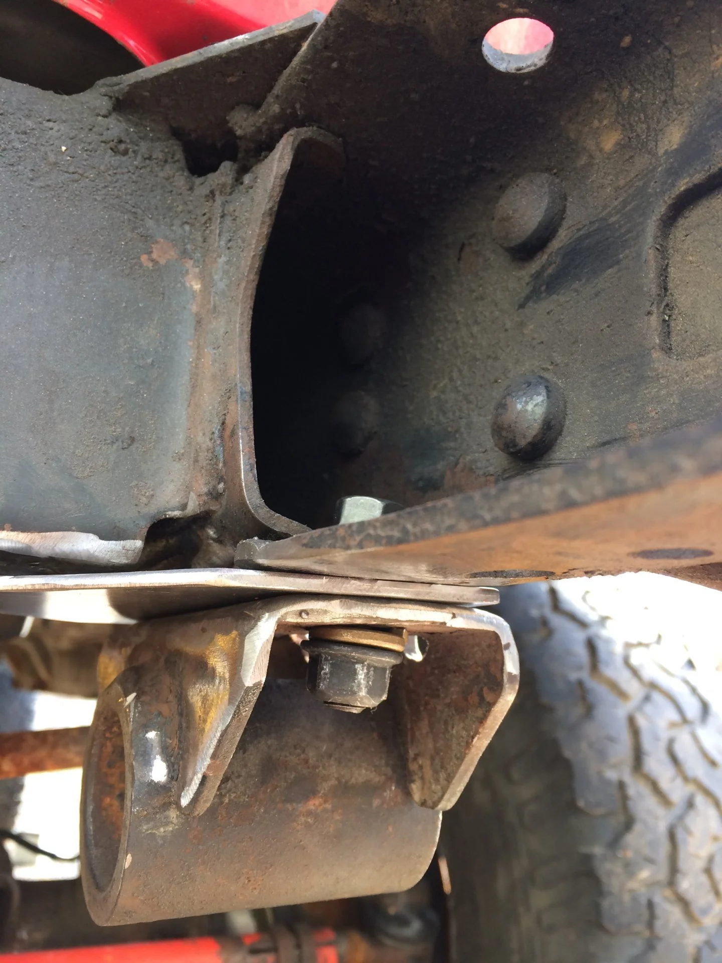

Grabbed some grade 8 flanged bolts, lock washers and nuts from Ace. Test fit looks good.
In now (temp has gone up to a whopping 26) till work at 3pm.
Nice prep work. Looks good. Burn it in. Also just be wary of keeping the hanger relatively straight with the frame. The straighter you get it the easier it will be to install the shackle/spring.

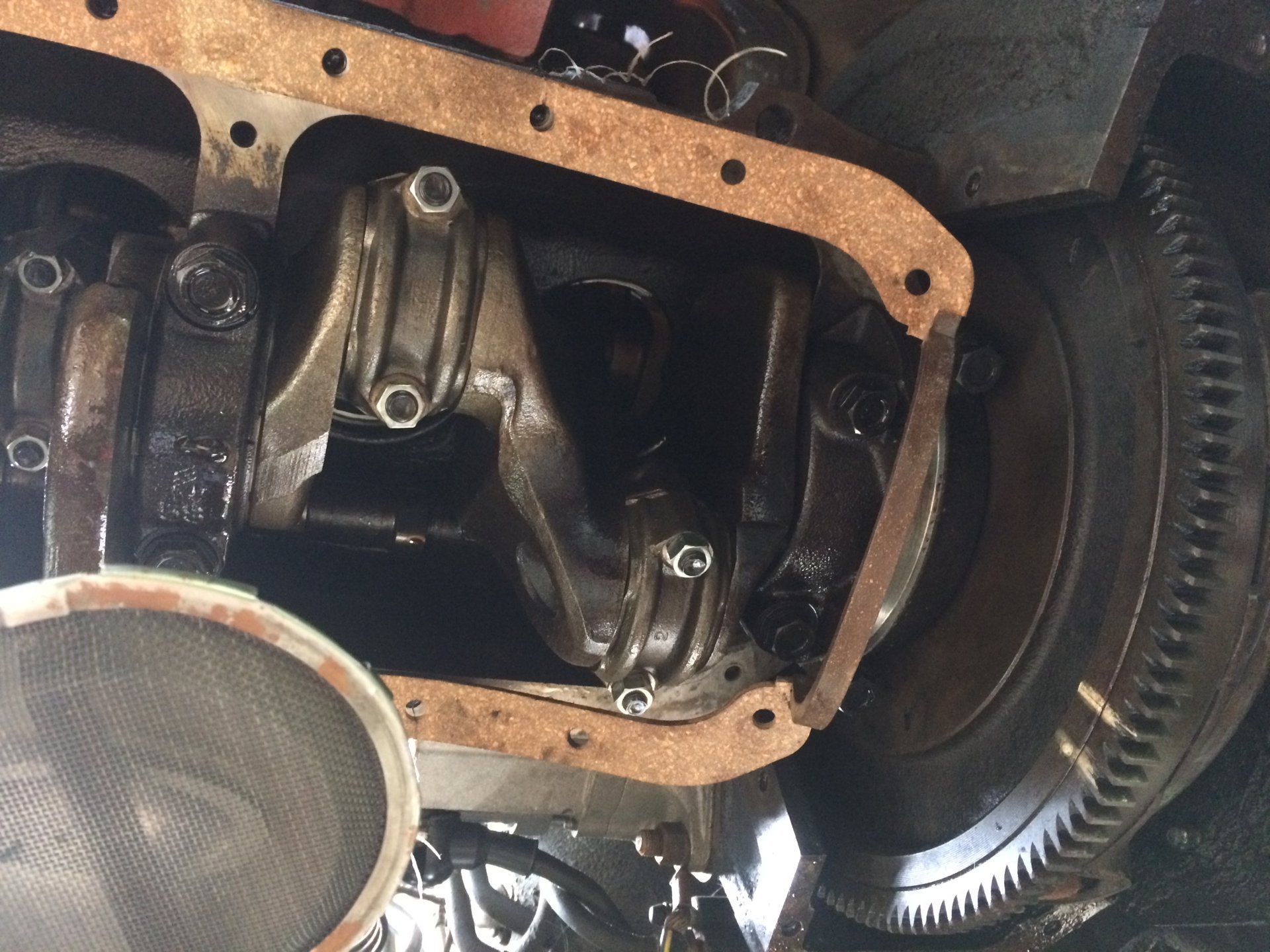

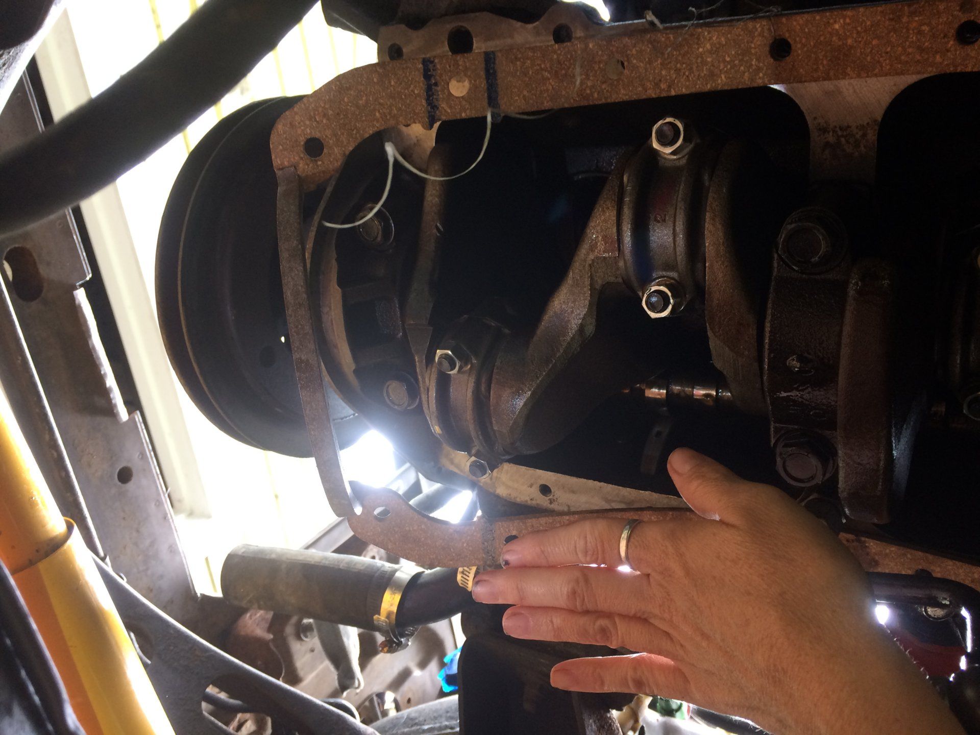

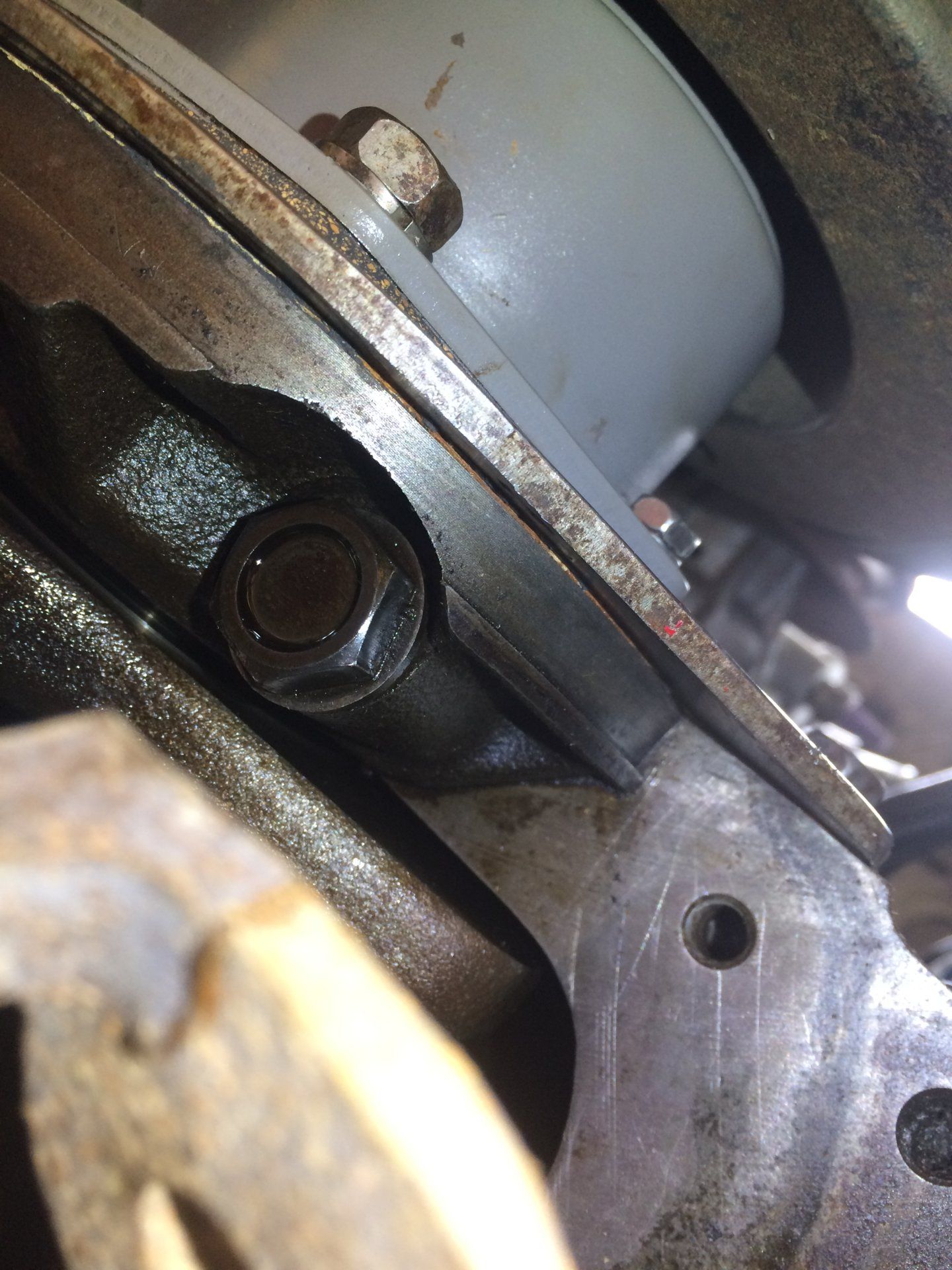

Ok so my plan is to keep the gasket tied by floss to the block. I can bend the arches down to add sealer, let it set up slightly tacky then push up, add two screws to hold the corners enough so it won’t pull away. Then I’ll add sealer on the outer arches, let that set up tacky then pull the corner screws, press up pan and add a few screws finger tight for say 30ish minutes then tighten further.
My reason for going this way and not gasket to pan then to block is that the maincaps have a C shaped inverted lip for the gasket to seat up into. IF I go the lesser route, gasket to pan then when pushing them together and up I will NOT be able to be 100% I’ve got the arch in the inverted C of the caps. Yes the cork is stiff enough that they’d tip and I’d know I wasn’t flush but once the pan is up I can’t get my hand inside to shift the gasket into the channel.
There you have it. Here’s a few photos while I get up the courage to add sealer. And since I DO have a brand new tube of FIPG, I’ll use it instead of the ultra black tube which is only 1/3 full.
