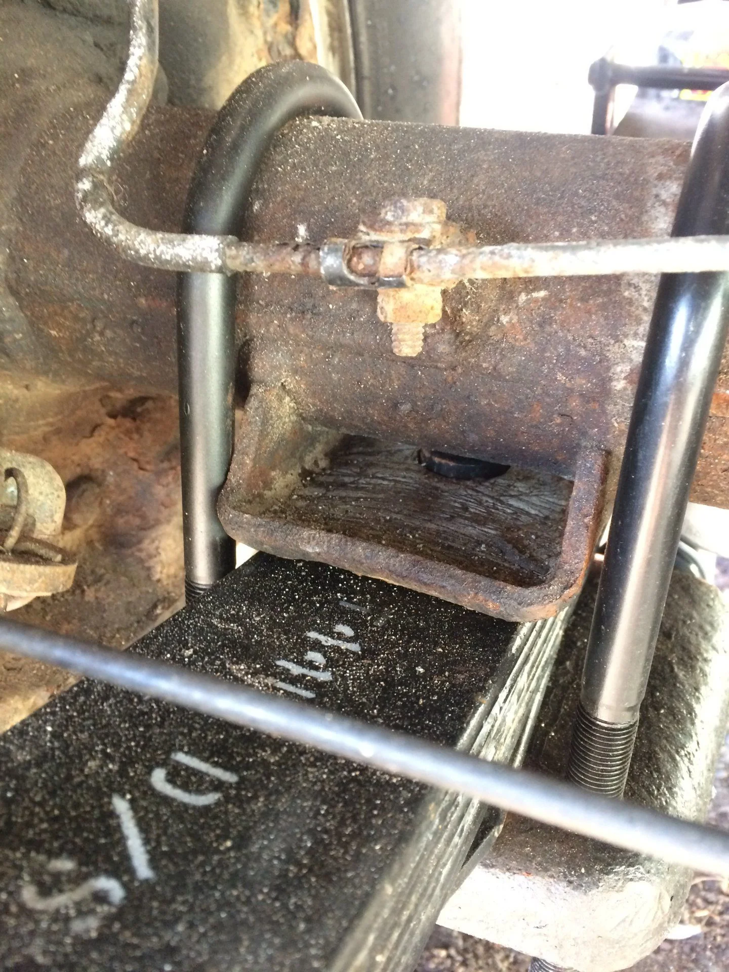

Also, I don't remember if I've already told you but your frame and axles are really not that bad. I've repaired some Canadian trucks that were a ton worse and they are still rolling. That being said, looking at that short section of brake line in the first picture in post #2063, You should definitely do a thorough inspection of all your steel brake lines (and rubber too) and replace any that look rusted like that. Brake tubing is very thin and I have had lines with rust like that split under a moderately hard brake. Go for 100% copper-nickel line and be problem-less and happy forever.
Nice. It is going to drive a ton better with legit non-universal shackles that aren't seized up, and fresh shocks. Make sure you don't completely tighten any of the spring bolts until it has the weight on the spring. You want those bushings to be compressed in the position they'll be in 99% of the time (ride height).
I don’t want to talk about my frame. It’s not as good as you think... and to go about patching it I have no choice to pull and most def replace the fuel and brake lines along the pass rail, esp if I’ll be welding on it. I’ve got copper/nickle line already... it’s now a matter of getting myself in gear and winter is just getting going here in CT. Not sure but all that might have to wait till early spring.

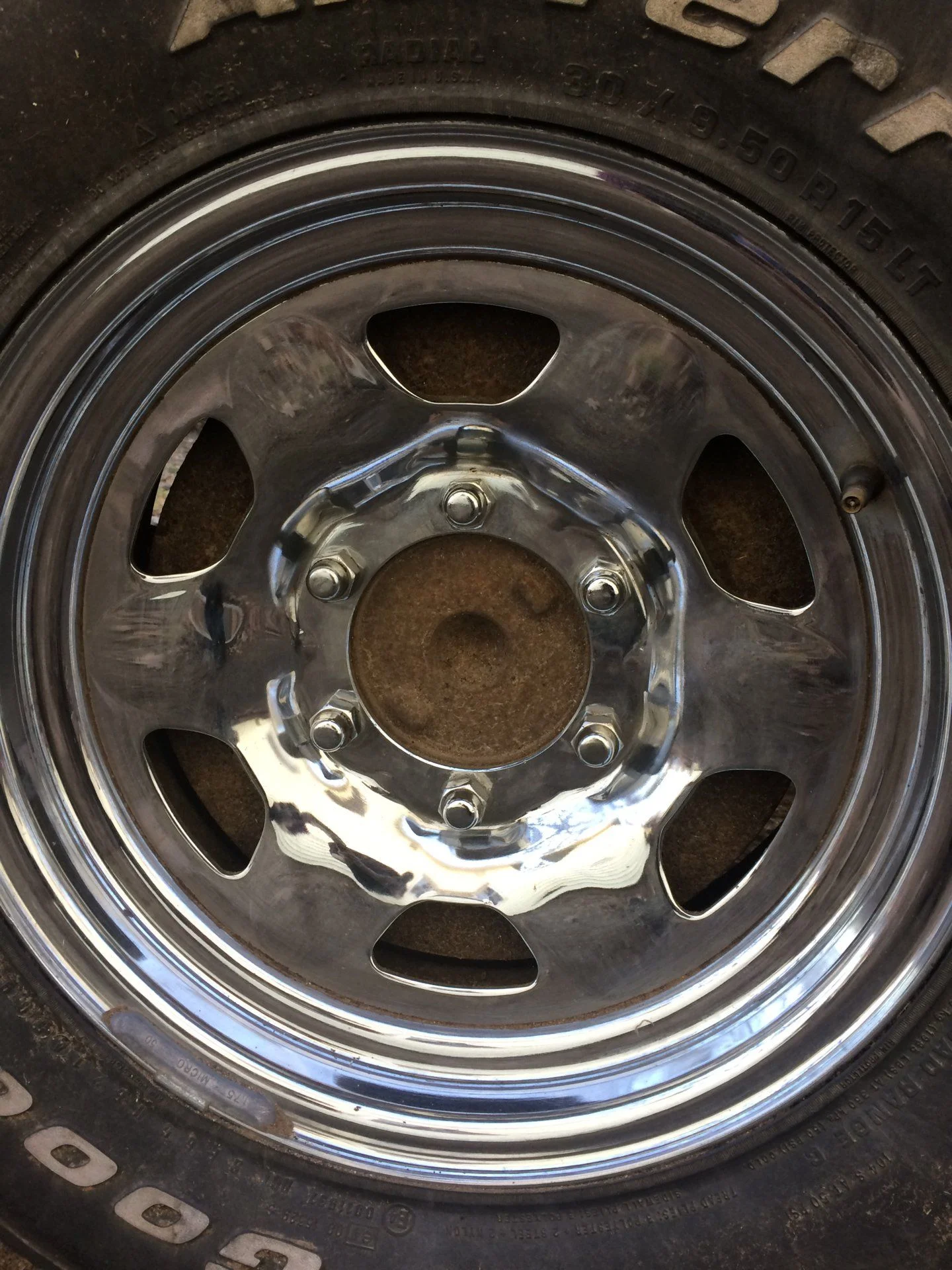

Stock T caps. Found them via Sigfrid on Facebook yesterday. They’ll look nice once I get my rear brakes refreshed.
