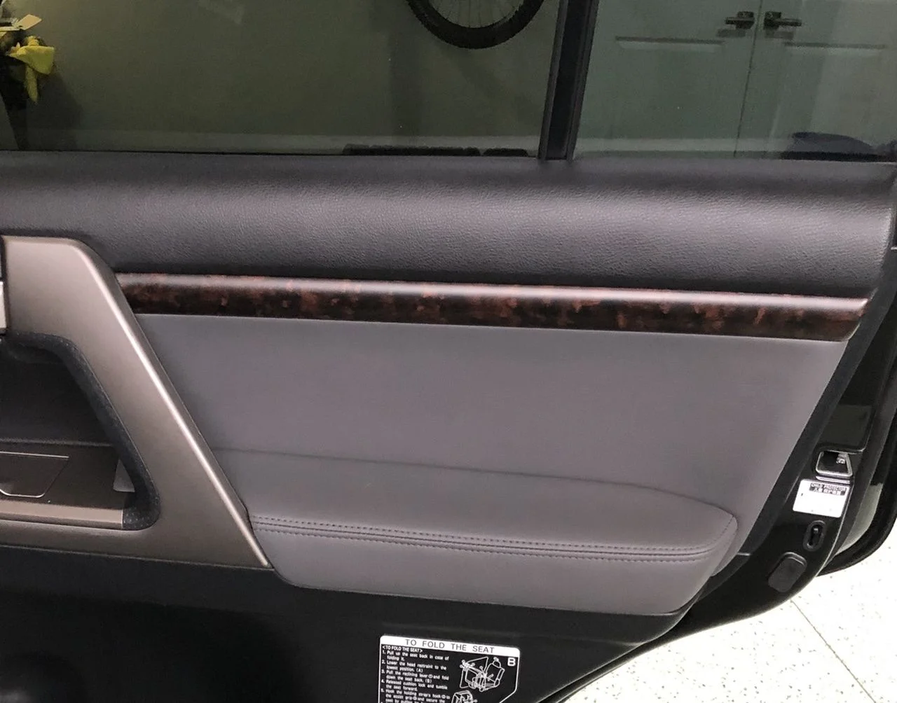

I’m painting all my wood trim matte black to match my black 200. How do you remove the wood trim from the doors? Do you have to take the whole panel off? Thanks!
Yes. The panel must come completely off, then you will see a few simple Philips screws that hold the wood to the panel.
Side note, except for the steering wheel, all wood can be complete separated from panels or chrome trim.
