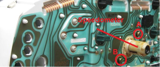

It is either your speedometer cable or your speedometer. The speedometer on your instrument panel is essentially a VSS and sends the signal to your cruise.
To see if it is your speedometer you can pull the gauge cluster and see if there is continuity between terminals A and B. It should be 4 times for every revolution of the speedometer shaft. Hope this helps!
Hey thanks...that helps a lot. I couldn't figure out where the link between the speedo and cruise was. Am I correct in thinking that if the issue with the cruise doesn't occur until the speedo starts to bounce around, chances are it is the cable and not the contacts in the speedo?
If I had to guess, I would say it is the speedo cable. Since you would have to pull the gauges to replace it you could test the speedometer then.
