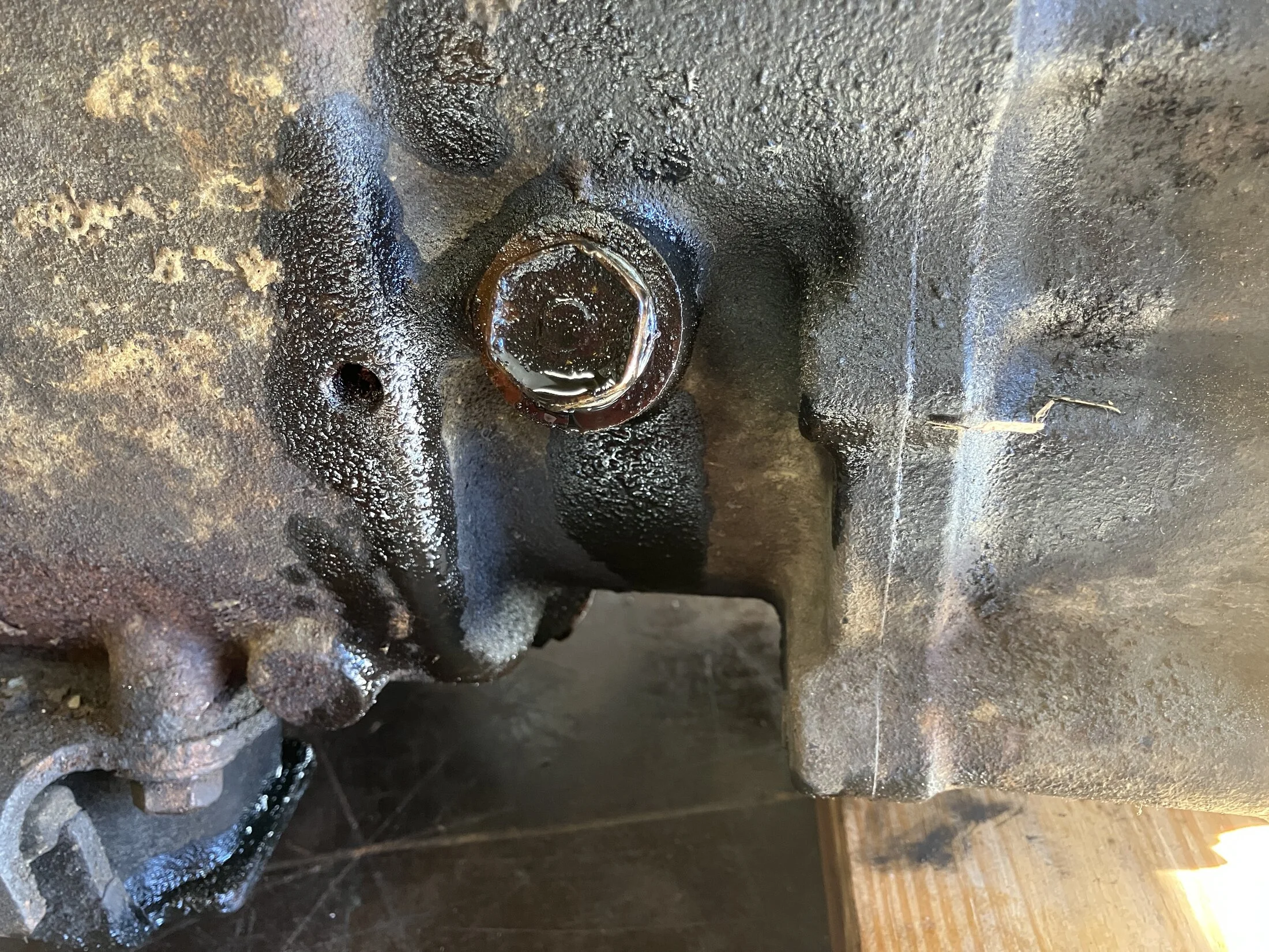

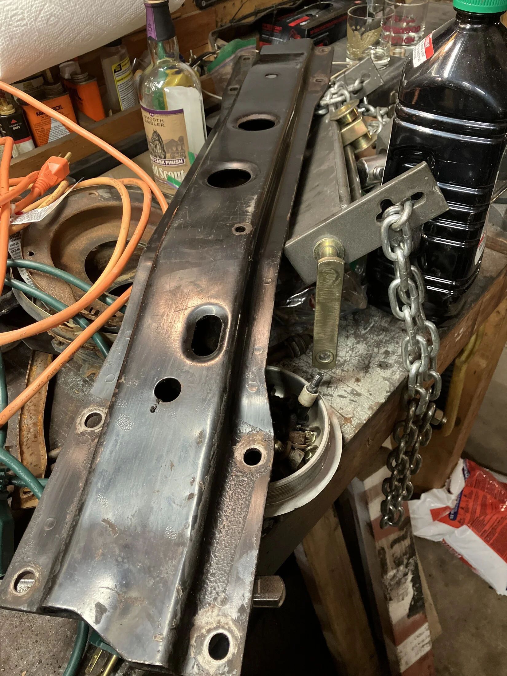

Sorting, stacking, moving, rearranging, and stacking some more doo dads and I get to have a look at the transmission/transfer case. Cleaned up the transmission cross member and placed copious amounts of gear oil from the transmission fill plug on the workbench and floor of the garage. Ordered the banjo bolt/fuel hose temporary fix.

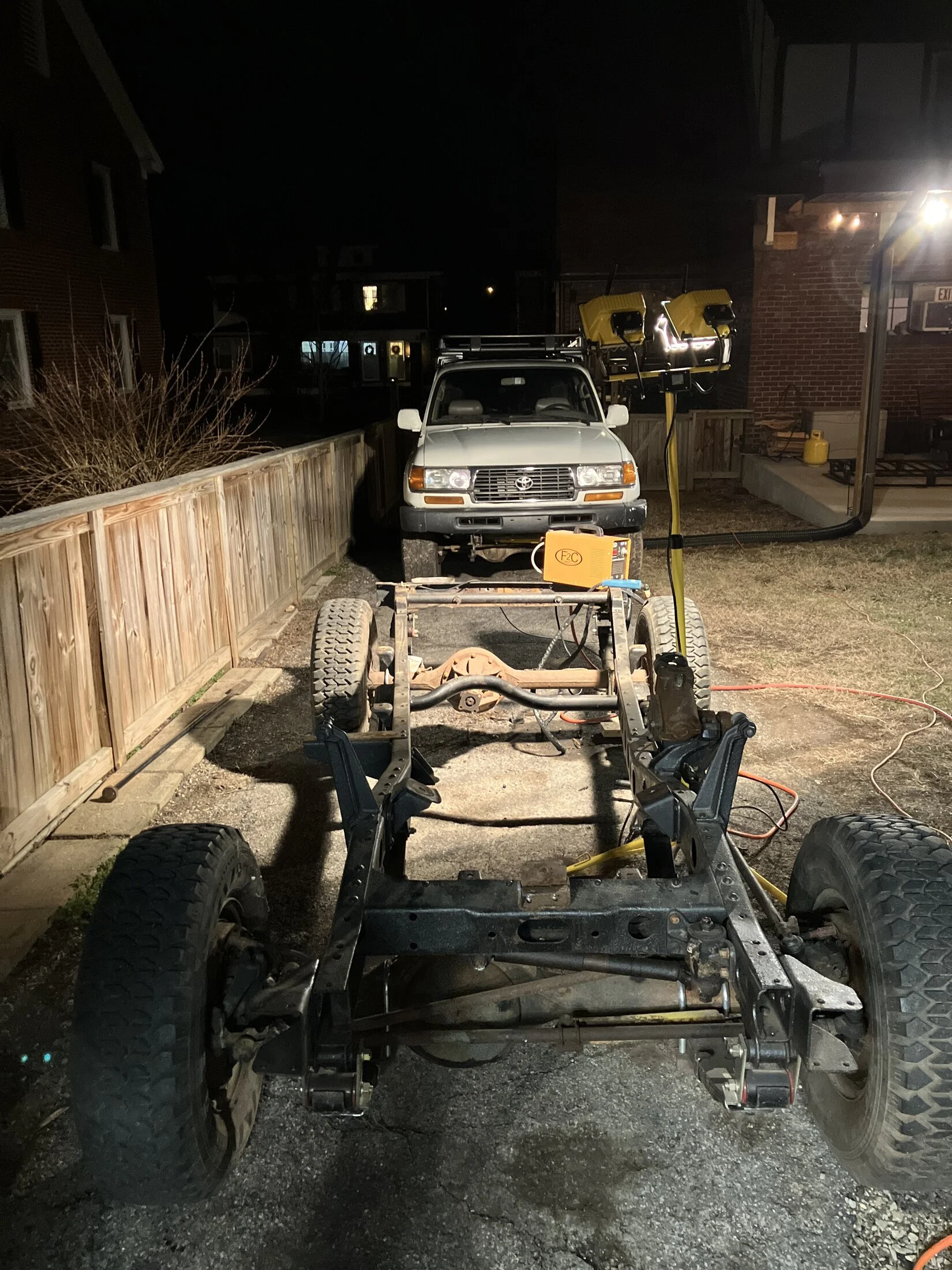

Get her flipped around after this picture last Tuesday (thanks to Stephon and Joe popping in). Engine hoist and ratchet straps ready for tonight. Hoping to separate body from frame. Bringing the 60 rear axle home to start cutting things off to mount perches.

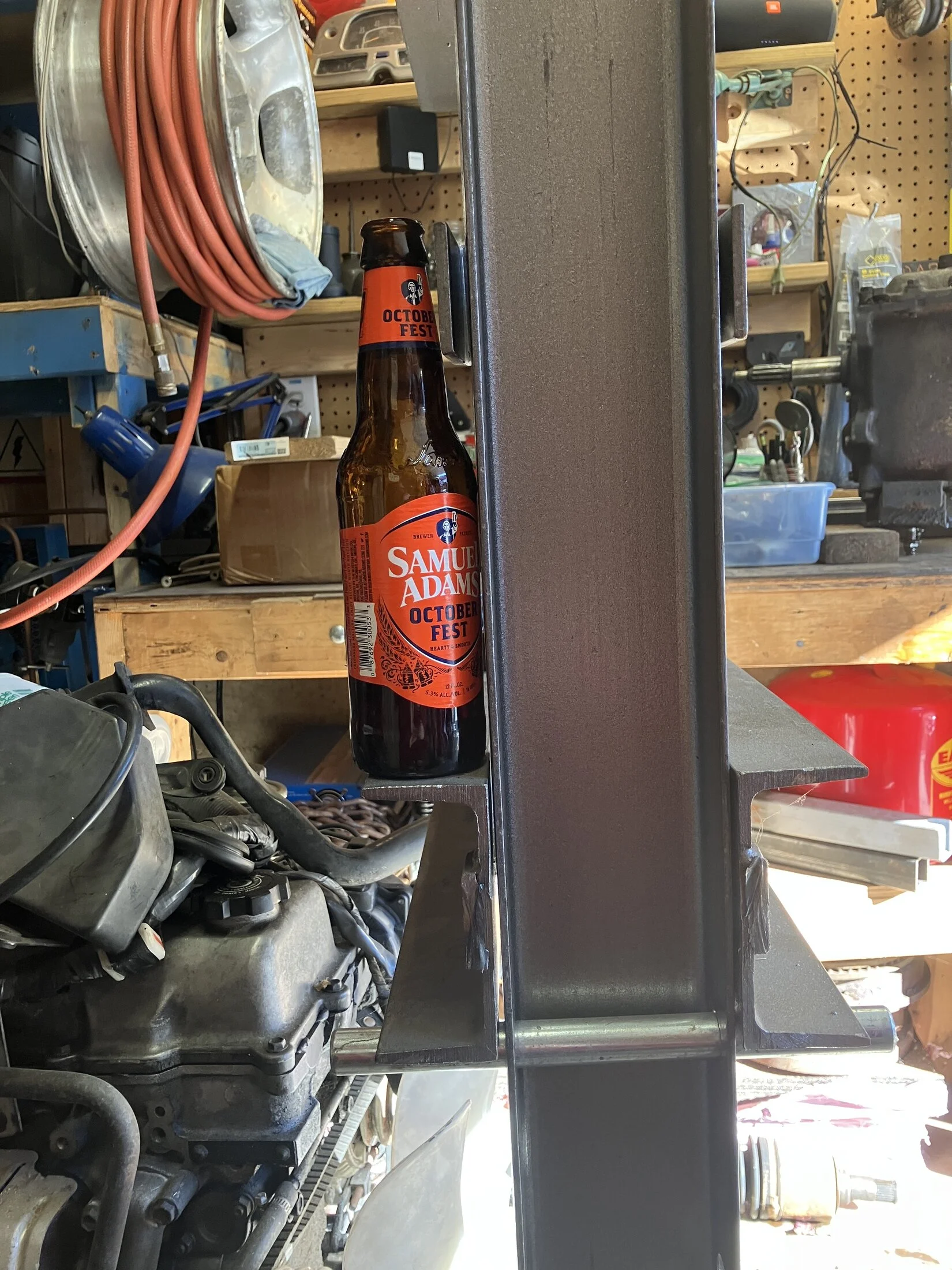

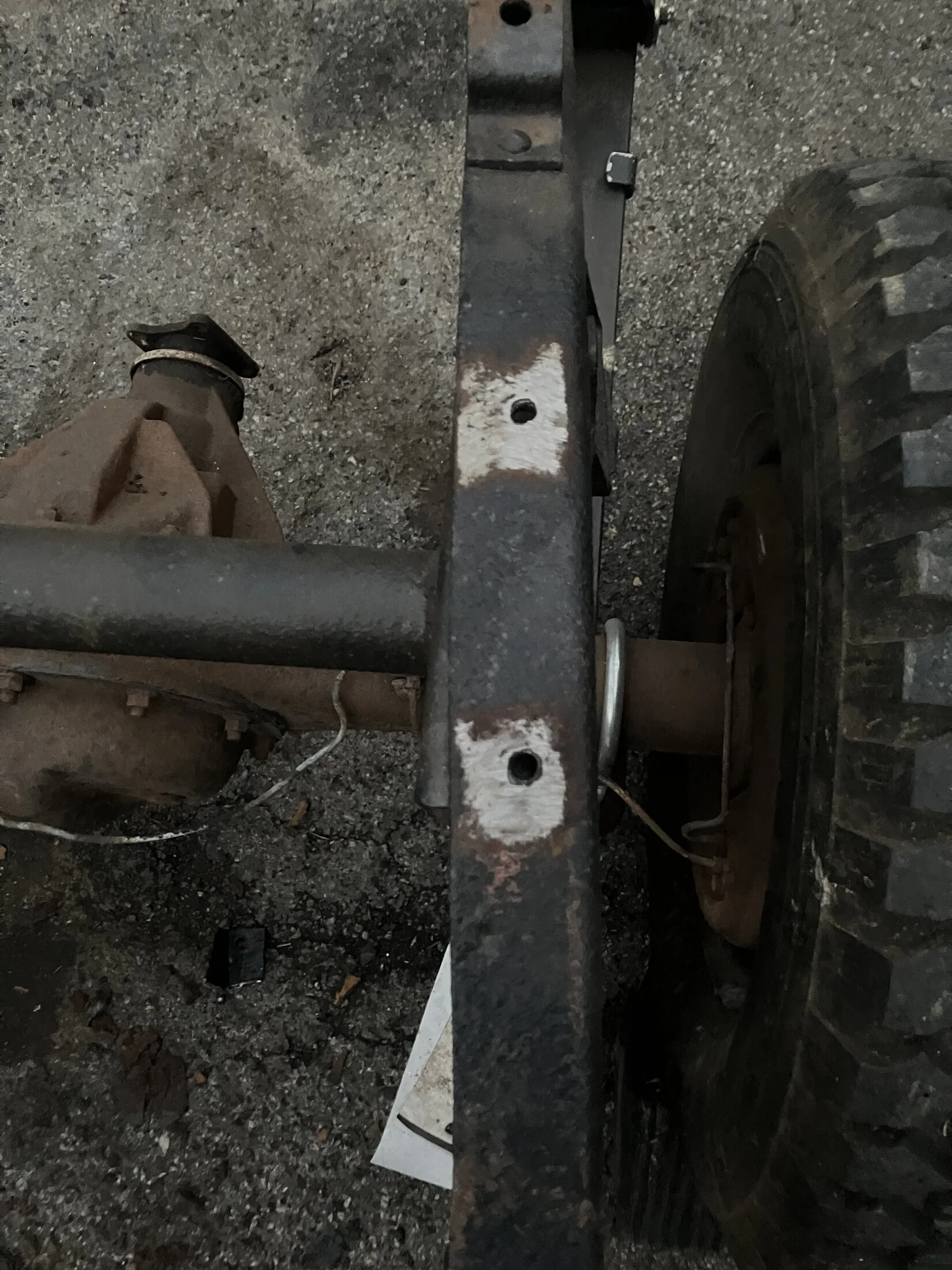

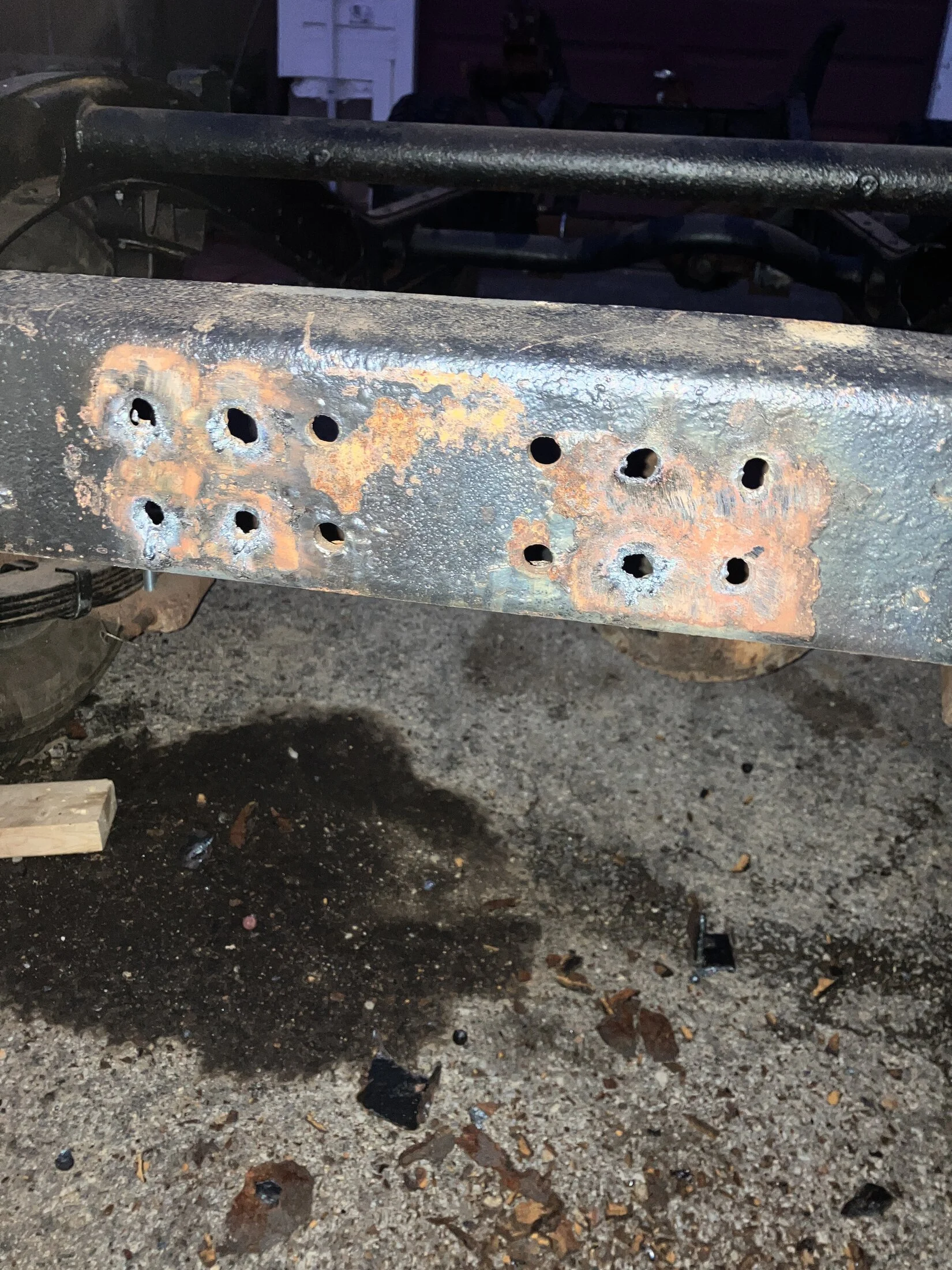

With my advanced middle age, I just want to drive the thing once before I check out. Plus, this gets me moving in the right direction. 32 of the 36 hot rivets removed with the Chinesium plasma cutter. Ruff Stuff rear boxing kit in hand. Crossmember mount on deck
