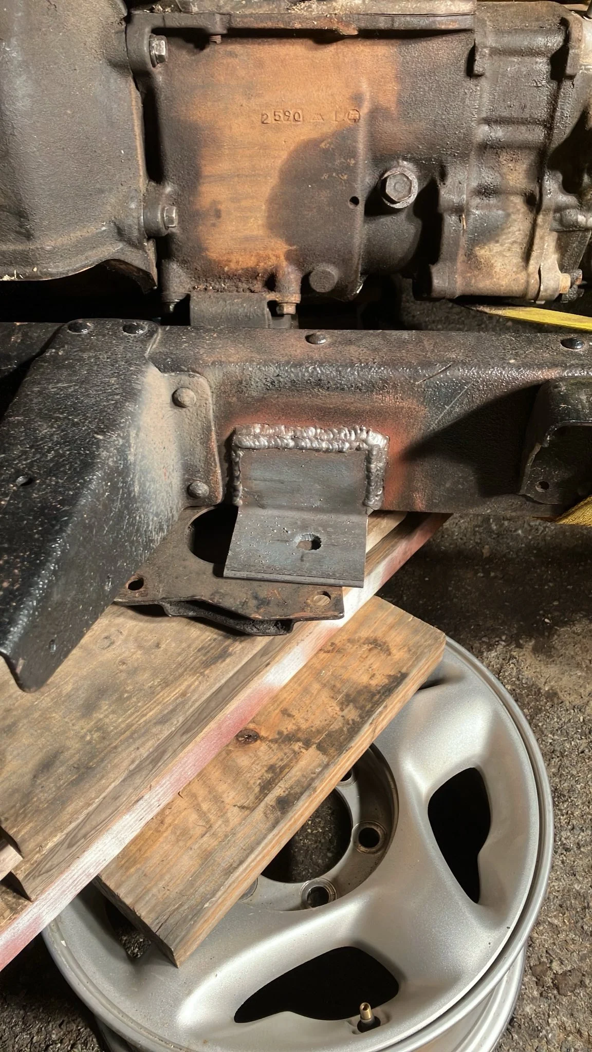

Engine in. 60 cross member attached. Metal glue gun attached a few things.

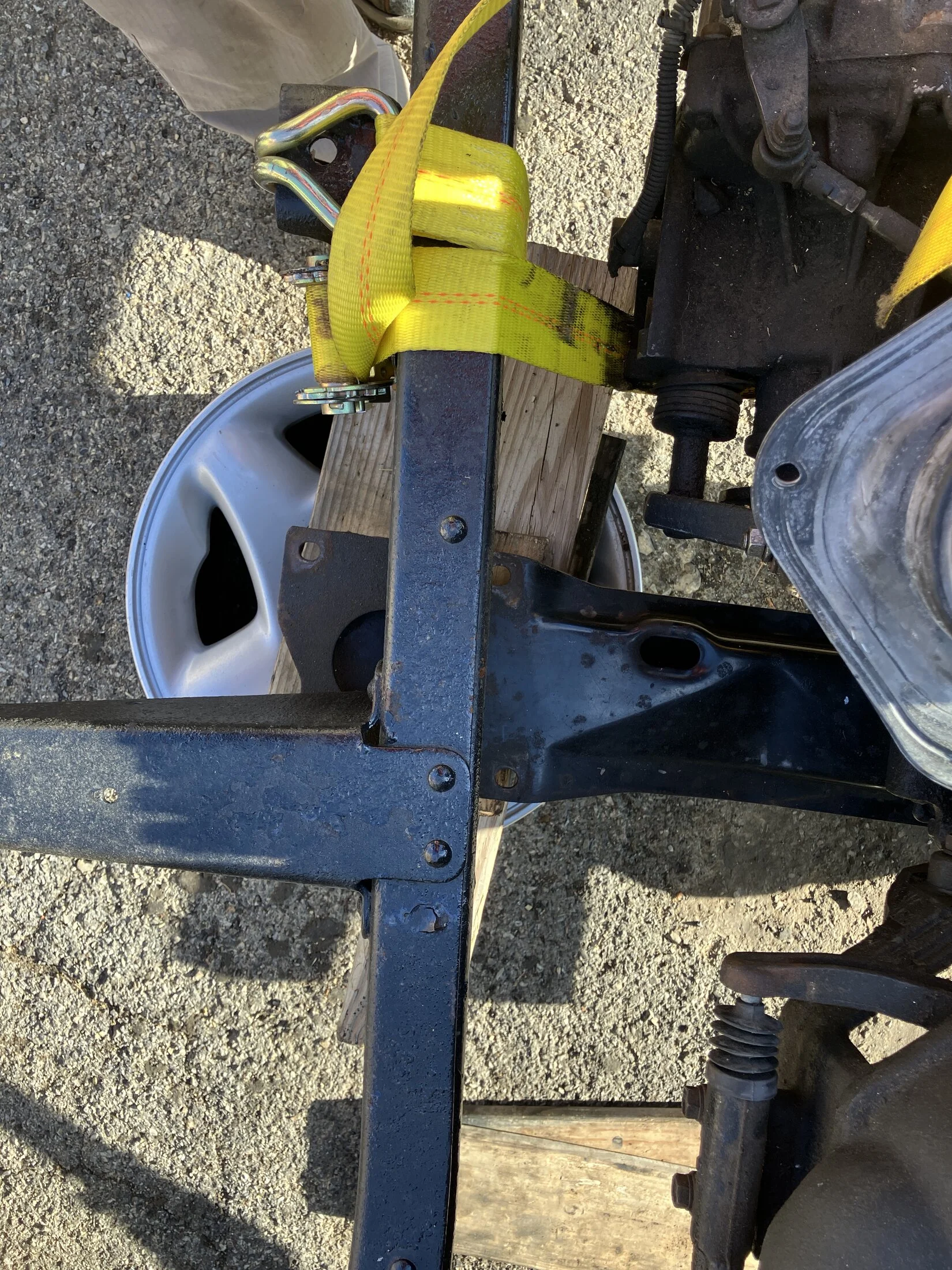

60 series crossmember for the transmission and a little hot glue gun action. I am in business.
All buttoned up for now. I was able to remove the bracing holding the transmission up and have everything bolted to the frame. It will be beefed up in the future but for now, I am on to the rear axle. Perches purchased, plasma and grinder taken to the 60 series rear axle (thanks to my neighbor and his need to destroy things), money depleted.
