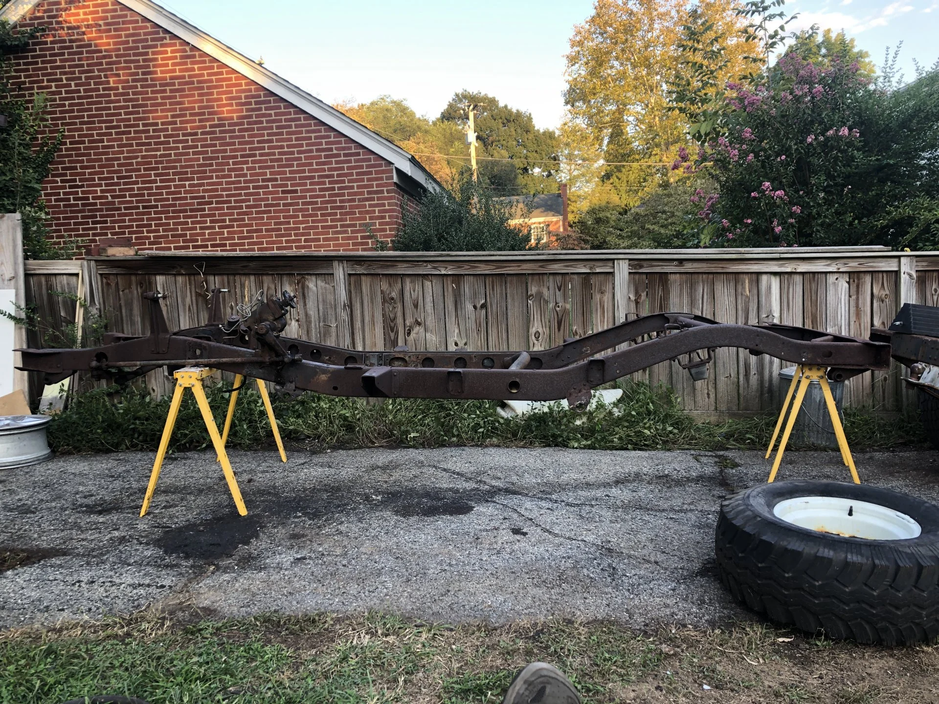

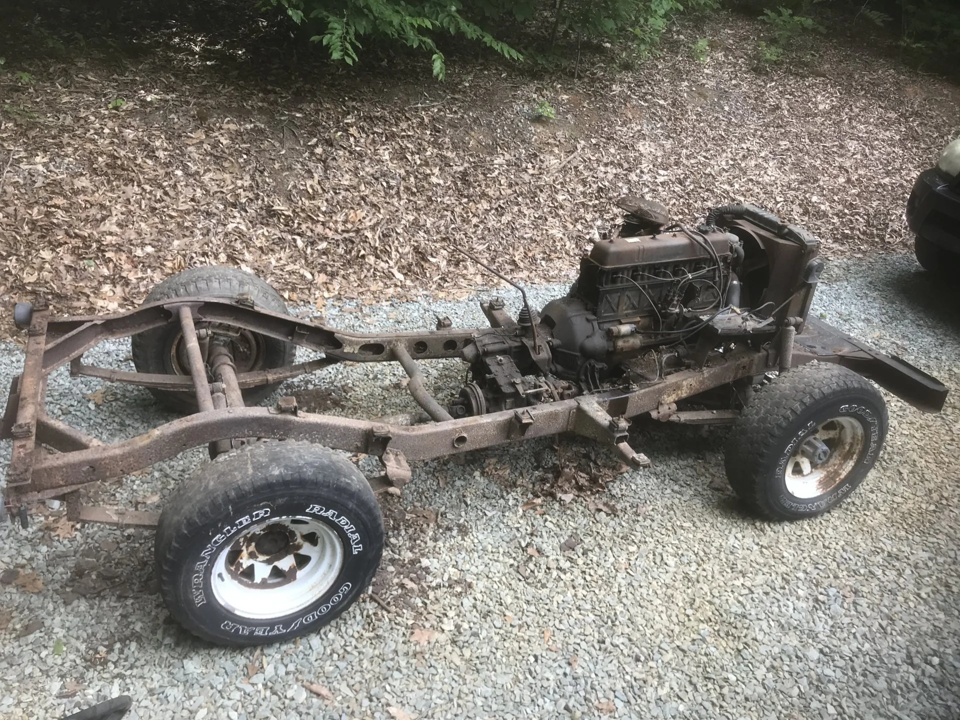

Without further delay and because I too am a visual learner, here is the 1973 rolling frame that begins our journey.

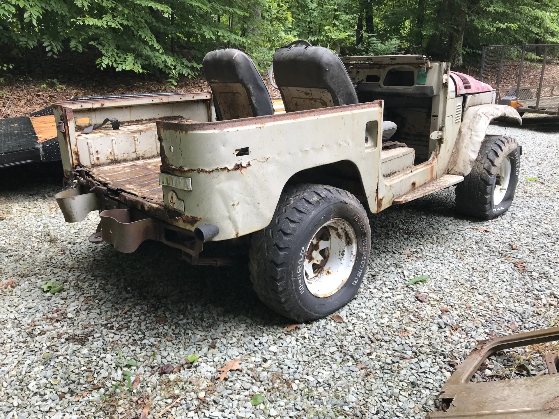

The second specimen is a fine 1975 version deftly stripped of anything of resale value. I see it as a blank canvas that will remain as blank as a stare from the bar room drunk at last call. Ain’t she a beaut!!

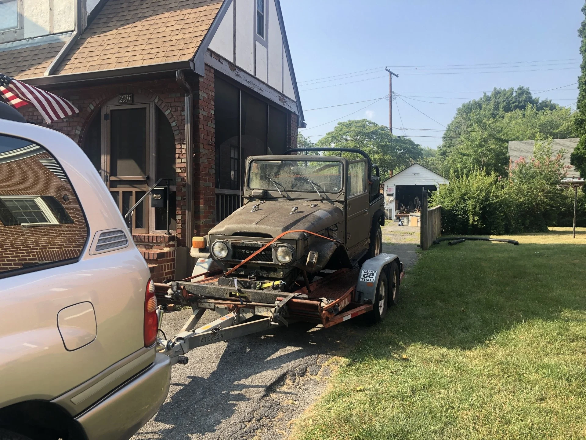

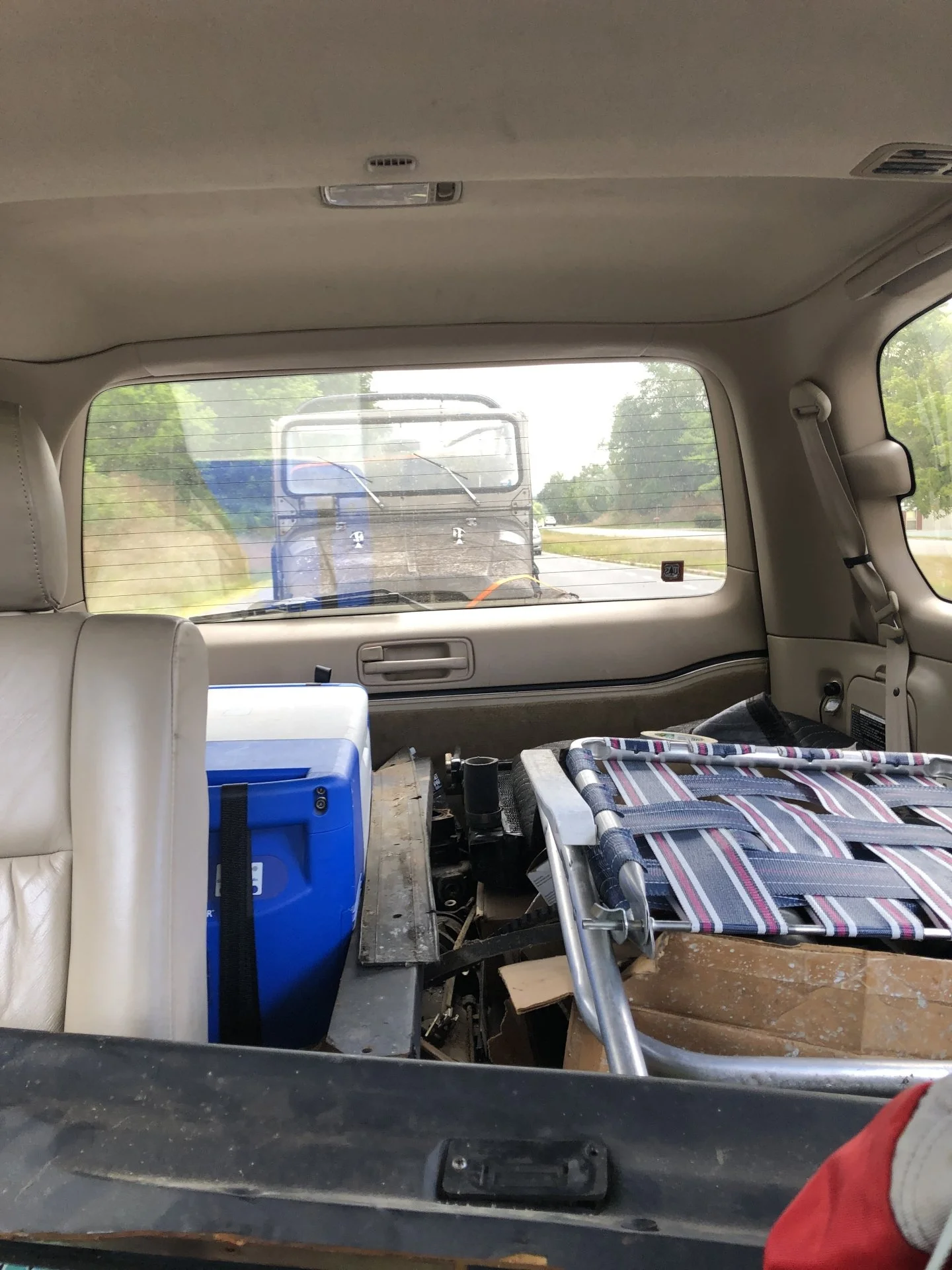

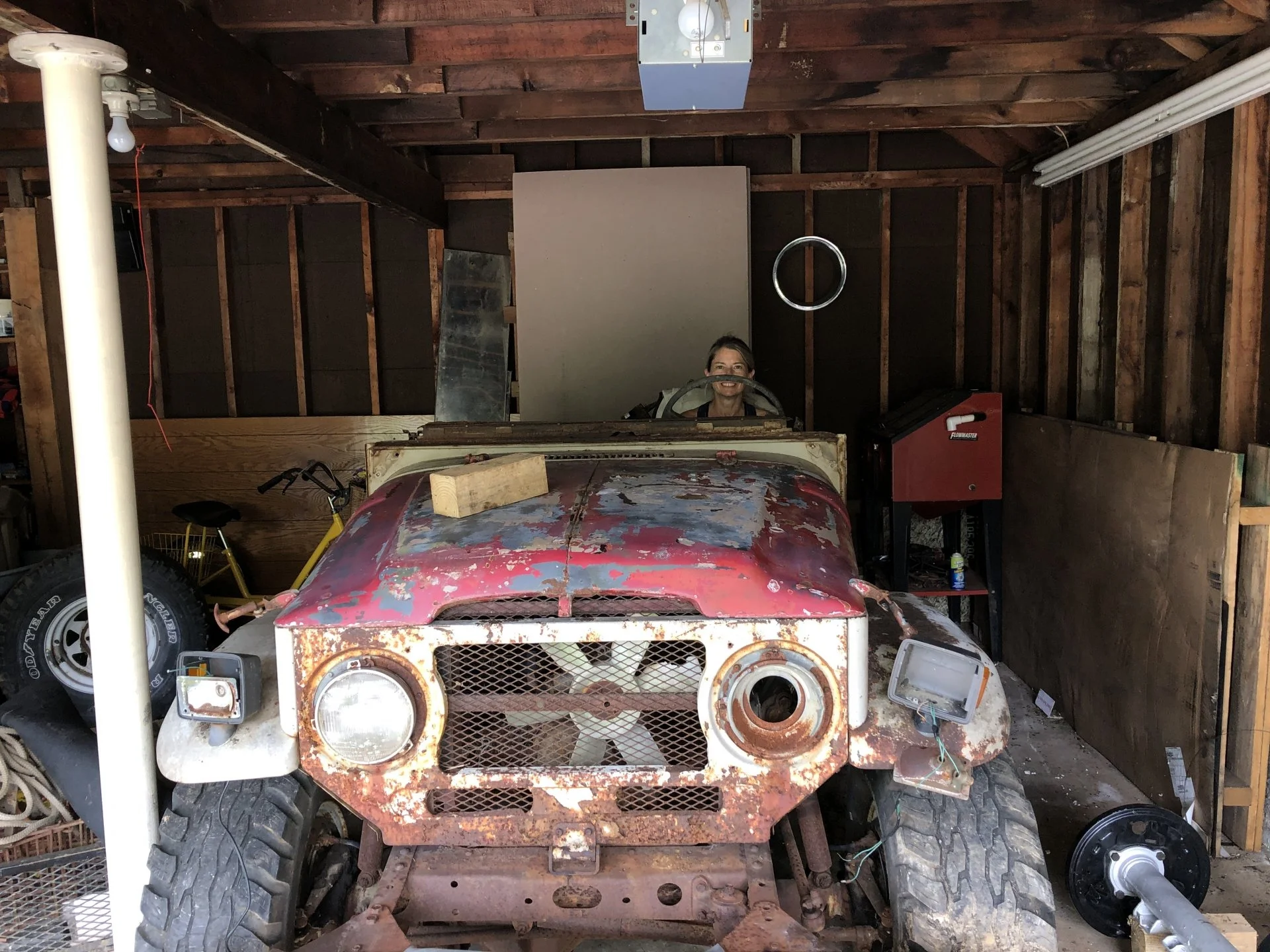

The final piece to this puzzle is a bourbon induced tempest Craigslist search on the East Coast for a 40 series. It was an email flurry to get this museum piece into my stable. Man, I am one lucky dude! This 1976 sits seven hours north of me awaiting transport.

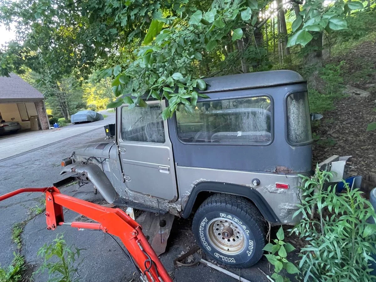

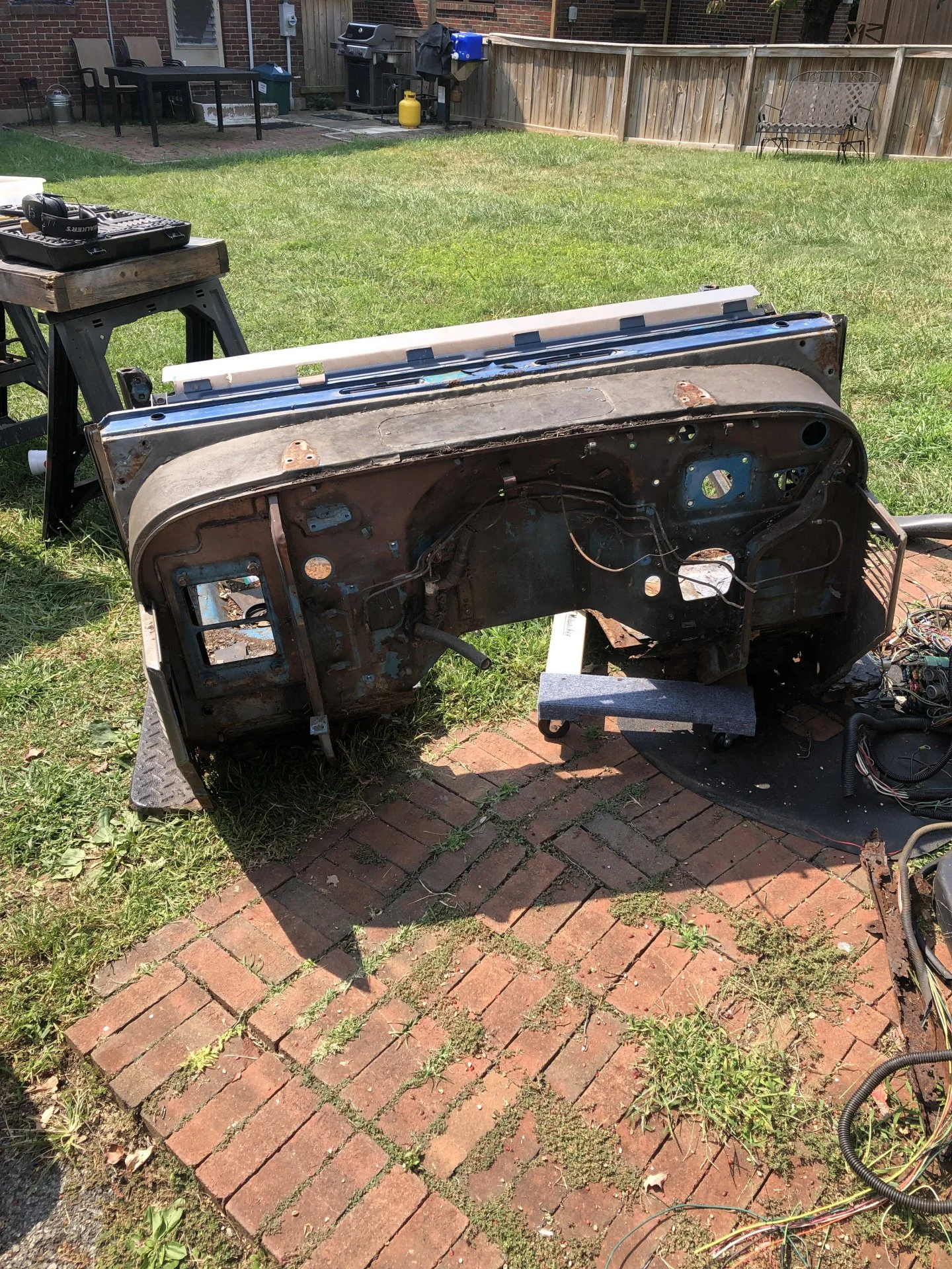

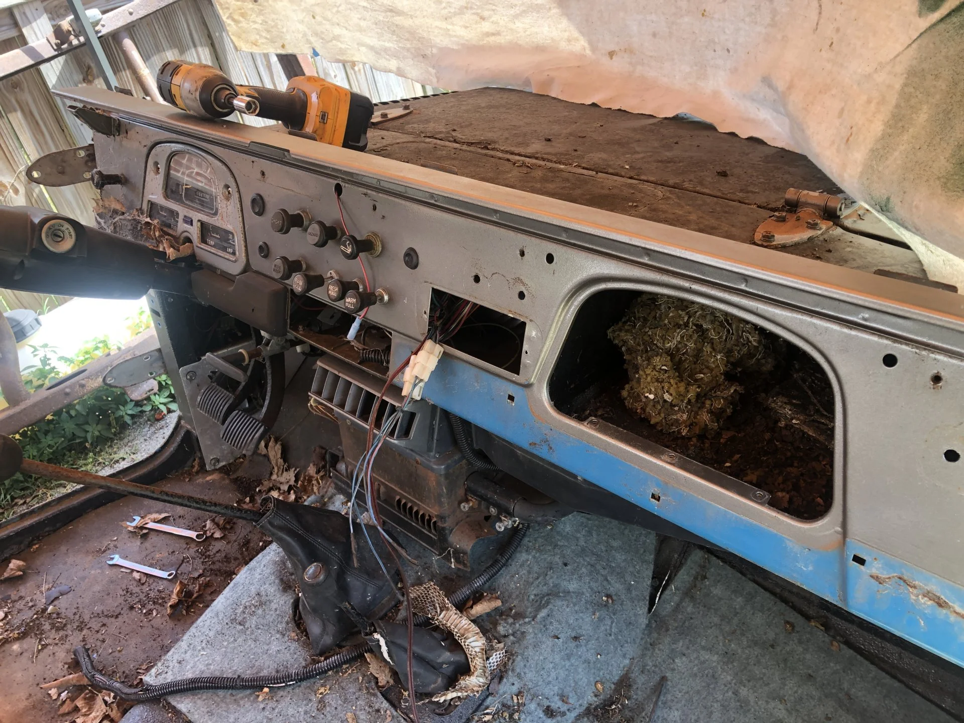

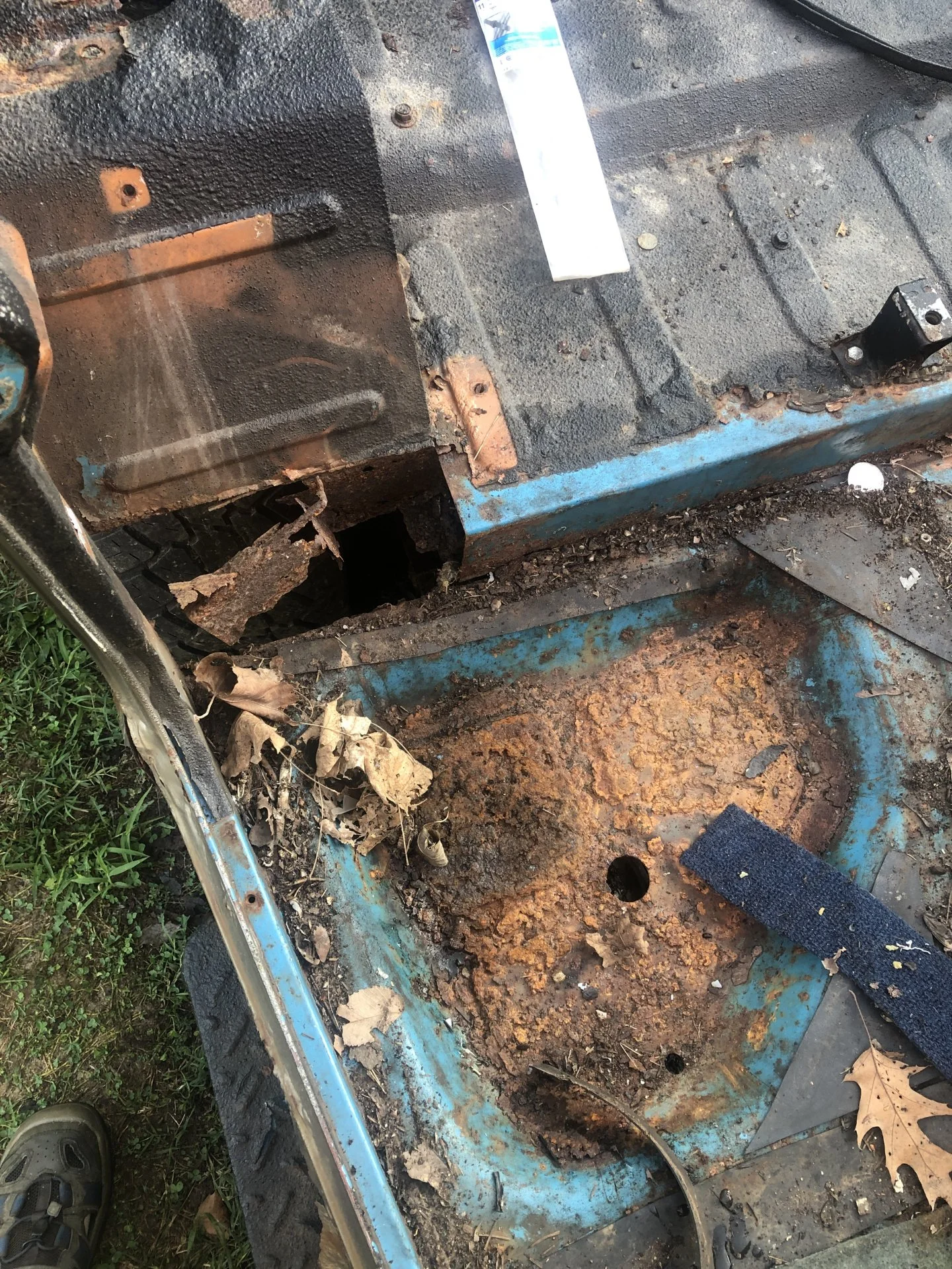

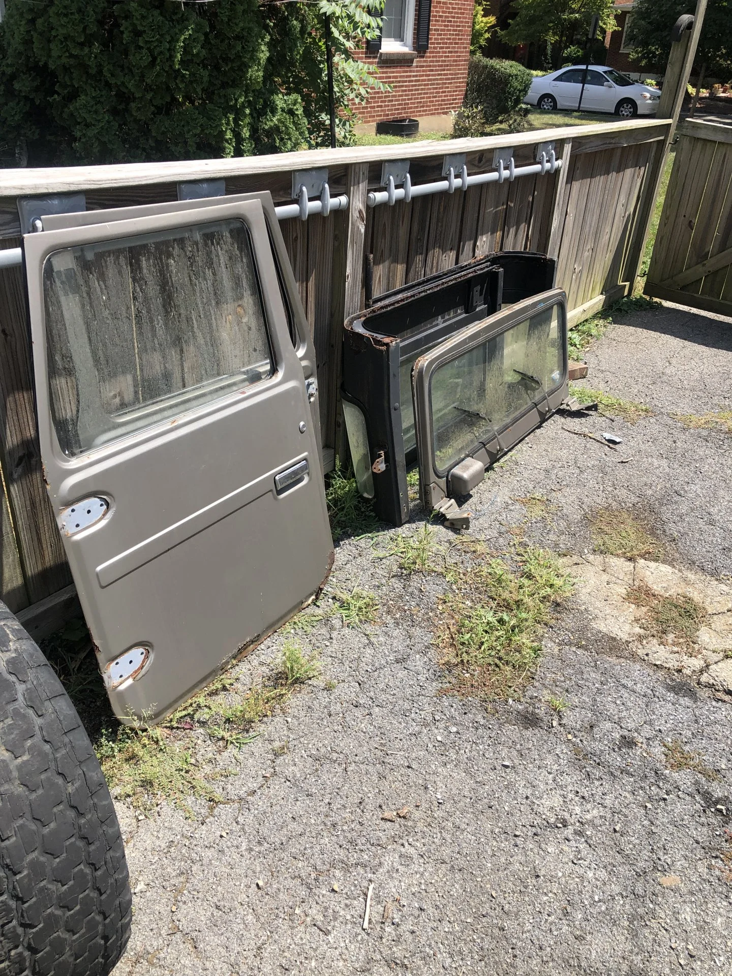

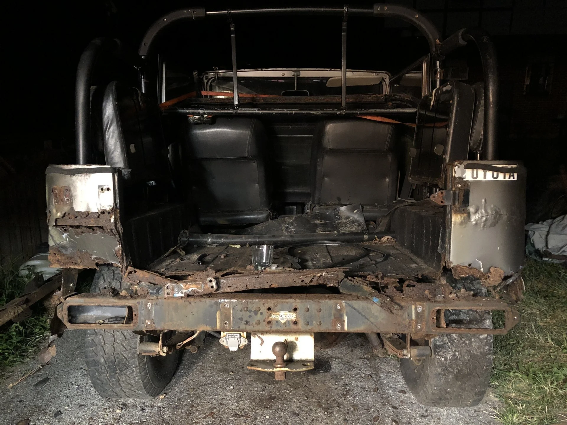

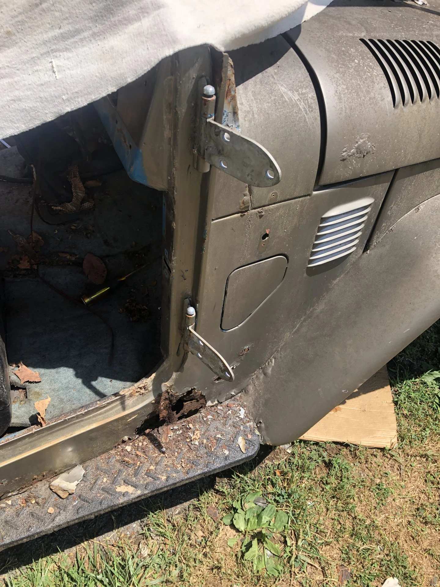

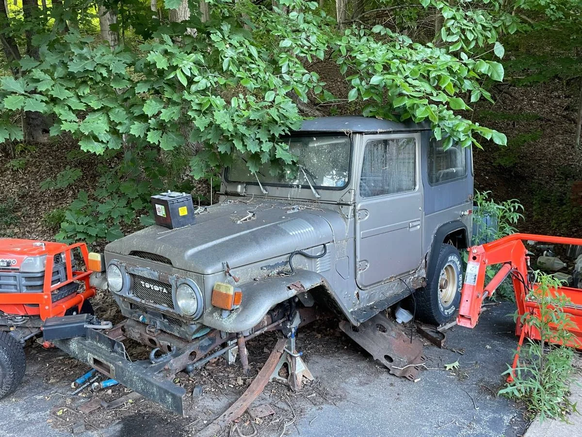

Trip up and back to get the grey Bondo Queen. This thing was a work of Bondo art probably ten years ago. Now, it is a sad sad little man that has slowly rotted away into nonexistence. Any sheet metal was long ago replaced with filler. I am taking any parts off this rust bucket that can be salvaged but so far it looks like I made the sellers wife very happy by getting this thing out of her way. Upside is that there are many bits and pieces on this rig I can use. It looks like it had factory air conditioning. Score!!

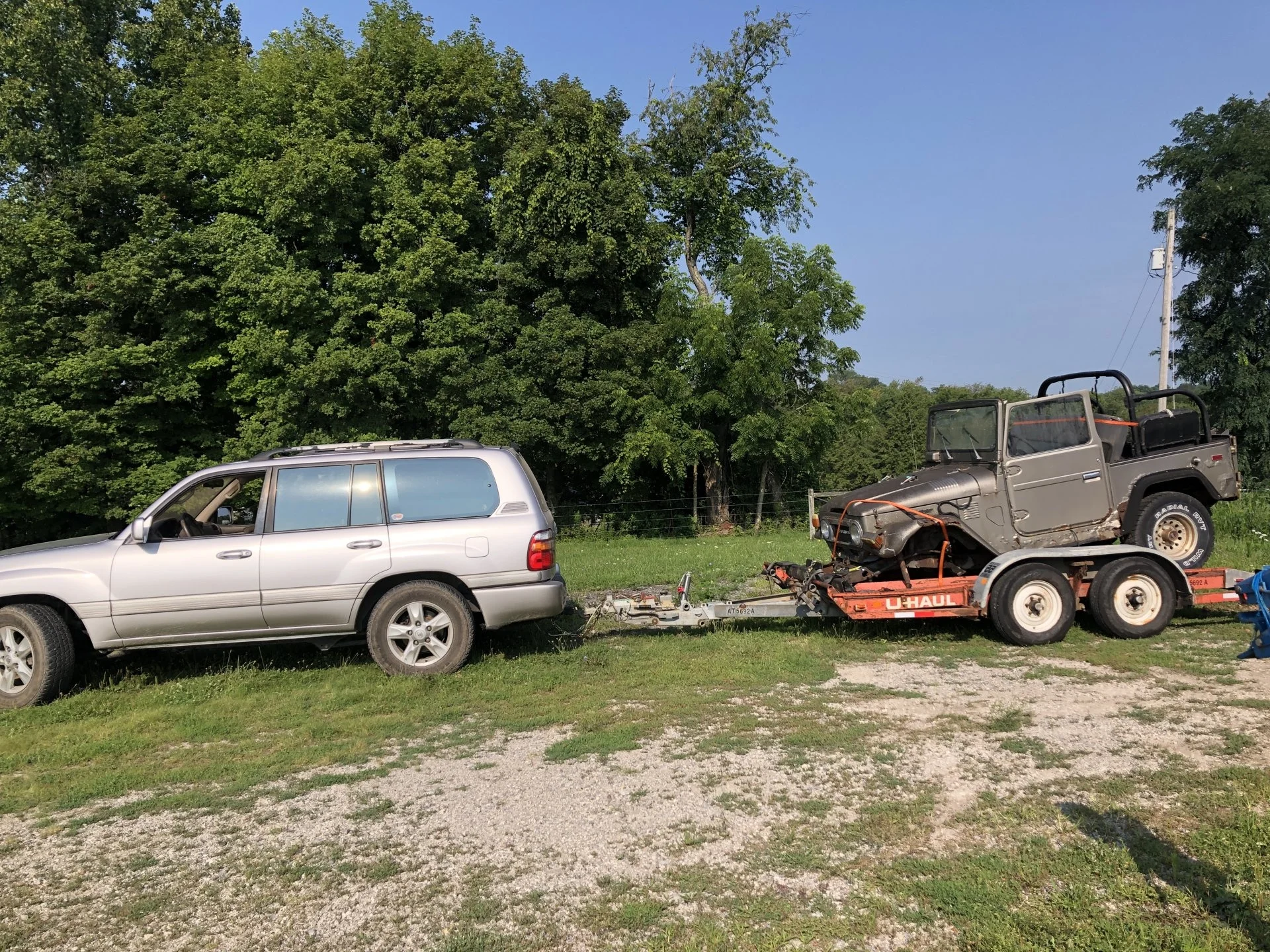

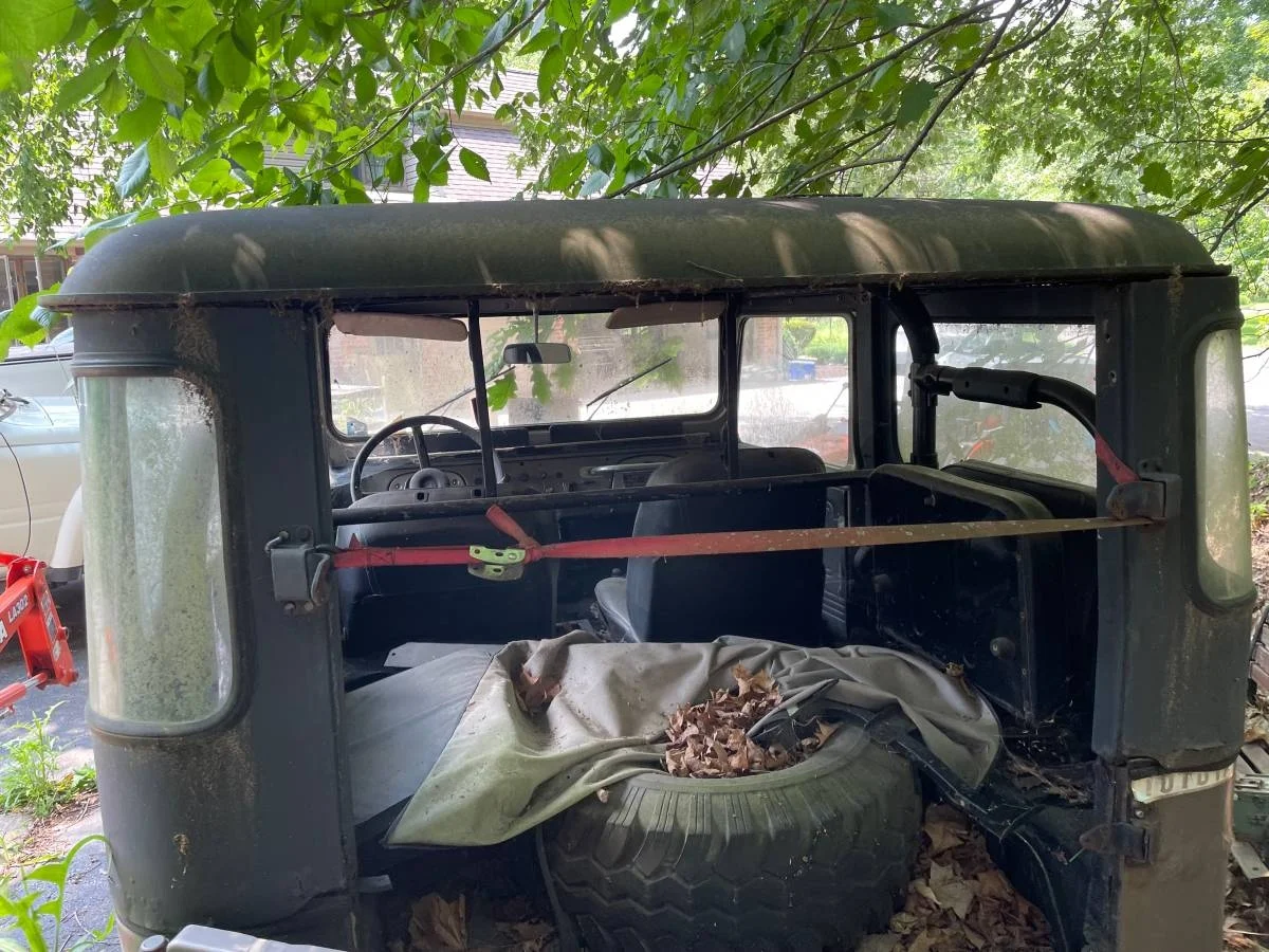

The tan one is trailered, dropped off, backed in, and hidden out of sight until I can get the grey one dismantled. THank you again @mwalls54 for the time you took to help.

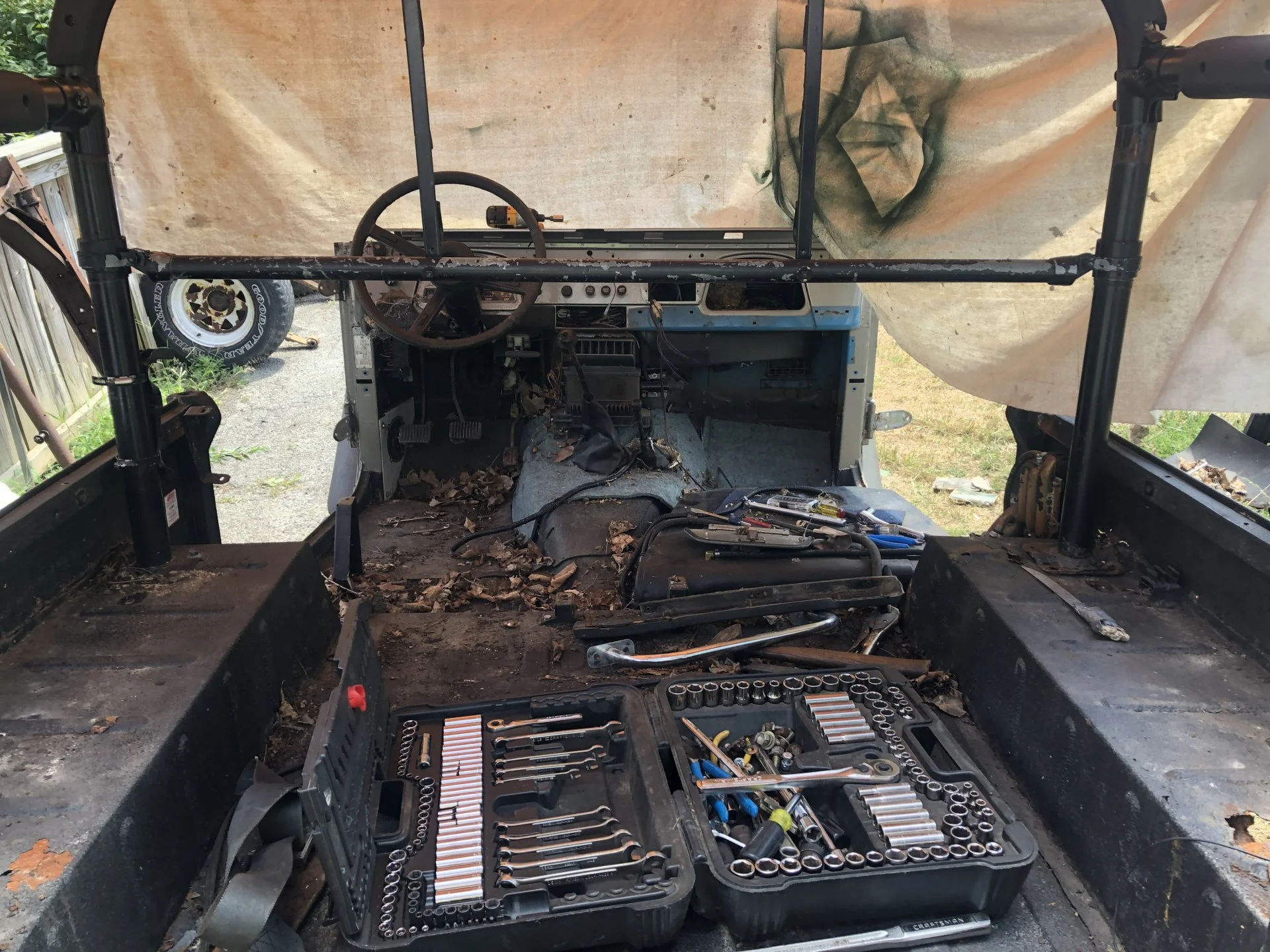

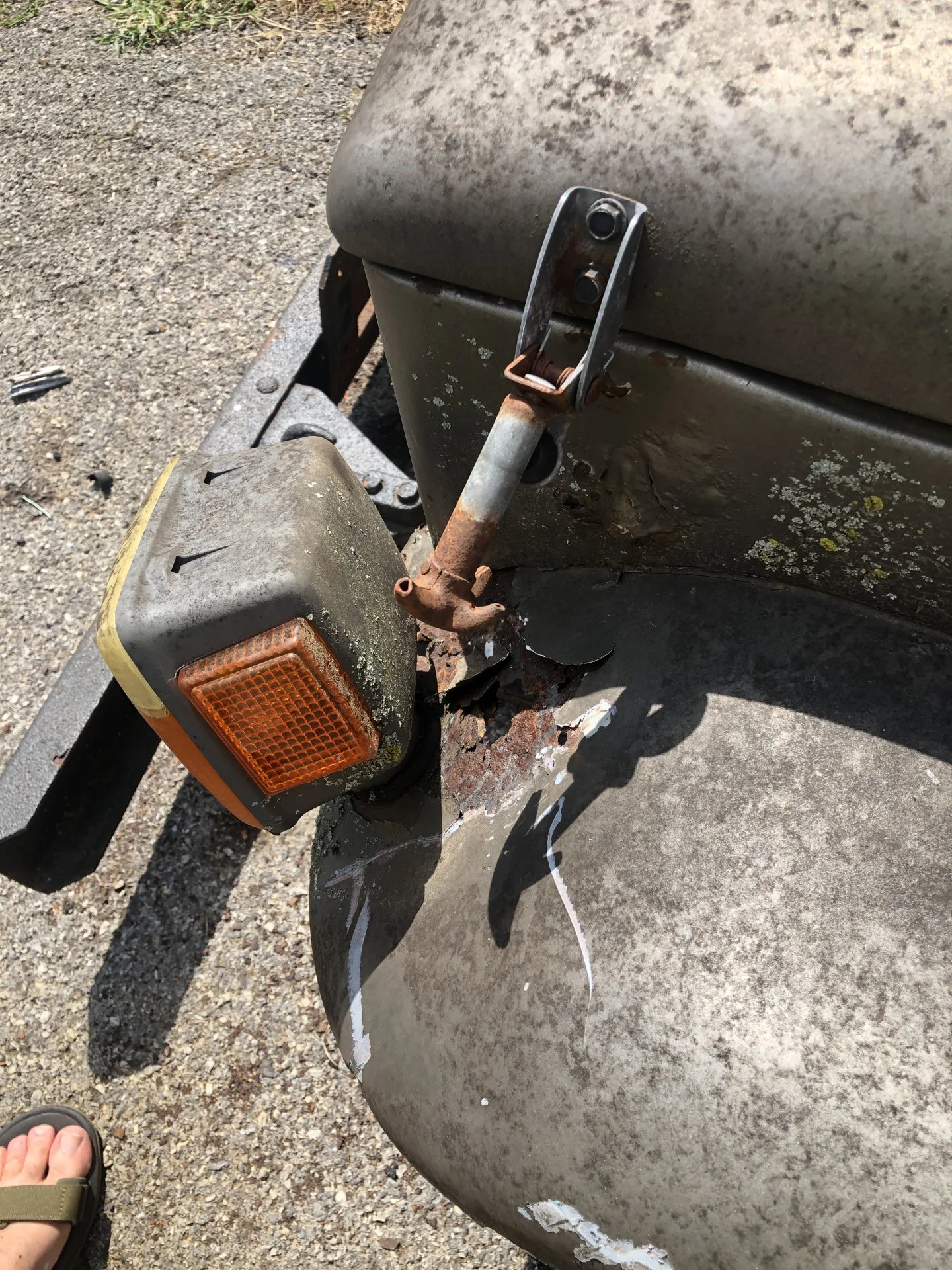

The grey truck was Root Beer Brown on the last paint job (homage to Buster Brown) and originally blue. Dismantling this rust bucket has been pretty easy. Glad this sheet metal isn’t making it to the final product.

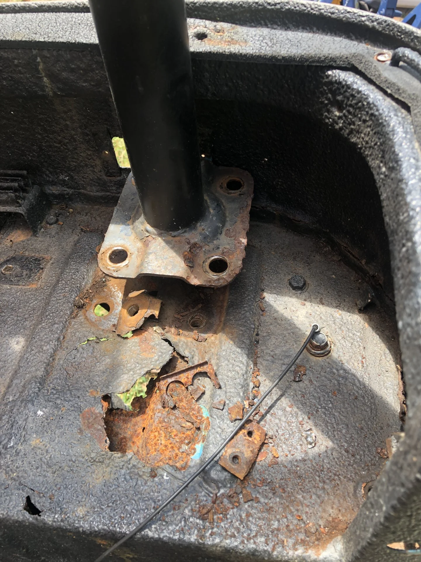

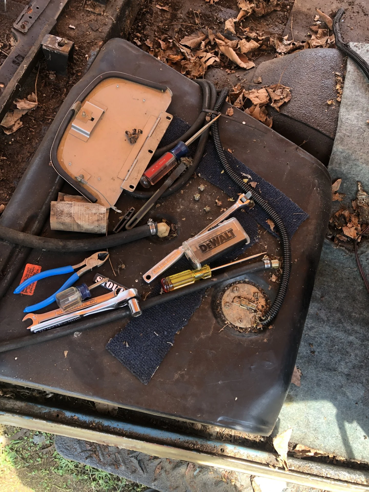

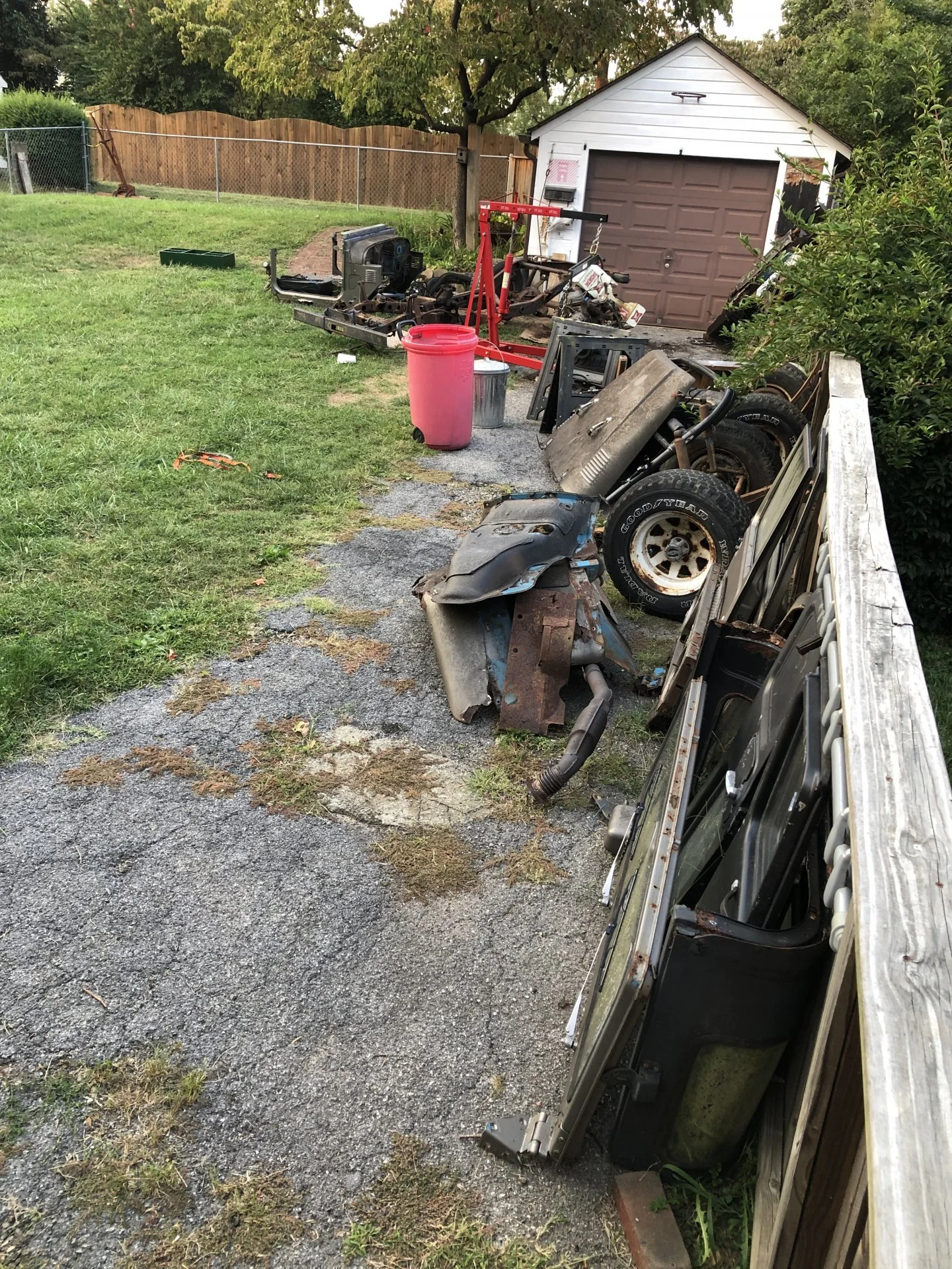

’76 is giving up its useable parts in between snapping bolts and wiping rust dust off my face.

@Hugh Heifer I am very impressed. The build thread is all I have been reading over the past few days. Thank you for that inspiration. Leaving tomorrow afternoon to pick up the tan body. @mwalls54 is graciously sacrificing his afternoon and evening for the cause.

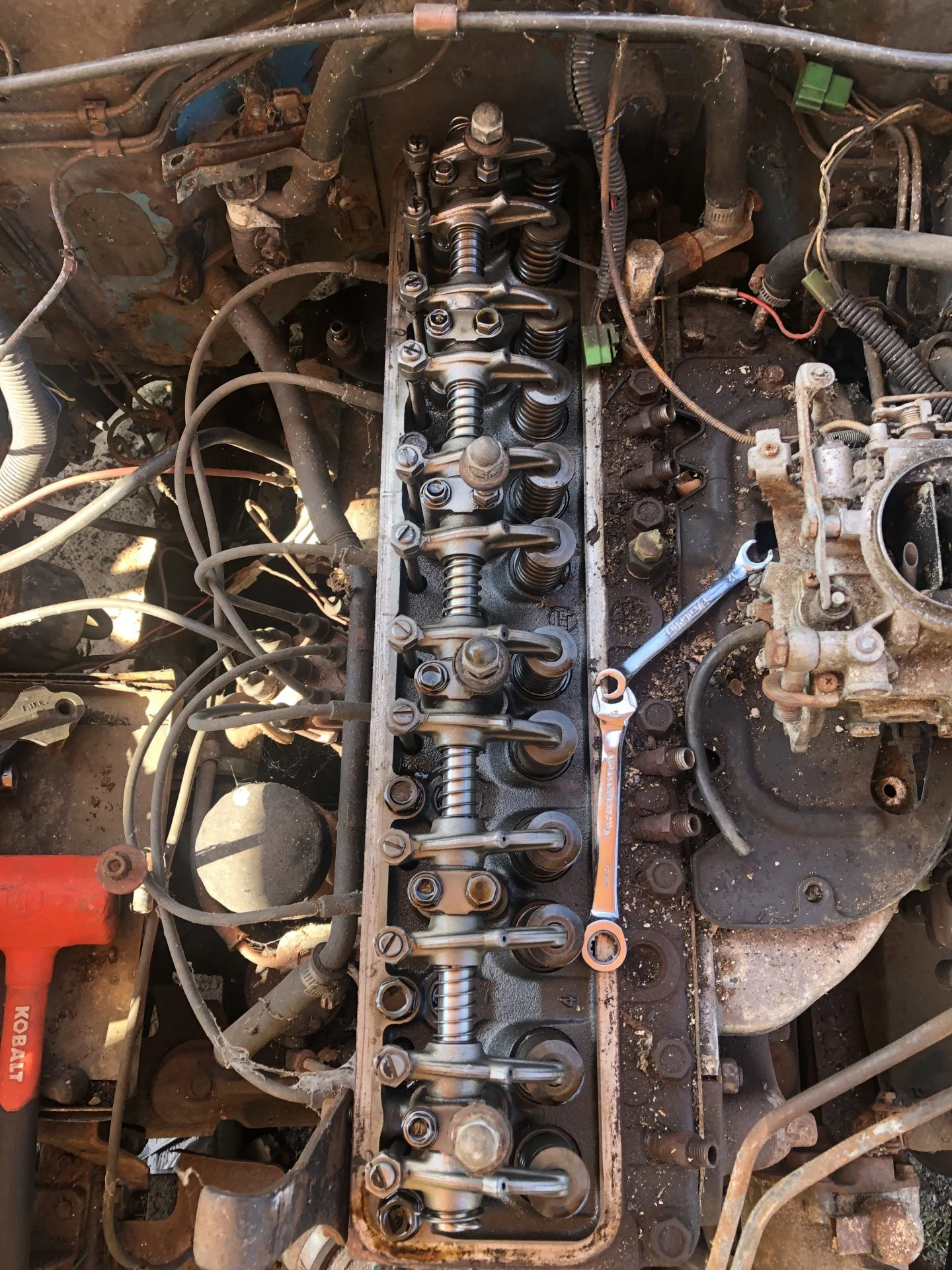

Engine in the ‘76 turns. How do I look up the Jasper rebuild number? The website is not helpful. Separating the back from the front was as simple as using the sawzall and eating more rust.

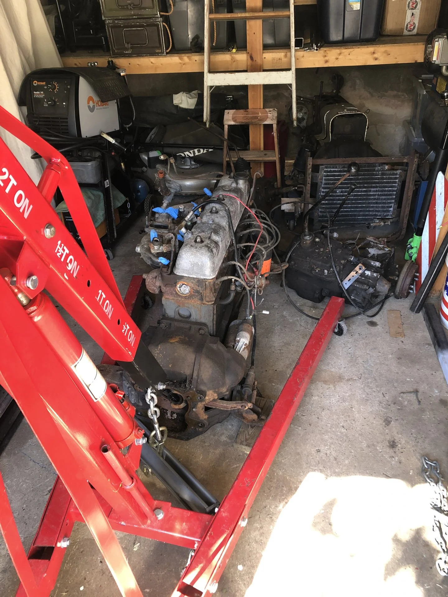

Cowl and body off. The ‘76 was the straw that broke the chinesium camels back. The 2 ton lift was able to get the ‘73 engine and transmission out with just breaking the front wheels. The ‘76 engine and transmission proved to be too much for the Lift. The center brace buckled and the lift is now listing to the left. Engines are out, I have one that turns over, the ‘75 will not give up the engine unless it looks in better shape when I get to it. I will rent the same 4 ton lift that I used to pull and insert the engine into my ‘97 And the chinesium lift will be relegated to moving the various axles into place. ‘73 frame has been power washed once. The steering box is now leaking due to all the caked on grease being blasted off. Gotta remove that assembly and drill out a few busted bolts. Coroseal is in the ‘73 frames future.
