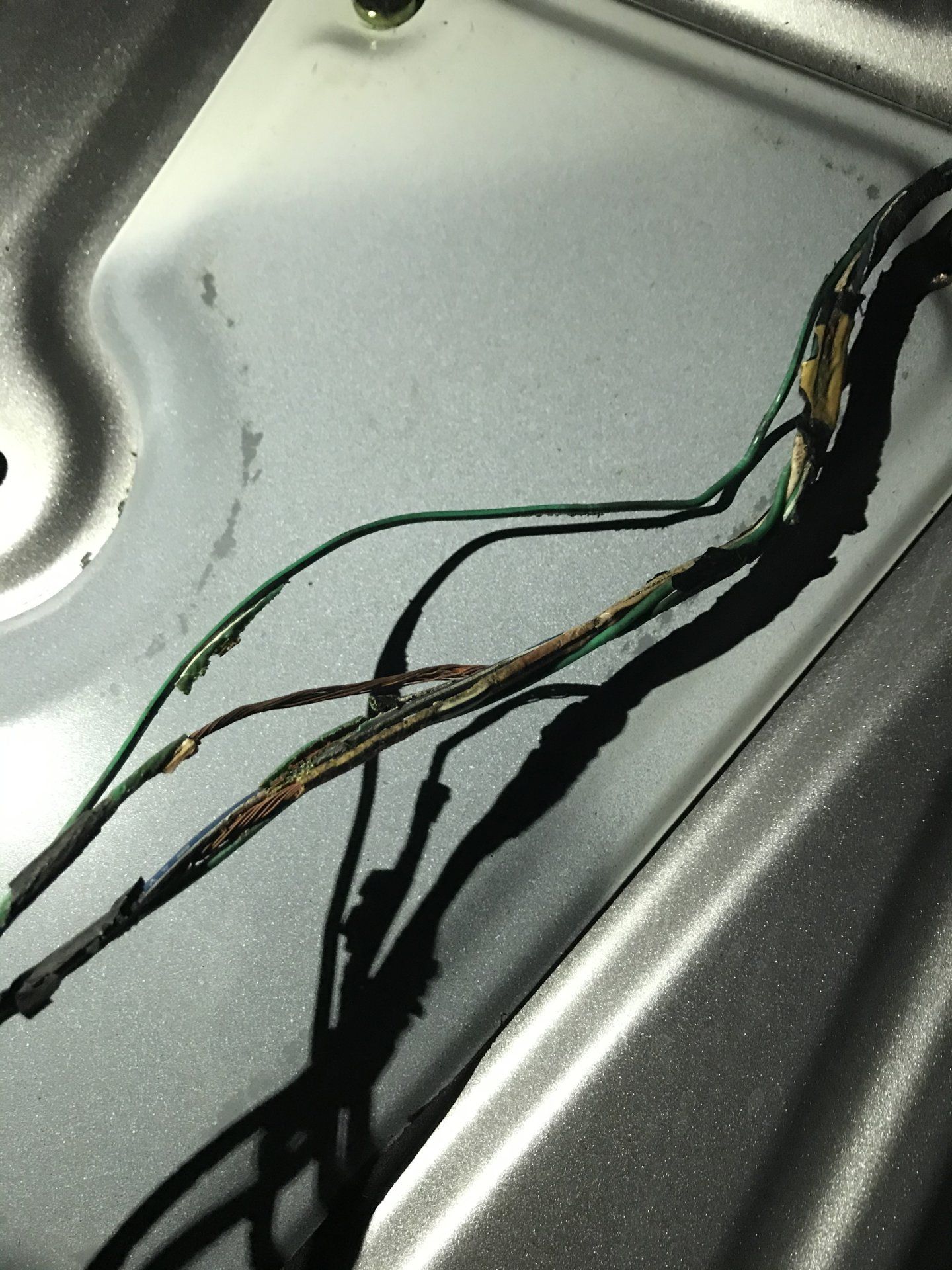

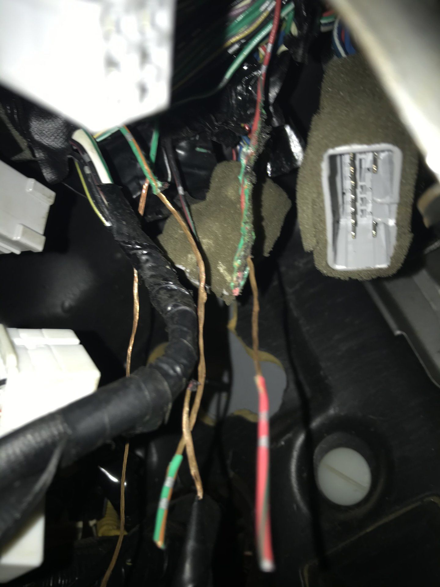

So I started off with a Christmas tree of ABS light which I have read and learned a lot about through others posts. I went ahead and ordered a brake switch in anticipation of that being the problem but the real issue came after. I unplugged the old switch and saw exposed wires in the sheathing. Pulled it back to the main harness and all 4 wires had the coating melted off. No fuses blown. I found this very weird. In the process of soldering in new wires now.

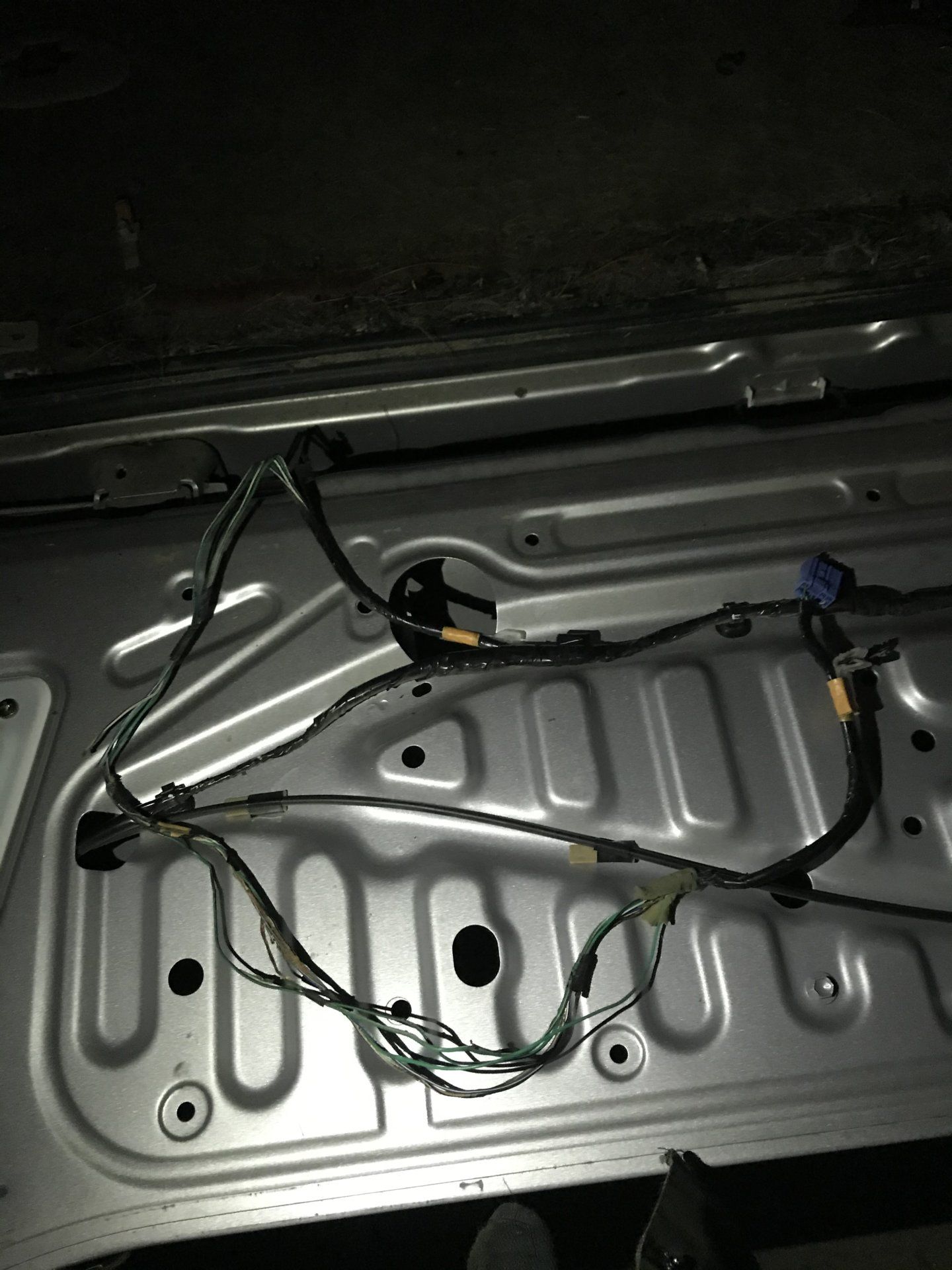

I took a break from that because my hands were getting tired and started looking at the tail lights as other posts have mentioned a bad ground could cause the lights on the dash and found what I believe if the underlying problem. An aftermarket back up camera was installed at some point and was spliced into the driver tail light. After following the camera wires I noticed a bad ground. With it I found the bottom tailgate harness was also melted together and when I moved it random stuff would happen in the car.
I am going to dig deeper into the harness tonight to make sure nothing else is fried but in the mean time does anyone know the part number or where I could find a new harness for the tailgate or is it something I’m going to need to build from scratch? I will post pictures this evening. Thanks again for any and all help.
I’m parting out a cruiser. I could pull that harness. And check to see if it’s the same on my 99
That would be great. Purple clips in the back is what I have. I made up a harness tonight so I’m going to test that tomorrow. Just dm me with the info.

Thats what I've gathered, I figured ferrules and sealed heat shrink will be the best. On some of them they are right at the connectors and I'm not sure if I can unpin them and add to it. most if the damage is to two connectors at the brake booster. Map sensor wires are in half as well but still starts and runs ok. That is the only engine code I was getting but all kinds of other lights are on I'm assuming associated with the abs
The EWD and Wiring Harness Repair Manuals (WHRM) will help you repair any damage. The WHRM has instructions for repairing every connection in the harness. It's in the 100 series forum for free download.
