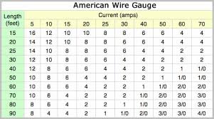

Add up the max amps you will draw from all of the connections, or take the amp rating of the Blue Sea box, then use this table to find the correct gauge for the length of the run.
images
From the chart I think 8 gauge will do the job and leave me with other options. Think I worried about it too much and didn't want to overkill the problem.
The wire size being used (8 Gauge) should be adequate.
