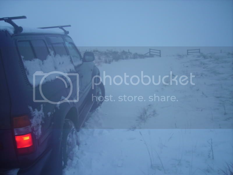

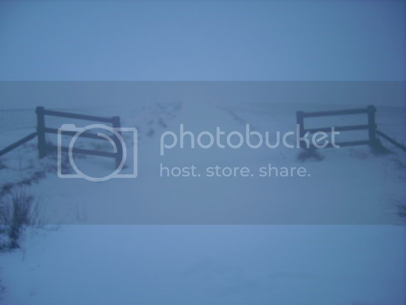

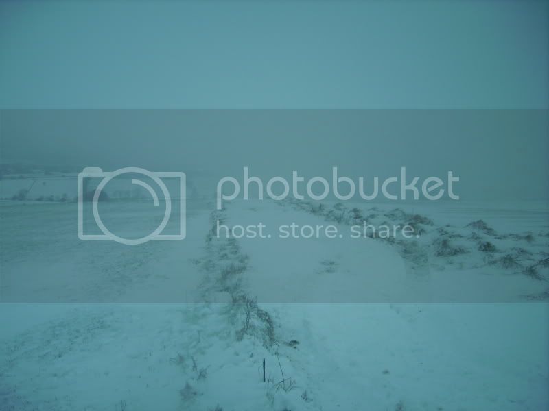

ok, a few pics, its nothing compared to what some of you lads get. these are from last year. the more people that try to get up the track the worse it gets, and like i say coming down can be a nightmare.

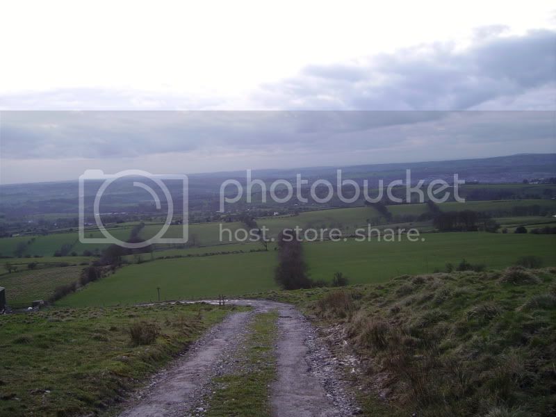

lol, yeah, pretty much. the corner of the house can just be seen in the third shot down
You chose the right car !!

the surface of the steep secton is uneven tarmac.(roughly layed by ourselfs). there are no mud sections of the track. once reaching the top of the track and the main road i can have anything to up to a 30 mile journey to get to work depending on where i am working.

without snow;
I never would've guessed that asphalt was underneath! It's certainly a prettier view without all the snow.
