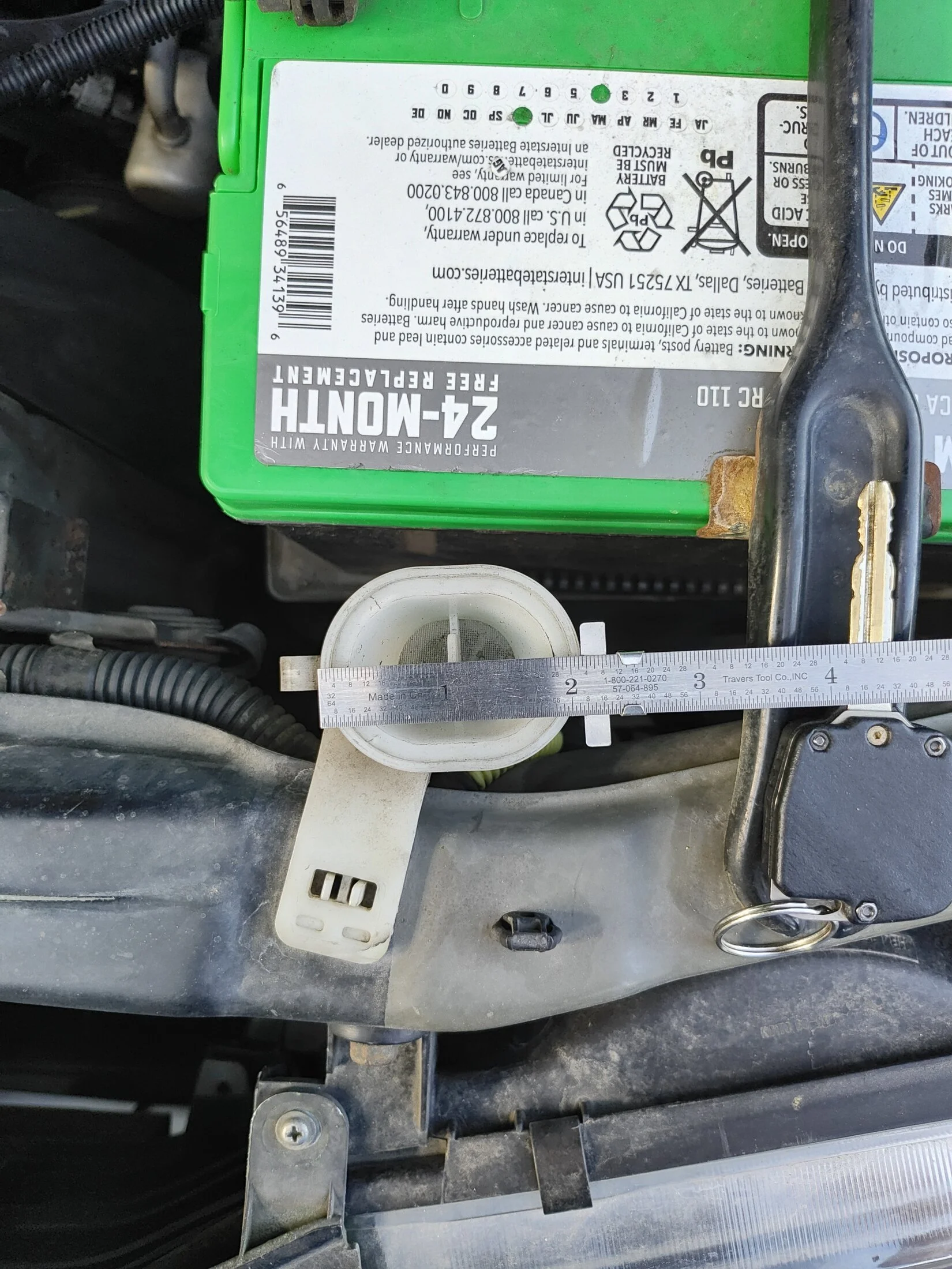

I'm not seeing any discussions about this, surely I'm not the only one with a daughter so very proud of refilling the fluid herself but forgetting to reinstall the cap? I see no part numbers in the parts diagrams, maybe it only comes with the filler neck?
I'll 3d print one tomorrow if no one has the hidden knowledge.

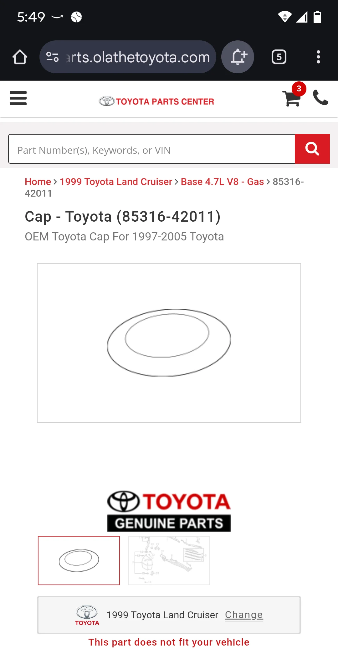

Thanks, I had seen that number but it didn't show up as for my year in several places. I'll order one straight away.
Online images of the above part number all show a round cap. Looks like early 100's had this oblong shape, and the cap comes with the filler.

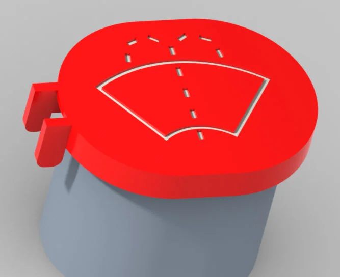

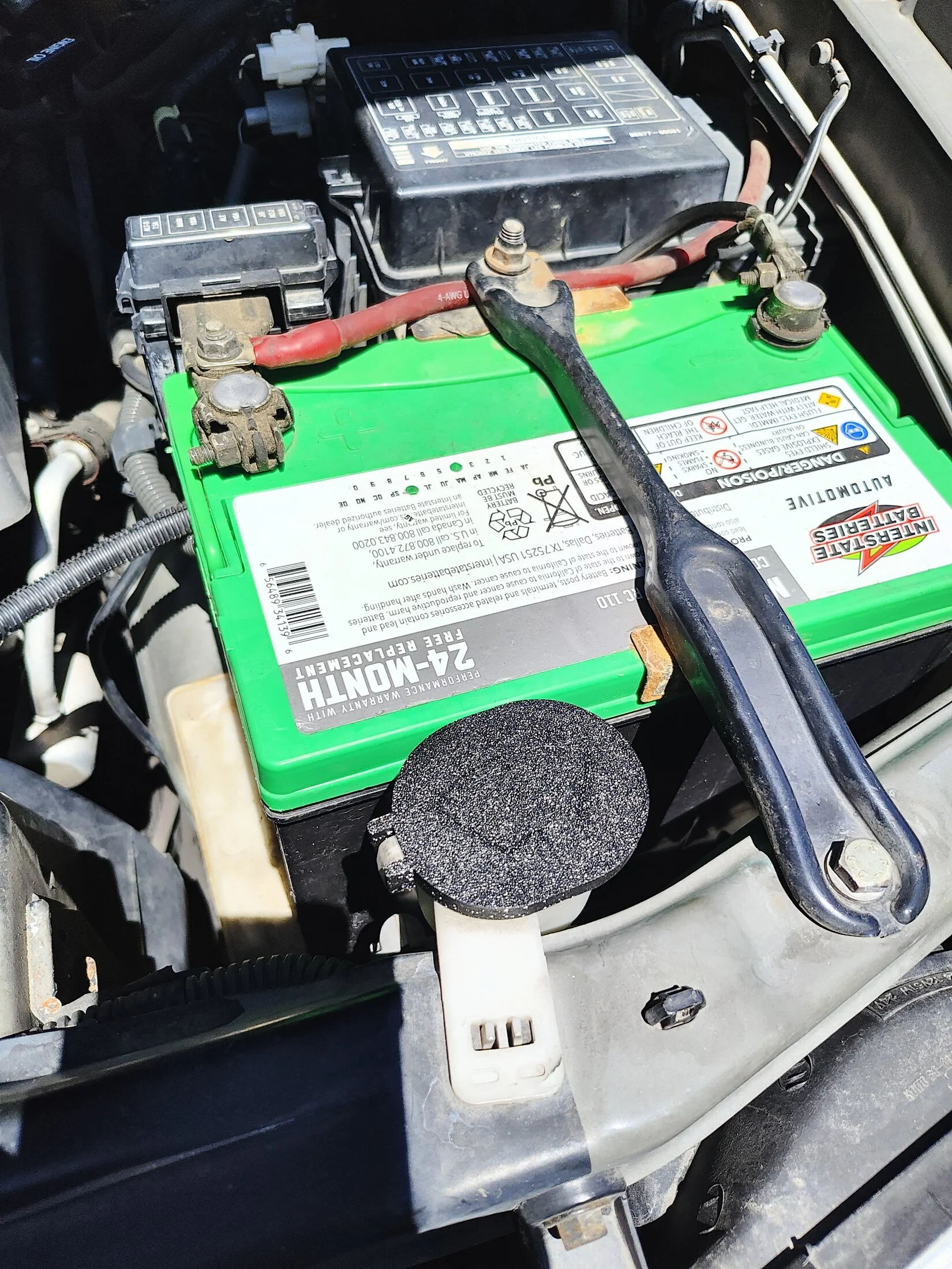

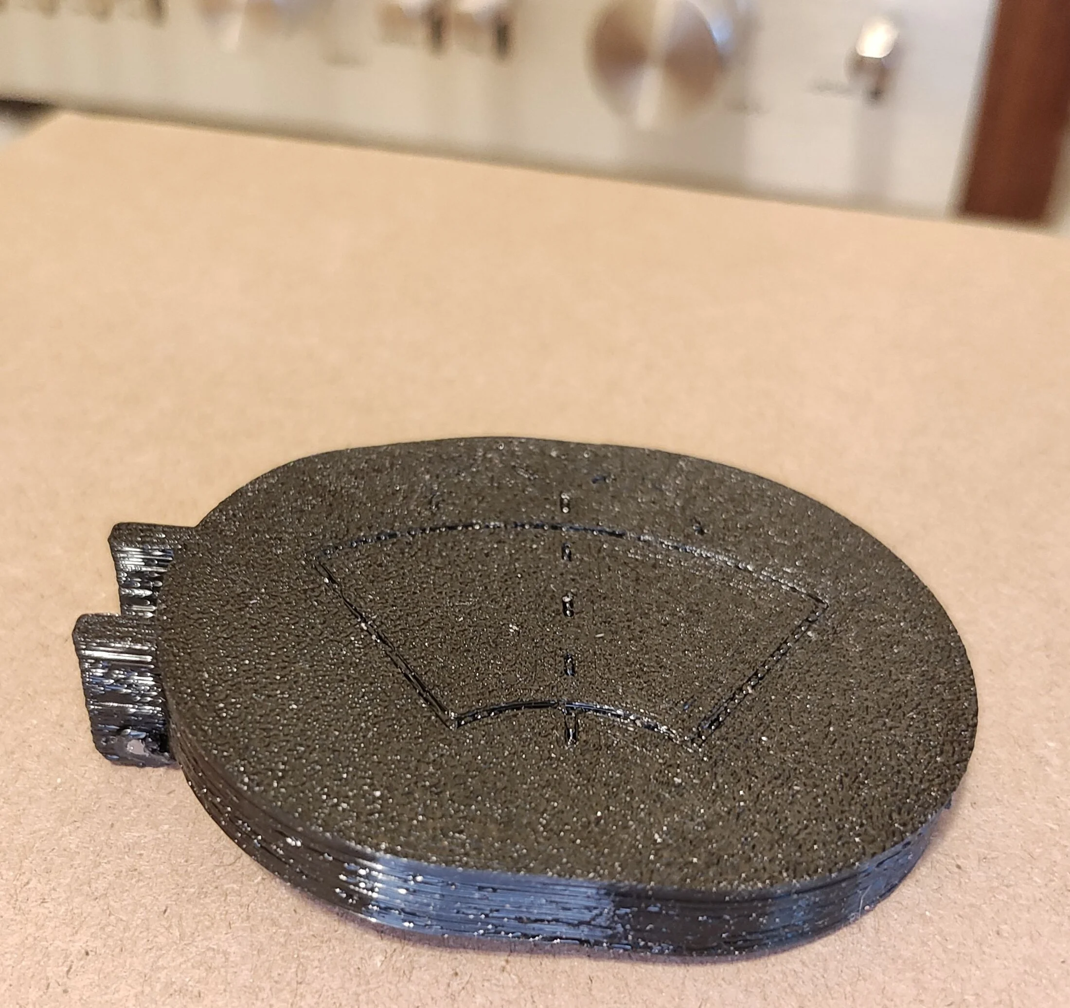

So, Plan B it is. CAD model, print in TPU, add pivot bar (cut off nail), and we have a replacement. Quite snug fit, I like it. The pictogram needed to be a bit deeper to print properly, but I don't think there will be any doubt about what goes there.
