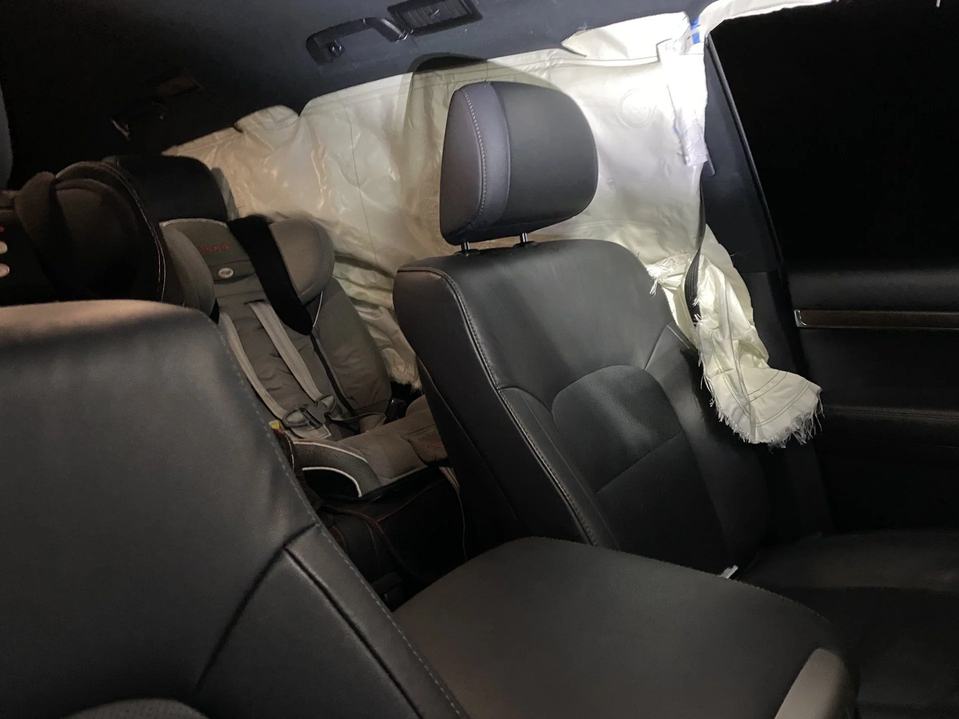

The curtain airbags go down into the compartment not up towards the windshield. If you tuck a wire against the windshield it should be fine. This is the best picture I have, but I did cut the airbag away after it deployed.
@BrainDoc This is super helpful. I've actually got a couple wires running up my B pillar too, but it's pretty clear from your images that (as long wires have a little slack) the airbag will just push them out a bit. And yeah, that downward trajectory does seems to reduce concern about what could happen up top at windshield height.
Can’t post a picture like that with no backstory.....
In the beginning of January I was out driving with my family in a state park. Someone was drunk, speeding in a 2004 Ford Escape and ran a stop sign running into my passenger front area. We spun to the left and they kept going into the woods. We were all fine with a couple bruises but luckily no injuries. Every airbag went off. I checked on my wife and 3 kids and they were all fine. The car automatically dialed assistance. I had to cut away curtain airbag in order to get out and check on the other driver. She was standing outside of her car clearly drunk telling me I ran into her. I go back inside to check on everyone again and verify they are no latent injuries, and pop back out and the lady is gone. I keep a bright flashlight in the car. and after a quick sweep I see her walking away on a trail. I run after her and clearly inform her that leaving is a bad idea and that she will not out run me. She finally decides to walk back on her own. I run back and the police are there checking on everyone. I explain what is going on and they arrest the lady.
