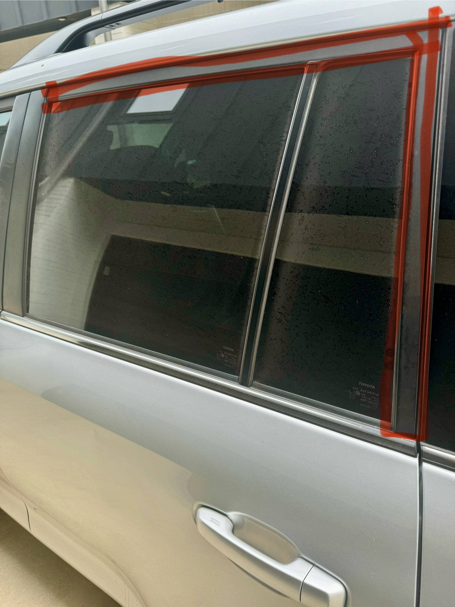

Looking for recommendations on how to restore the finish on the window surrounds. Mine have a bit of oxidation all the way around. Tried some black trim restore cream with no success. Had a couple of detail guys look it over and one said he could repaint them? The other said paint is not a good idea and to either vinyl wrap or replace. (Not sure that’s even possible.)
Vinyl wrap is possible, but you need some skills to do it right. You also want it under the rubber seal, so a bit of disassembly is needed if you want to look professional. XPel has actually black paint protection so you get the benefit of their superior material vs. just vinyl.
Paint is more complicated to look right. Some of the trims would have to be removed. It is also more expensive due to all labor involved.
I use Rustoleum Wipe New. It flat out works on faded, oxidized black plastic. And it's easy to apply.
So far I have tried Meguiars Ultimate Black and Solution Finish. Neither did the trick. If the Rustoleum wipes don’t work out I’ll have to look into the black xpel. Thanks guys!
Ok this stuff is the real deal. I think I'm going to need to apply a second coat but it's already made a noticeable improvement on the main trouble areas! I went ahead and hit some spots that were in move favorable condition and they damn near look brand new with a nice glossy black shine to them!
