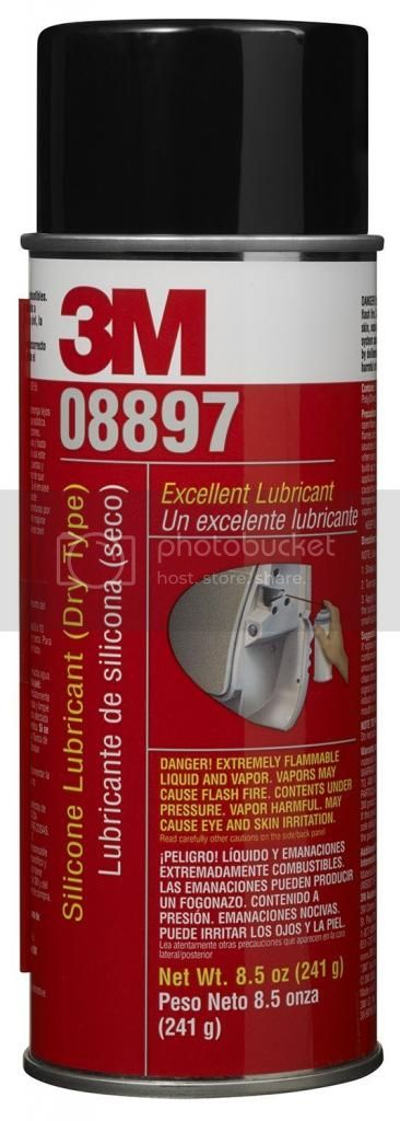

But maybe you need to “lubricate” the rubber trace that the windows run in. The rubber gets old and won’t be as smooth anymore. You should be able to hear if the motor is working hard to get the windows up/down. I used dry silicone that I sprayed into the rubber trace, that really did the trick for me

Do you just spray that 3M lube down into the window track? Is there anything more to it?
Roll down the window and just spray the inside of the rubber track up and down in each side of the window. Roll the window up again, roll down and repeat a second time – it’s not greasy in any way. Before I sprayed I did buy new rubber tracks, but just wanted to test and try with the spray first. It has now been working for more than a year now, and I still have the new rubber track laying in my garage.
