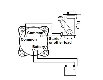

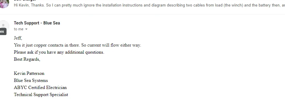

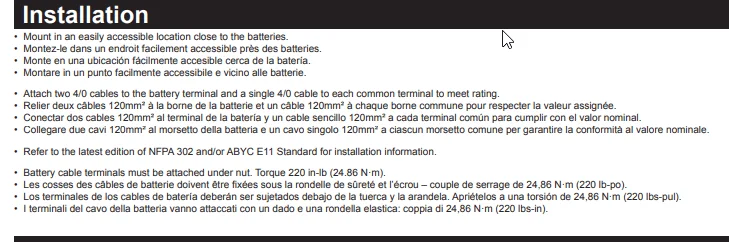

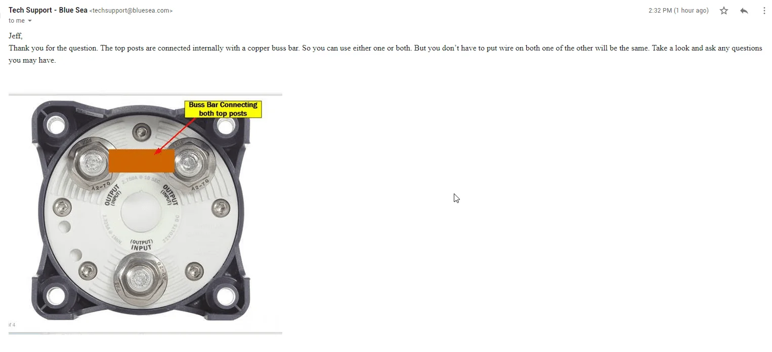

After probably too much reading, I ordered a Blue Sea Systems 3000, HD-Series Heavy Duty On-Off Battery Switch to shut off power from the battery to the new winch. The instructions for the switch describe running two cables from the load to the switch, and two again from the battery to the switch. Any idea why it would need this, what seems like, redundant wiring?
