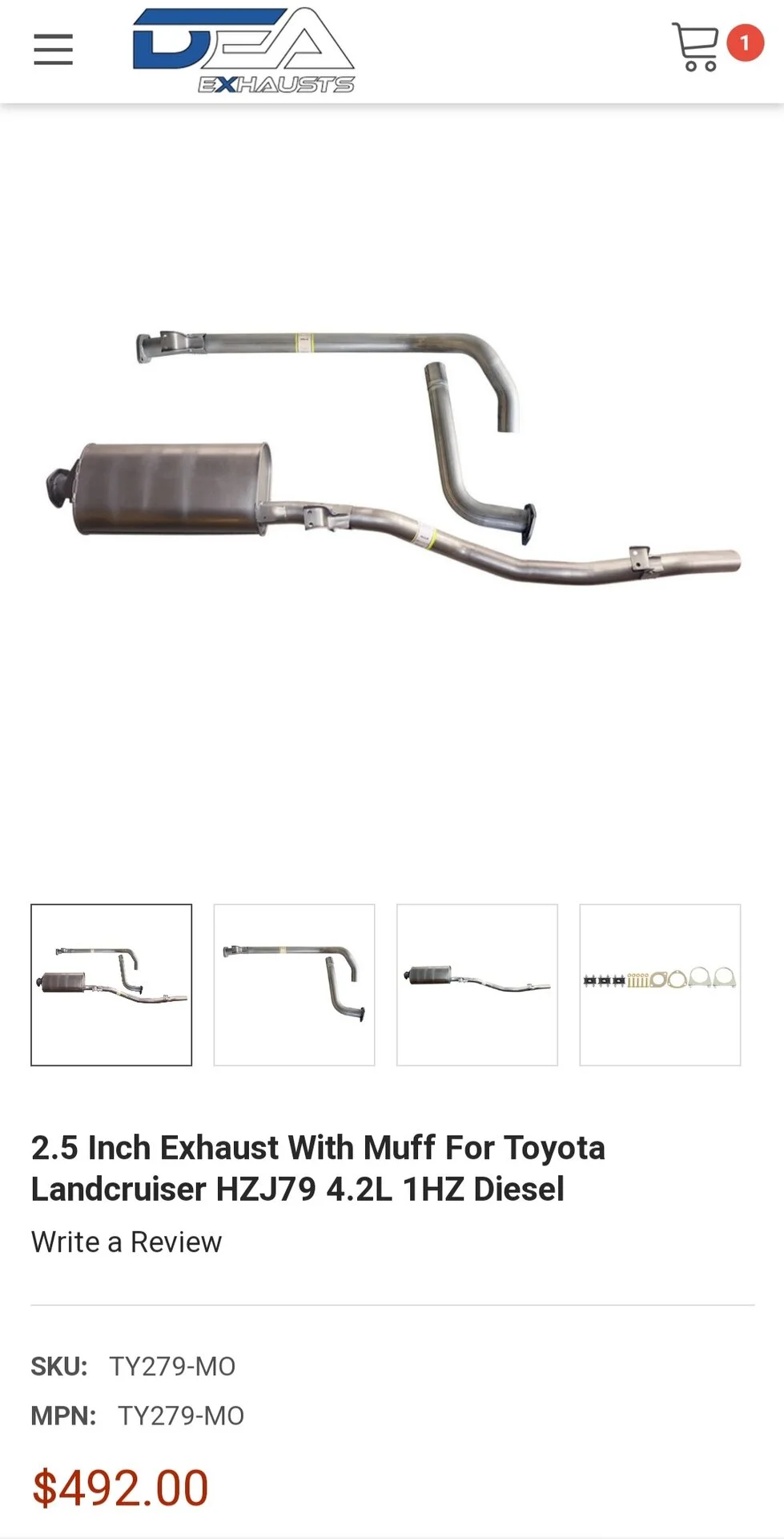

I was going g to purchase a exhaust from this company for my HZJ75 troopy but unfortunately they're out of stock. they do however have a exhaust for a HZJ79 ute.
they look identical but I just want to make sure that it will fit, Will it?
You know a 79 series is longer than a 75 series? My guess it will fit if you cut it , but no guarantees on that one. Why dont you just buy a 75 series exhaust or a 78 series?
The company doesn't sell 78 sereies exhausts and the 75 sereies exhaust was out of stock. But I found a local exhaust shop that will supply and fit an exhaust for about the same price.
