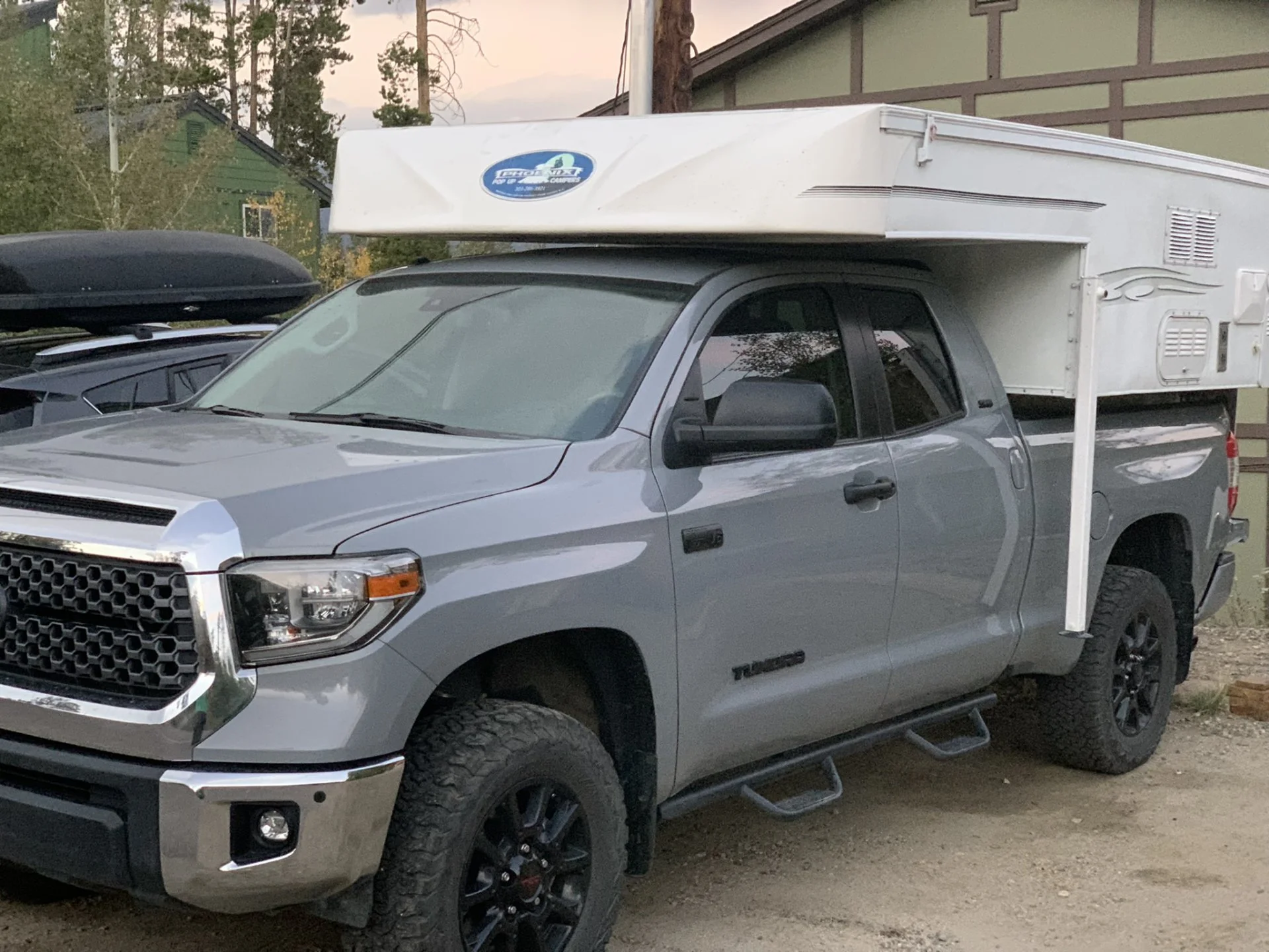

Have about 3k miles with this set up, barely can tell it is on there other than mpg. Added airbags to help out.

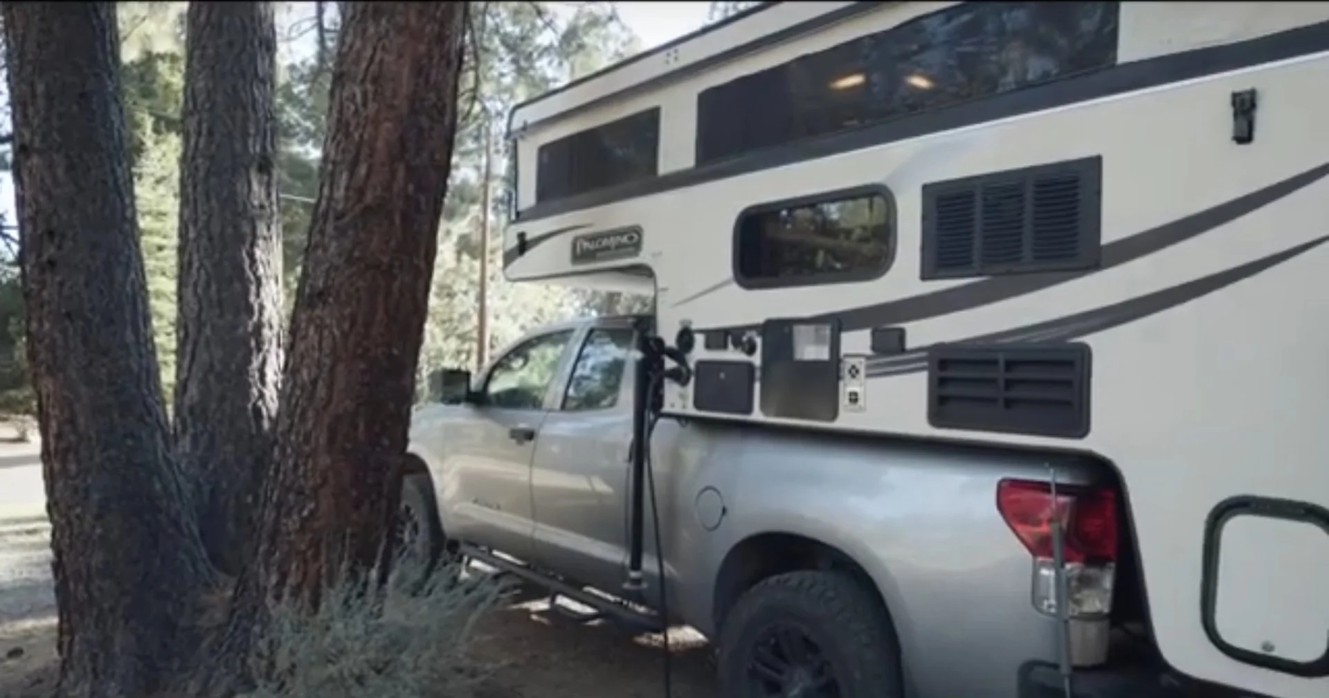

I watched a video where a guy was reviewing the same camper I’m looking at mounted on a 2012 Tundra. He didn’t get into specifics of how he prepped the truck, and has only owned the camper 4 months. There were a lot of inaccuracies in his “review”, so I’m taking it with a grain of salt. It was at least suitable for a couple of screen shots to show the possible pairing.

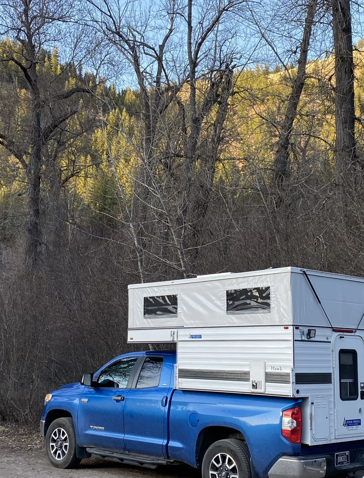

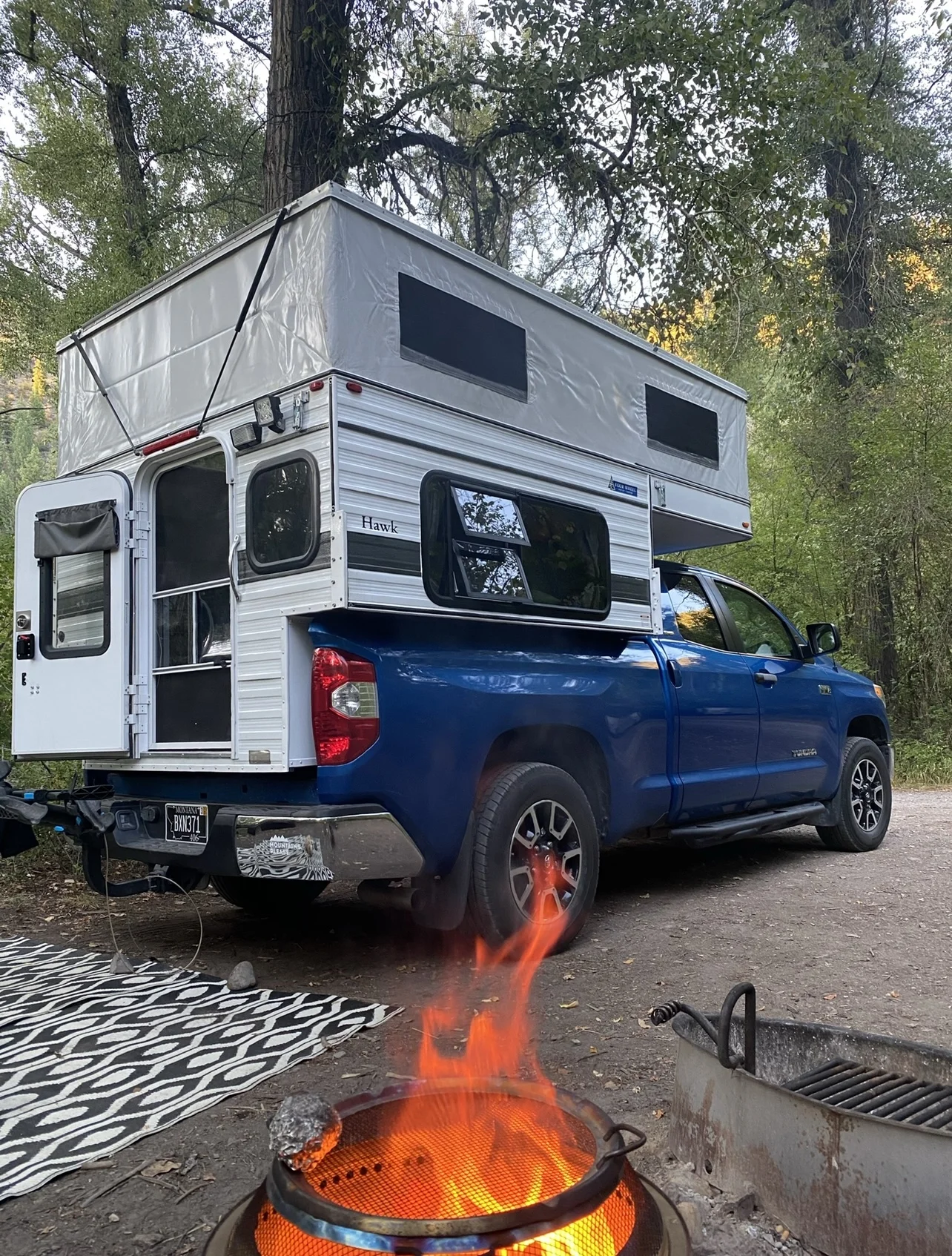

I have a FWC Hawk. Sticker on it says 750 lbs, but it has some extra options. Likely around 1000 lbs loaded. Originally just put timbrens on and it worked great. Just recently added some progressive springs, after adding new Bilstein shocks and it handles very well.
