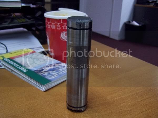

Rebuilt the tranfer case today here is a picture of the scarred idler shaft and worn needle rolling bearings. This was the problem, now no whining from the case or from me.

This was KKT's Idler Shaft.

Here is my own Idler Shaft – Looks familiar huh?

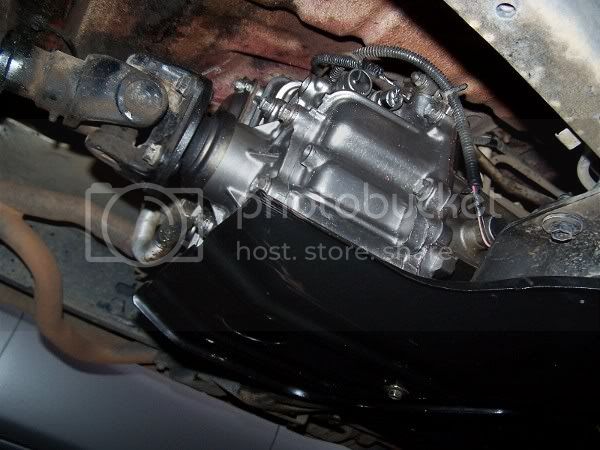

I went to Mudraks for the t-case rebuild because I know better than to do this type of work on my own.

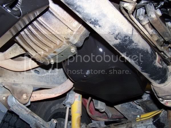

While they were under the cruiser they cleaned the transmission pan
Did a new gasket on the oil pan to hopefully fix my annoying oil leak.
Mudraks Rocks! Gary is super cool.
Looks great and I don't hear any whine! We switched motor oil to Redline Synthetic - also went synthetic in the transfer case and transmission. For a shake down drive we drove to Monterey and back for the weekend from SF!

5/6/09 update - the oil leak has been fixed 100% by changing the oil pan gasket!
