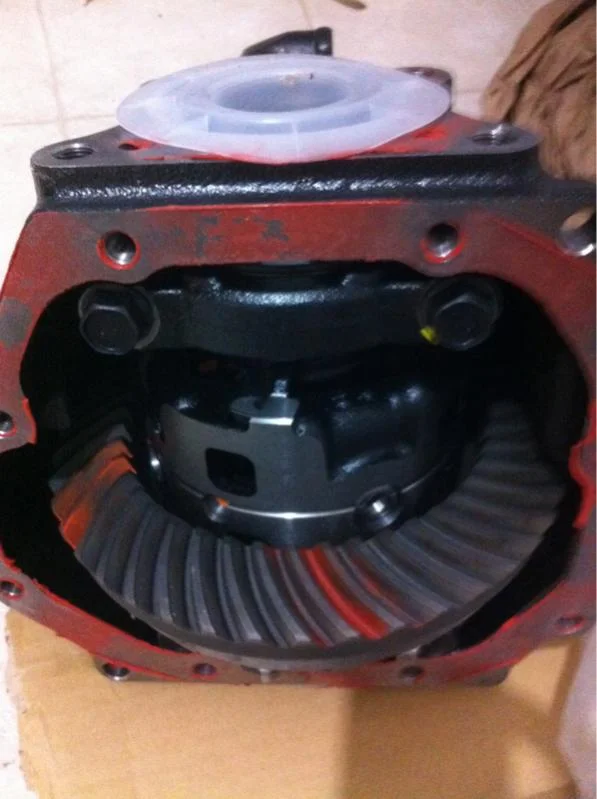

New front diff from cruiserparts arrived last night. 70 pound box.
Manual calls for fpig on the diff cover. Do y'all think the red stuff is factory applied fpig?
