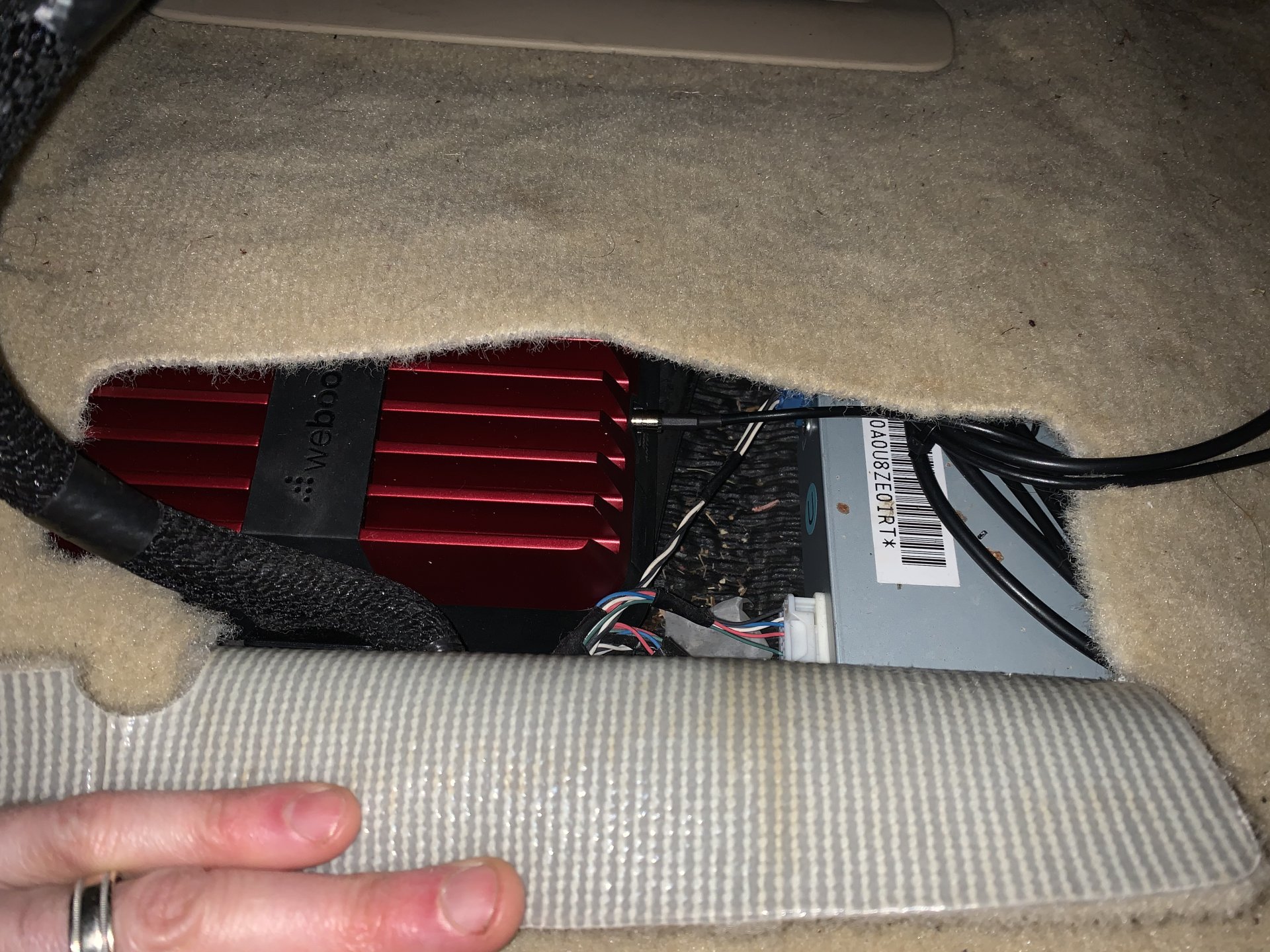

I purchased a basic drive reach unit (not the OTR) when @SharpeCat arranged a group buy. It has been handy and worked pretty well in areas with sketchy coverage. Finding a spot for the main box can be challenging. I've had mine velcroed to the carpet behind the second row but in front of my cargo drawers for over a year now, plugged into the second row power outlet and it is ok. Eventually I hope to find a better spot and hard wire it.

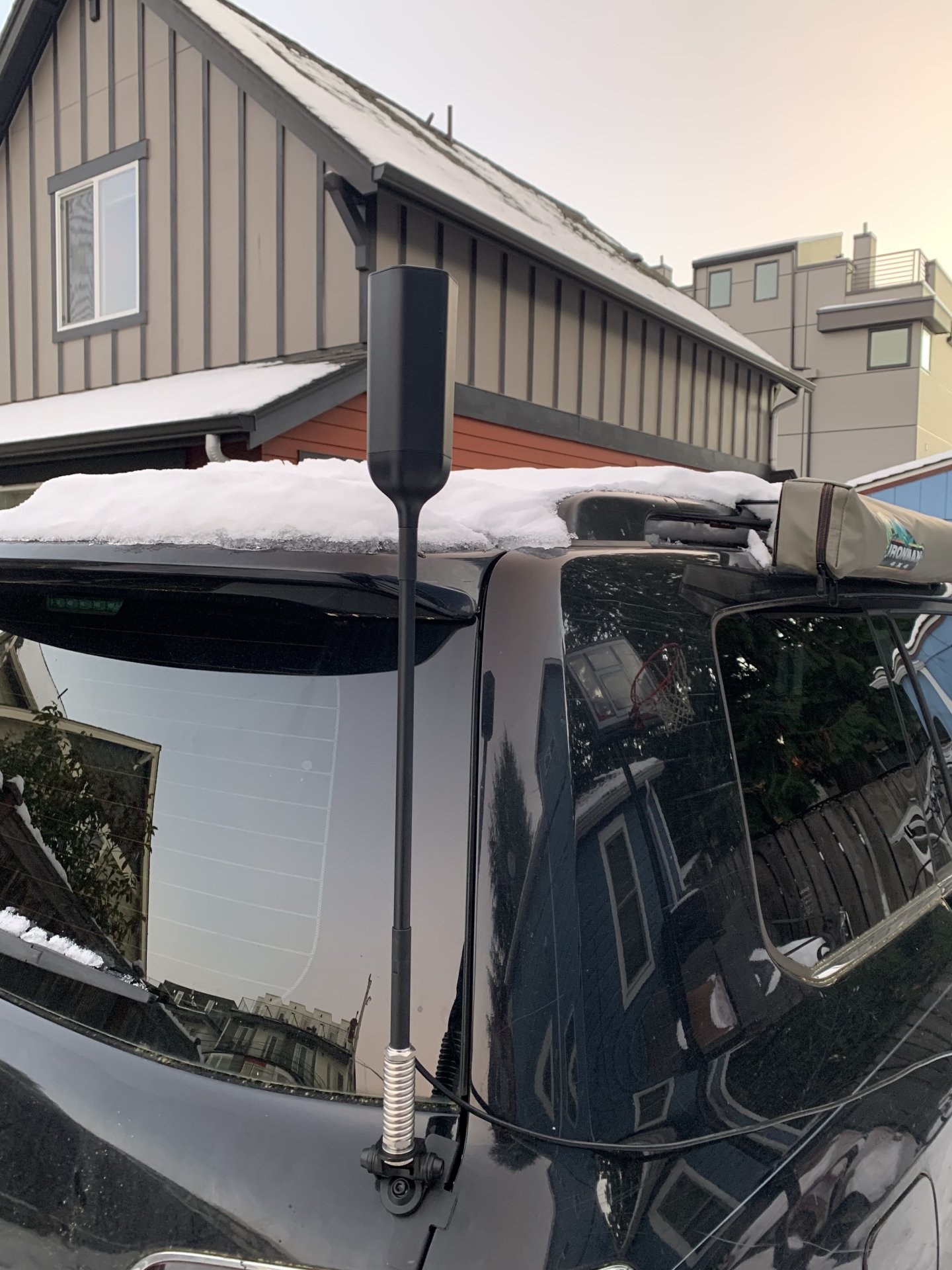

I have an otr. Hard wired to the cig circuit. Unit under right seat. Antenna on hatch mount. Inside antenna in the ashtray.
Spoiled by always having a good signal now in the rig.

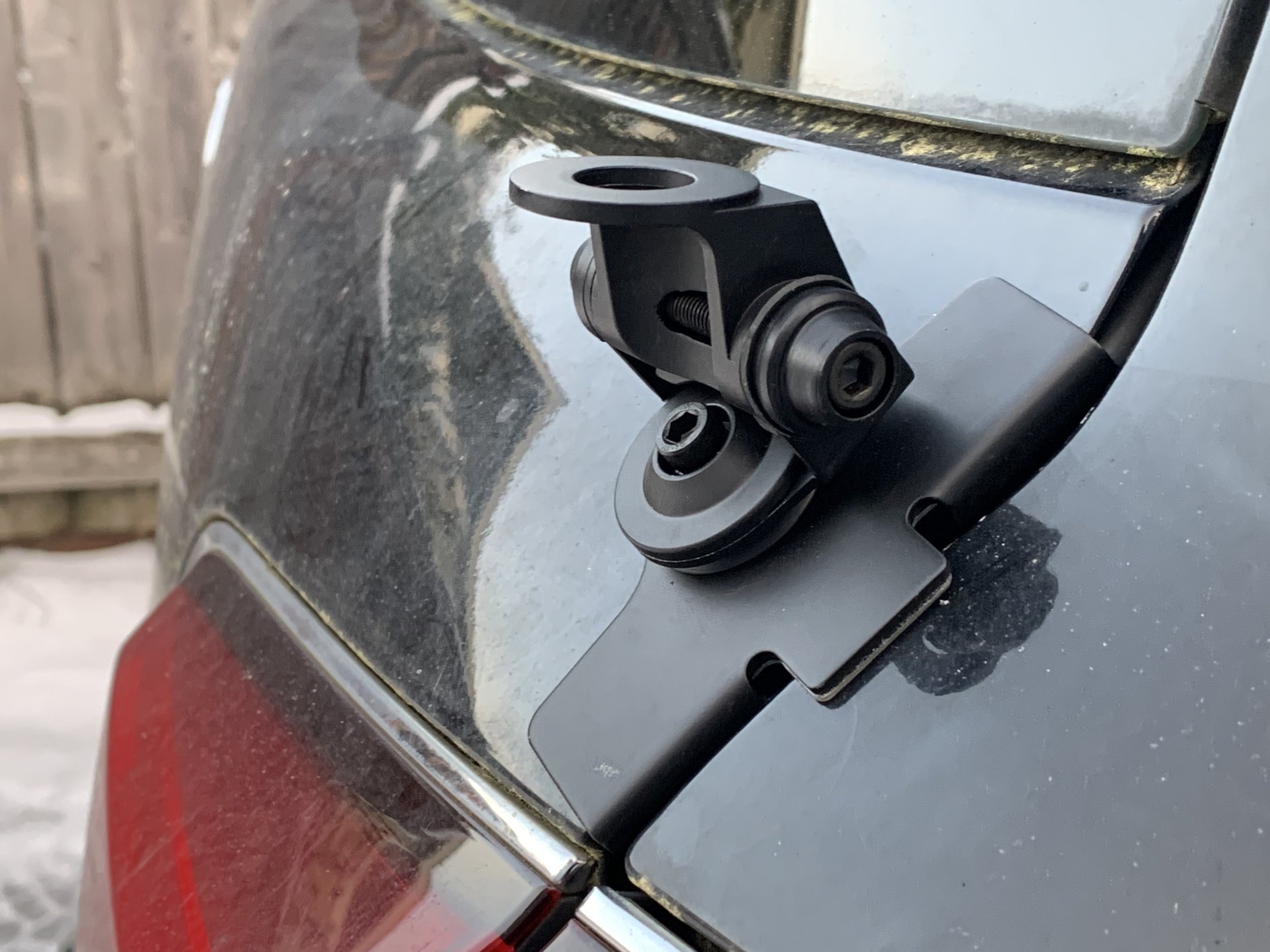

With that hatch mount location, how did you run the wire into the truck? The pic shows the wire on the outside of the truck but I assume that was temporary.

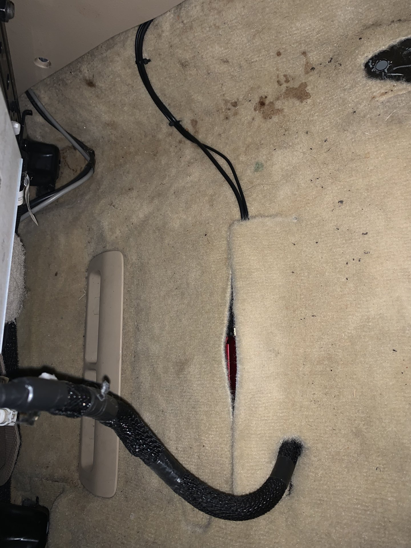

Up to the hatch hinge, down to the bottom of the lift gate along the outside of the gasket, then drip loop and OVER the gasket. Ideally one would go thru the rear grommet behind the tire in the quarter, but I wasn’t into taking my quarters off in the cold. I’ll fix it eventually. I did need a 1 meter extension to get the outside antenna wire up to the seat, the junction is at the b pillar.
I found an easier way to run those wires the other day.
First I cut the end off with the rg58 connector. (mine had an rg58) This was so I could keep the hole small.
Run the wire down the gasket and under that plastic plate. (remove plate run wire replace plate)
Remove the tail gate bridge.
Drill a small hole on the top of there the tailgate bridge was covering.
Run the wire through the exiting grommet and then up through the small hole you drilled.
Gasket glue the wire hole areas.
Run the wire out the side of the bridge and tuck it under the interior panels.
Then got an rg58 connector off amazon and re-crimped the connector back on.

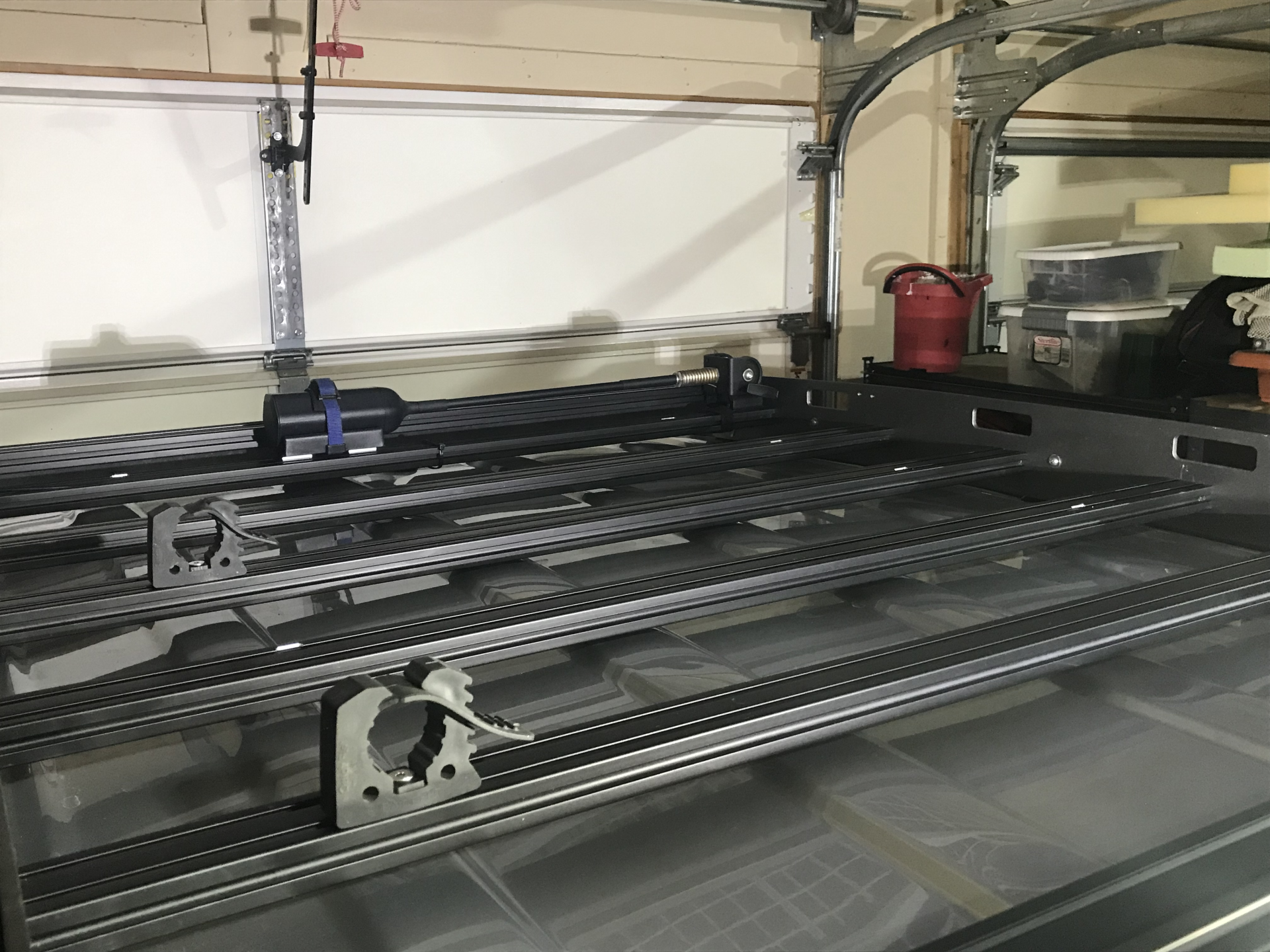

Drive Reach OTR mounted to a Rhino Rack folding mount to get in the garage. Previously had an Amazon mount but it snapped going down the highway. View attachment 2956695
@Mooterman what is the piece under the antenna w the blue velcro? I have the same setup and when folded down using the Rhino rack mount, it occasionally rattles against the cross bar. Looking to do the same as your setup.
I need to move mine there. It looks like you removed the mounting bolts and tipped the seat forward to improve access? How is it mounted?
Yeah, don’t even think I had to undo the seat cables. Pull the four bolts, put seat forward, tip it back (I think back anyhow.
It’s just floating free is the seat pan next to whatever computer is down there. Lots of room. I should probably go back and sticky Velcro it in. That would be better. If I recall the mount already has loop on it.
I did need an an outdoor cable extension to get it there, cable only made it to the b pillar. I got two meters, one would be enough.
Was taking the ashtray out anyhow to put the indoor antenna in, so used cig power (ign switched) while I was In there. The cig adapter that came with it was sacrificed for the cord.
It's a plastic insert from an old Thule bike rack tire cradle. Fits the antenna nicely. Drilled a couple of holes and T-nuted to the crossbar. I have this other one if you wanted it. Can drop it in the mail.
It's a plastic insert from an old Thule bike rack tire cradle. Fits the antenna nicely. Drilled a couple of holes and T-nuted to the crossbar. I have this other one if you wanted it. Can drop it in the mail.View attachment 2957311
